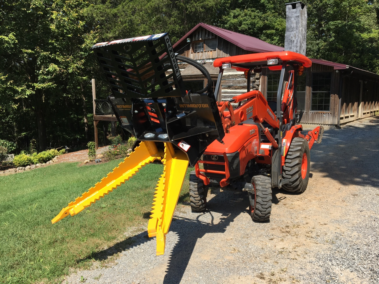

The Intimdator excels at stump and tree removal. Reaching up and tearing off head slapping limbs. Has been great for pulling out saplings and brush in tight areas with minimal ground disturbance. The smallest whippersnappers can’t hide. Clearing around fences, buildings, ditches where I can’t mow. Can pull and stack 10-20 small trees, grab pile and carry long ways down woods roads to dispose. Carrying or dragging longer and bigger stuff down narrow paths saves from cutting into sections.
Have long bottom root grapples too. 54” EA grapple is perfect for the B26. Would have to be very careful if used on M59. Have 72” skidsteer rated grapple for it. Your 70hp tractor is at least 6’ wide? Definitely understand wanting narrow for woods work. For our wooded hillside farm the grapples are in constant use. Springtime tree pulling season is now.

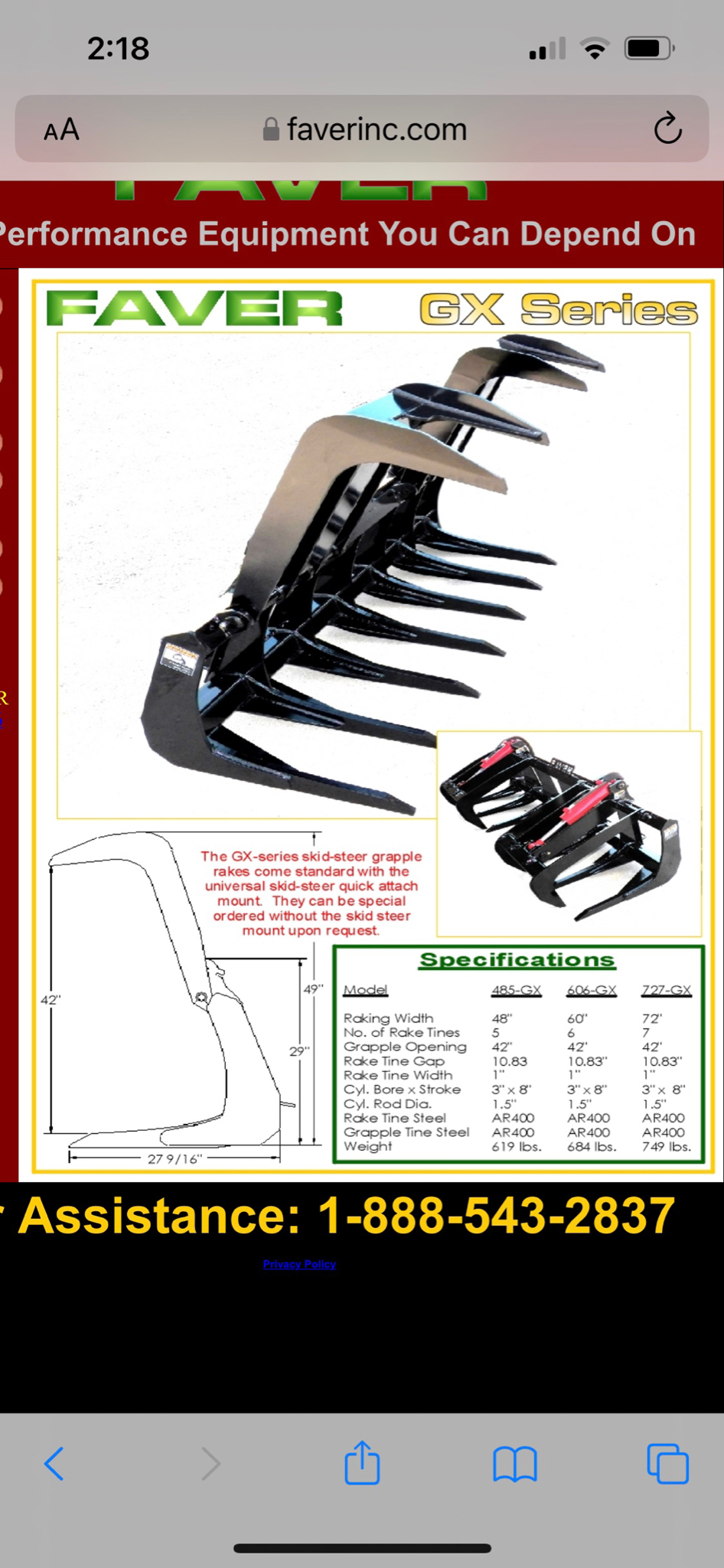

[FONT=arial]Hwelbergen[/FONT], I think you would want your grapple at least as wide as your loader frame. Yes No. The Faver GX looks like it does not have any protection for the lid hydraulic cylinders. I added support to my lid protection plates/ hydraulic cylinder protectors/ because they used such thin material over a wide span.

With a 70hp machine I would be looking more towards a skid steer attachment. How ever alot of these thinner grapples are built for 20hp machines and cost alot due to the weight and steel type.
/ Advice needed regarding Grapple #15
The Land Pride SGC series is designated as a heavy duty skid steer implement. Constructed of 800# of AR400 steel. I very seldom lift a load more than 6" off the ground - knuckle dragging. So.. at lower lift heights it has substantial capacity. If you are concerned about lift capacities - check out the load lift charts in the Owners Manuals before you purchase a unit.

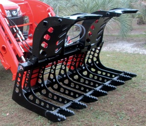

I have a wicked root grapple. Looks like this one with long teeth which might suit what you are trying to do.
It has held up really well. Not abused but definitely very well used. I like the longer tines to scrap below grade raking up roots, etc... then a curl shake and most of the dirt simply falls through the bottom tines. I wouldn't use it to dig up "stumps" though as torque on loader arms could do damage pretty quick I think. A straight push with middle of grapple into christmas tree trunks should not be a problem.
1/2 the bottom tines are removable which might suit your plans of rooting up small stumps but wanting to leave behind as much dirt and small stuff as possible.
My biggest surprise is how well the black paint shows only minor wear? not sure what these guys use but definitely not tremclad (haha)

I have the same unit and it's held up well for me too.
My Branson's loader has slightly higher lift capacity and breakout force than the OP's Workmaster (as listed on tractordata anyhow). I do not think the grapple would do well to dig christmas tree stumps out. It takes a lot of force to pull a stump out of the ground, even in my land's loose sandy soil. While this grapple works well for logs and for brush it's not all that good at digging. It's wide so you'd need to force all the tines into the ground. It seems like a narrower implement would do better.
