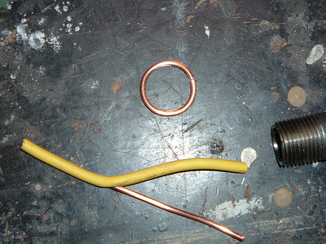

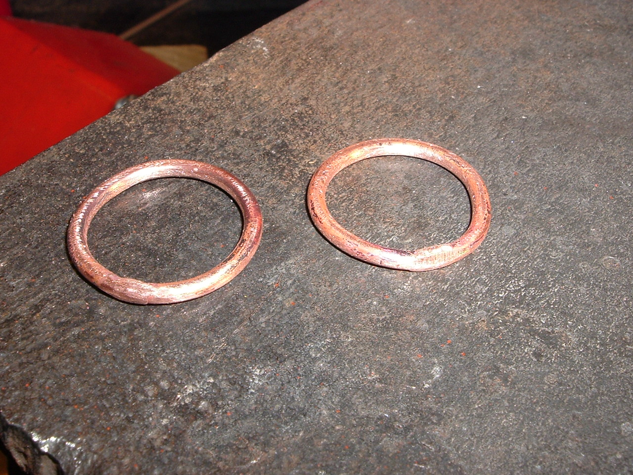

The first man that can weld up some copper crush washers out of some No. 10 copper wire with his 230 amp AC stick welder gets my undying admiration. :D Or for that matter can do any of the projects I featured in the above post. :)

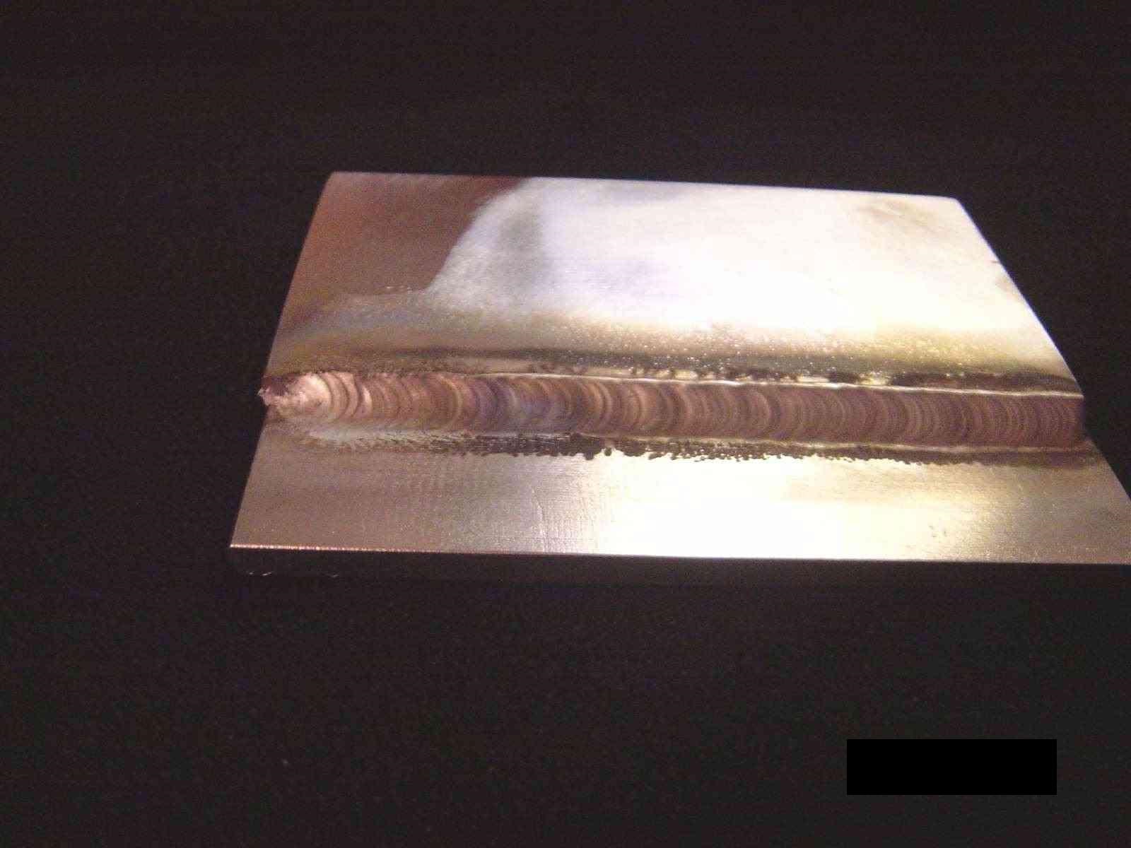

Welding aluminum without a foot pedal or hand control, is a real PITA!
I made this aluminum Tig weld with my Tig rig, no way to control the heat. See how the weld started out cold, and by the time I stopped it was all most too hot to control the puddle.

I welded those washers up with a scratch start DC only stick machine. My Everlast PA160. With a 17V tig torch from ebay and a $26 regulator and a bottle of argon. I used some 24 gauge copper telephone wire I stripped and twisted two pieces together for filler. No HF start anywhere in sight. I am sorry to say.
