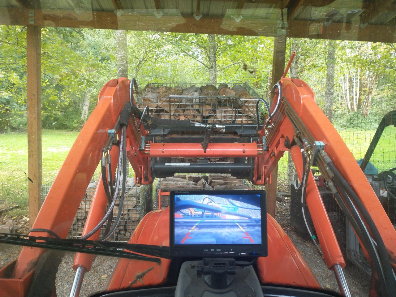

Keep in mind travel conditions when carrying heavy loads. Turns and dips introduce some tricky dynamics.
You really have to have pretty level surfaces to work from when picking up loads. And sometimes when setting loads down (I stack the two back rows three high- front might do four but I only need enough crates for the current heating season):
Surface I'm working from is NOT level, though it's close enough. Crates have feet that have to rest on top edges of crate below. I sometimes have to push the crates on the pallet forks a bit (by hand) to help align things (and most of the time I have to shift the tractor approach around). Maybe about 1,000 lbs each: 1/3 cord of dry Big Leaf Maple. NOTE: my rear camera is dangling- haven't gotten around to reattaching!
