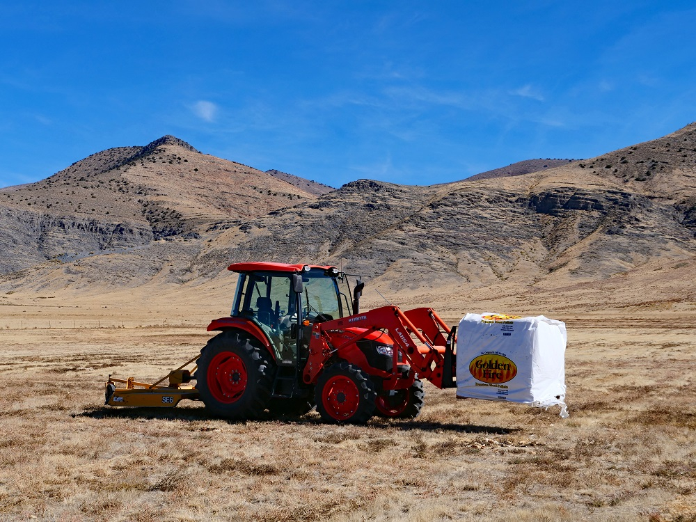

A pallet of pellets is 2000 lbs (50 each 40 lb bags), plus as stated above you have to figure in the weight of the pallet and the pallet forks.
The loader on my Kubota M7060HDC, if I remember correctly, is rated to lift ~ 2300 lbs. To lift these pallets off my trailer I have to make sure the front tires are aired up to 30 psi - else the tires squish down nearly to the rims. Also, I have to have my 6' rotary mower on the back of the tractor. If I don't, all I do is lift the rear of the tractor off the ground (there is no ballast in the rear tires). Even so, maneuvering around with that load on the forks has to be done slowly and carefully.

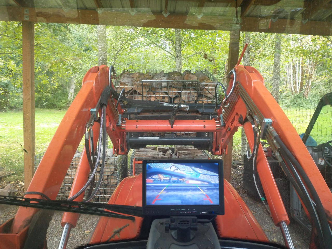

Keep in mind travel conditions when carrying heavy loads. Turns and dips introduce some tricky dynamics.
You really have to have pretty level surfaces to work from when picking up loads. And sometimes when setting loads down (I stack the two back rows three high- front might do four but I only need enough crates for the current heating season):
Surface I'm working from is NOT level, though it's close enough. Crates have feet that have to rest on top edges of crate below. I sometimes have to push the crates on the pallet forks a bit (by hand) to help align things (and most of the time I have to shift the tractor approach around). Maybe about 1,000 lbs each: 1/3 cord of dry Big Leaf Maple. NOTE: my rear camera is dangling- haven't gotten around to reattaching!
