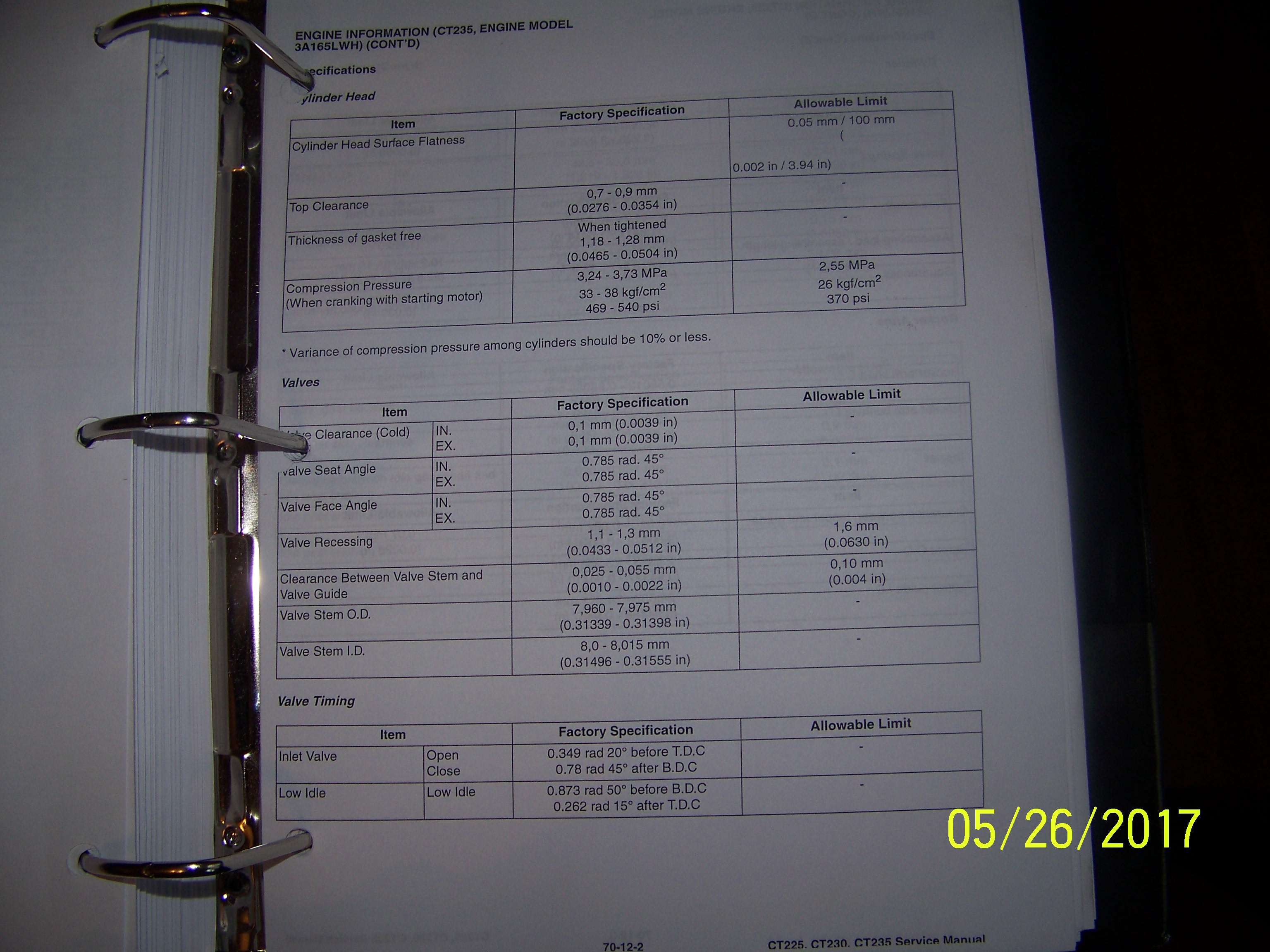

Just stumbled onto this Kioti page. Now wanting to question again what is right. C:\Users\mabe1945\AppData\Local\Temp\Valve adjustment.pdf

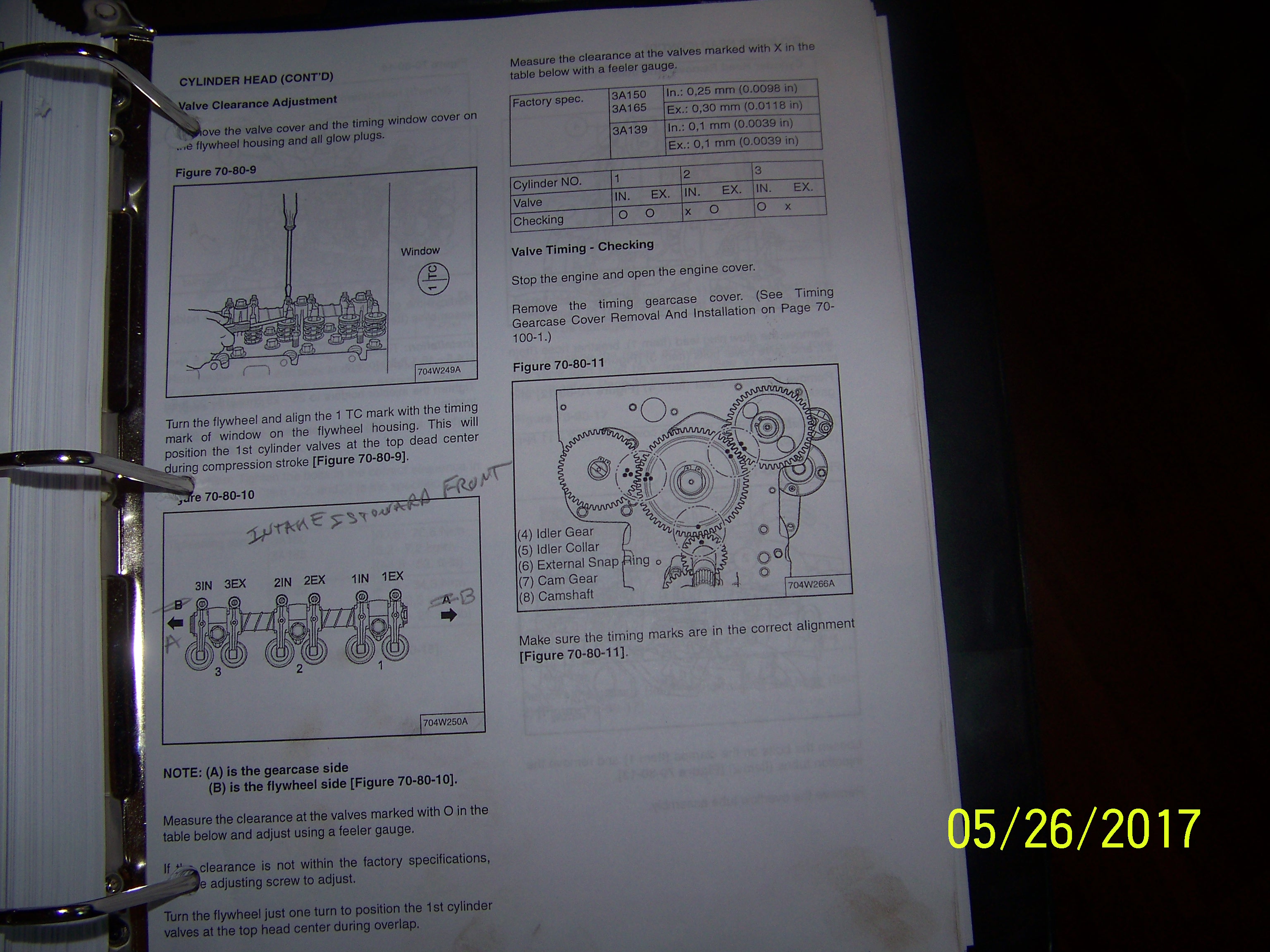

Can't get the above to pick up but if you google "3A165 valve lash" it will the the first thing picked up. Pretty confident it is right out of a Koti manual. For what it's worth you will notice the picture shows A as the gearcase side. That is not correct. That is the flywheel side. Same mistake in the Bobcat manual. Only difference is the Bobcat manual does use both terms. (flywheel and gearcase)
I know you guys are getting tired of my ranting. Senility has pretty much hampered me but once again I have stumbled onto something that has been right in front of me all the while. I will attach the adjustment page and you will note right up in the right hand corner it shows the 3A165 at .0098 and .0118". Not what it shows over in the spec pages also attached. Bobcat, Kioti, Deadong should all be ashamed. :thumbdown:

Make a new post to reveal my conversations with Bobcat and Kioti. Bobcat first informed me they didn't really service these tractors anymore. However he did do some looking and recommended I go with the .010 and .012. Kioti mechanic said he always went with what was on the rocker arm cover as manuals has shown to be wrong. I liked his response and I am on my way out to redo. :(
Completed, didn't take long, I've about got it down by now. :)

I looked at your 1st photo, and Bobcat is using the same figure that my paper Kioti manual shows,
but only the "A" and not the "B" arrows. It does not say what the letters mean. My manual is
dated DEC/2004 and the figure is designated "704W250A" as is yours.
I do not know what the TD1300 engine is, tho I suspect it is for the CK25 and is only 1.3 liters.
