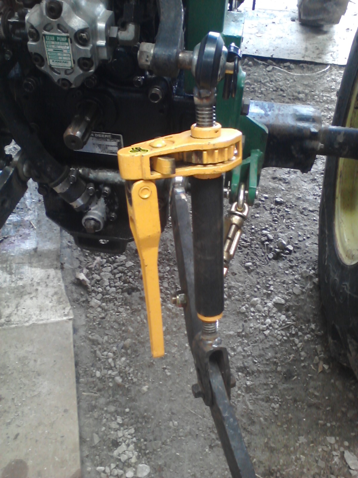

The three point hitch on my 955 has solid (non-adjustable) lifting links on both sides. I'm wanting to build an adjustable link for one the sides.
I've come up with stuff and method to make an adjustable link with 4" of adjustment... is that enough? Should the amount of adjustment be centered (2" up, 2" down) or should it be biased one way or the other?
/ Adjustable lifting link for Cat 1 TPH #2
I would bias at least 3" down, since you will most likely be leveling or tilting a Back Blade or Box Blade. You will have an inch of up for leveling and the rest avaliable for tilting down.

I agree, I find it much easier for me to turn around and look over my right shoulder when ditching with a rear blade and most other chores too. So when I set my top n tilt up I use the adjustable manual arm to allow for more drop to the right side of the tractor. When I raise the right side up with the hydraulic tilt fully it is level. If needed I can adjust the manual linkage to fine tune this. This gives me the maximum angle for the blade to tilt when cutting a ditch on the right side of the tractor.

Based on some of the comments and info in this thread, I have a new plan. If my preliminary math checks out, I should be able to get about 6.5" of adjustment...... about 1" up and 5.5" down.

I want to use a new ball on the end of the adjustable lift link I'm building, but I can't find replacements. Cat. 1 weld-on lift arm balls are easy to find, but they have a 7/8" hole. The pins on the rockshaft arms are 3/4" and I can't seem to locate weld on balls with a 3/4" hole.
If push comes to shove, I can always replace the pins on the rockshaft arms with 7/8" pins and use the weld-on lift arm balls.

Cat 0 lift arm balls are 5/8" bore. These balls are in between Cat 0 and Cat 1

Well, I finally got around to building my adjustable side link. I used a racheting load binder with a foldable handle. Cut the eyes and hooks off and welded one end to the yoke for the lift arm and welded the other end to a ball joint. I have about 1" of up adjustment and about 6" of down adjustment.
