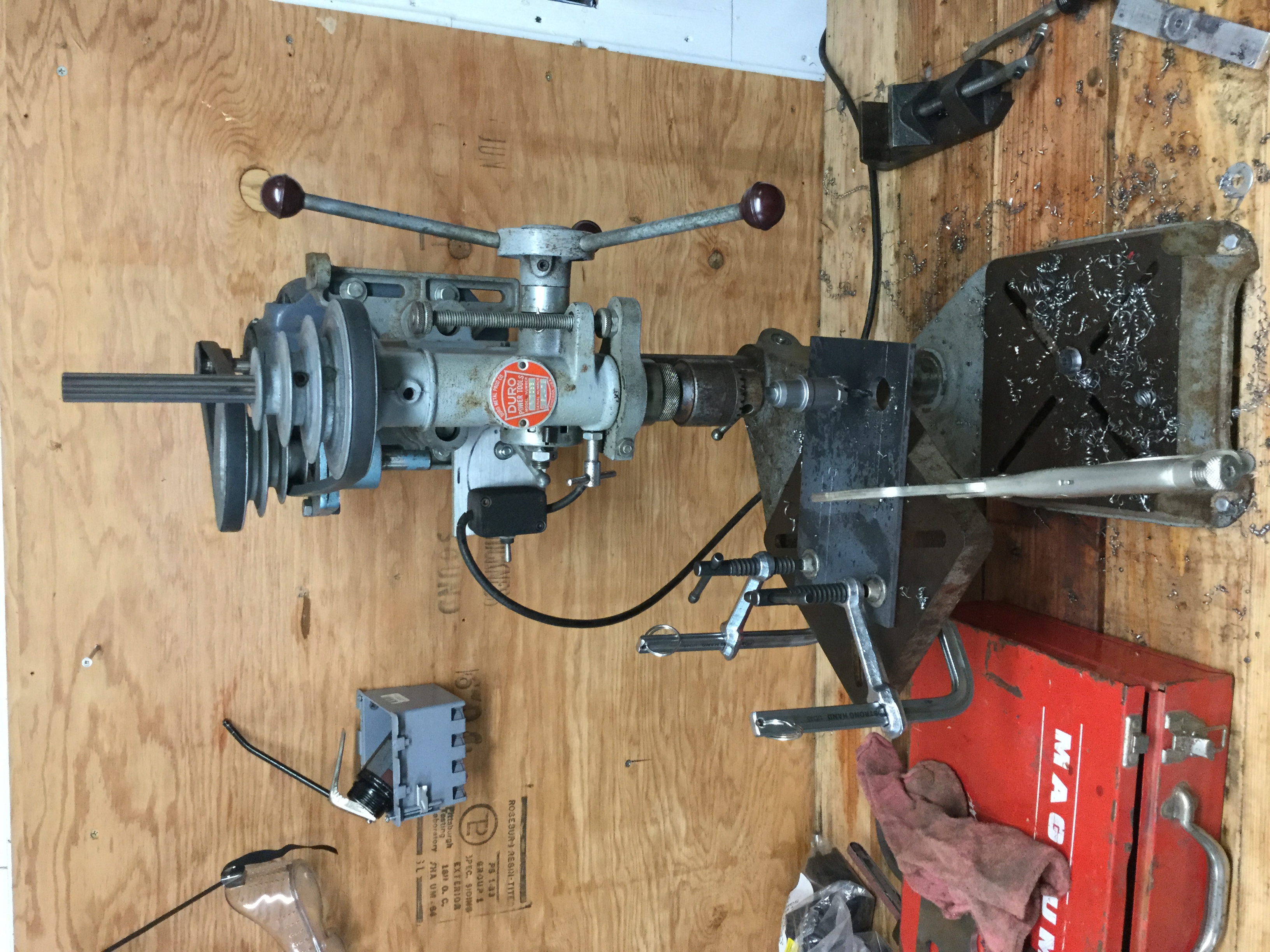

I got this 1950's era Duro from Craigslist. It was not working. What caught my eye is that someone added an intermediate pulley that slows the 1725 rpm motor speed down to 130rpm at the spindle. It has a 1/3 hp motor. It will drill 1/2" in mild steel with a twist drill and 1" with a hole saw. I wouldn't necessarily recommend this solution, but it works for me, and illustrates the point that low rpm is the main factor for drilling mild steel. Rather than big or expensive.
