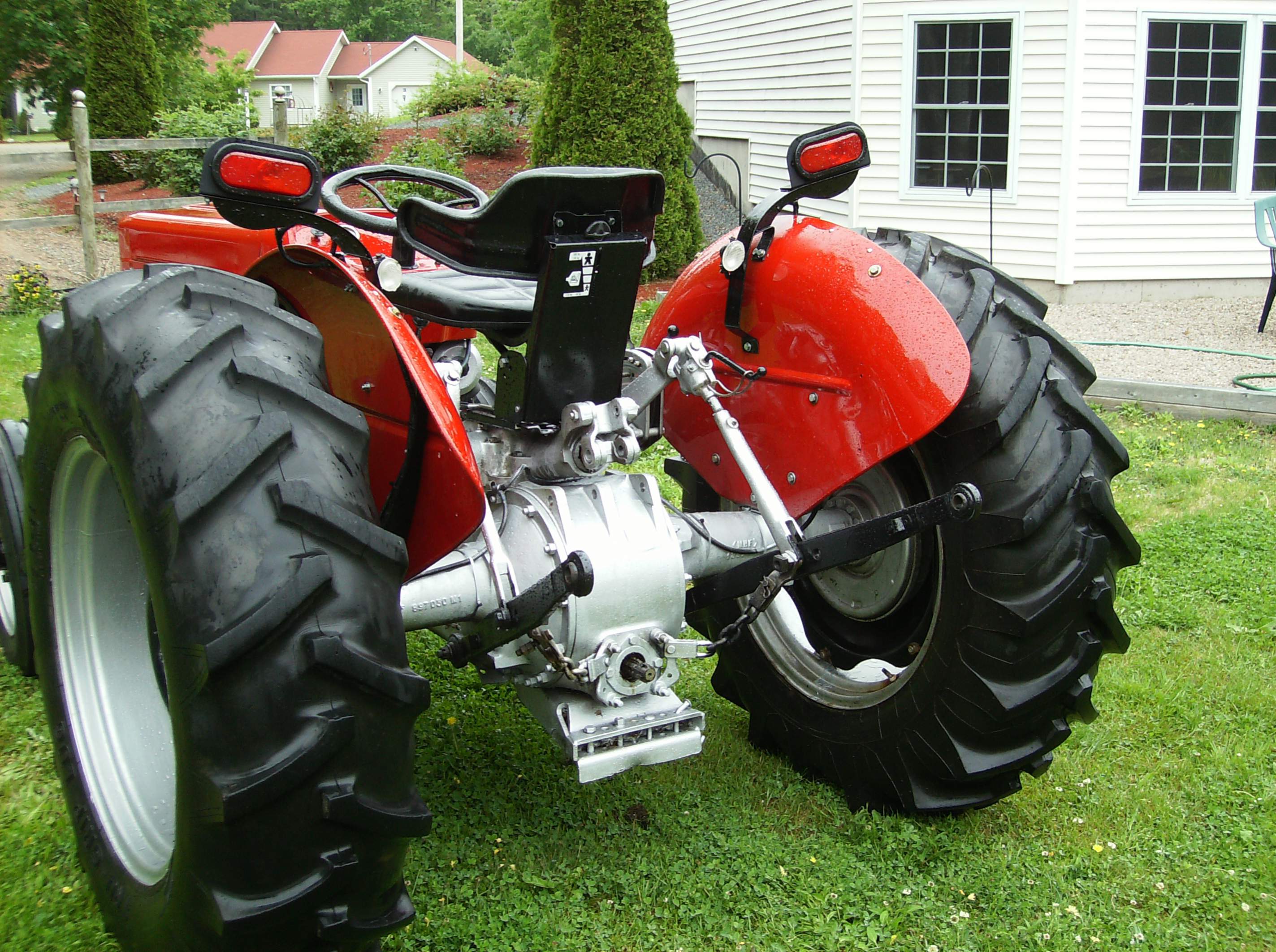

The old stock rear light was OK but it didn't shed enough behind the tractor in winter months while blading snow. I also wanted to get some rear lights that I could put a flasher on, our road joins a secondary highway and the tractor wasn't well lit up when approaching it from the rear.
I did install a flasher for the LED tail lights, the two small LED fog lamps draw little current and do a surprisingly good job, although not much past 20-25 feet behind the tractor.
