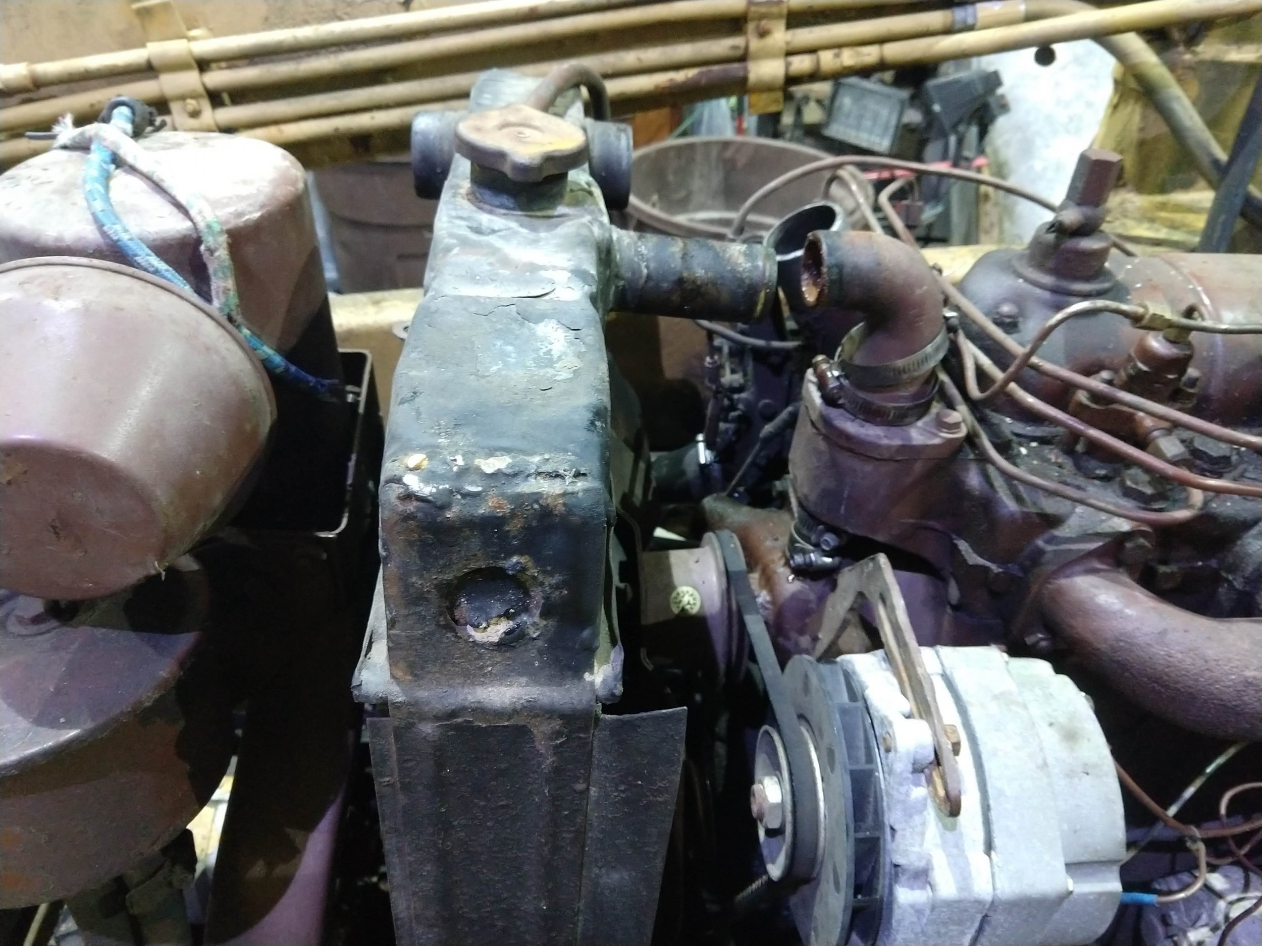

A couple of pictures of how the front pump was setup on a David Brown that I had for a while.
The shiny bolts at the bottom of the radiator in this picture are where the driveshaft was bolted to the crank pulley:
Overall view of the pump in place:
The misalignment coupling on the pump:
Thought I had one of the pump driveshaft, but I dont see it.
IIRC the flange that bolted to the crank pulley looked sort of like this: McMaster-Carr
Aaron Z
Am I seeing those photos correctly? It looks like the air cleaner is plumbed to run through the radiator!
/ Adding power steering and power beyond question. #22
You are indeed, both the air intake and the drive shaft for the front hydraulic pump run through the radiator.
They each have their own pass through pipe that they run in.
Here's another picture of the top of the radiator showing that:

A radiator with a pass through at the bottom for a shaft to drive a hydraulic pump was fairly common in that era.
I don't know how common a pass-through for the air going to the intake of the engine was.

Scotty, I know it looks strange but I think that it serves a purpose and the only down-side is that it makes any radiator repair/replacement more difficult/expensive. In fact probably much more expensive to replace!

Depends, if the end tanks are still good, a radiator shop can replace the core, probably for less than a new radiator.

Yes, radiator work is not difficult. Just picky. When I was a kid it was a common job that mechanics were expected to know - at least roughly how to do. Some were better than others. Judging by that tractor, his poor radiator has been used for practice by more than one beginner. But if it doesn't leak, that's really the test.
