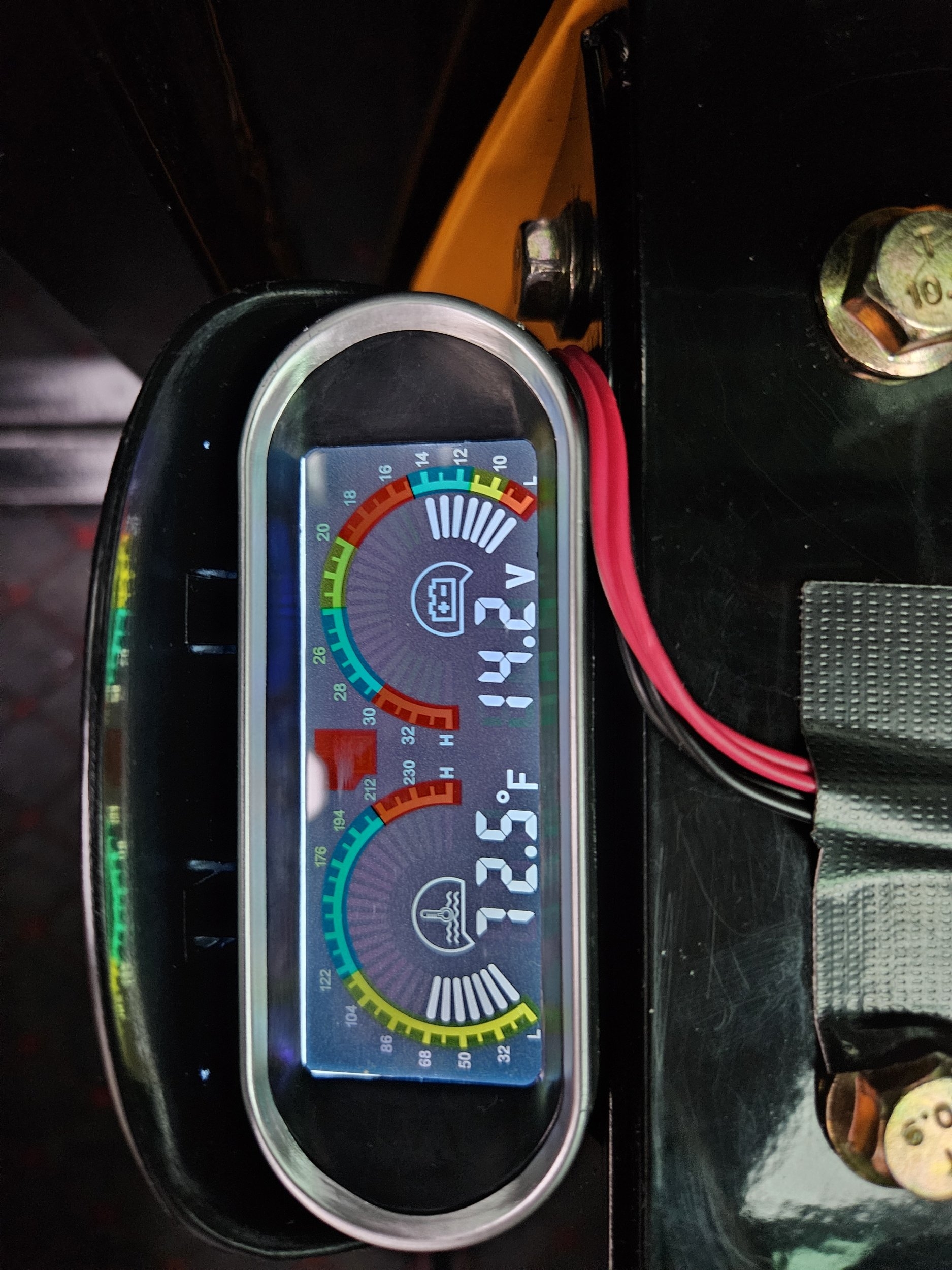

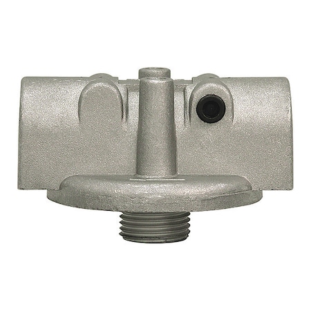

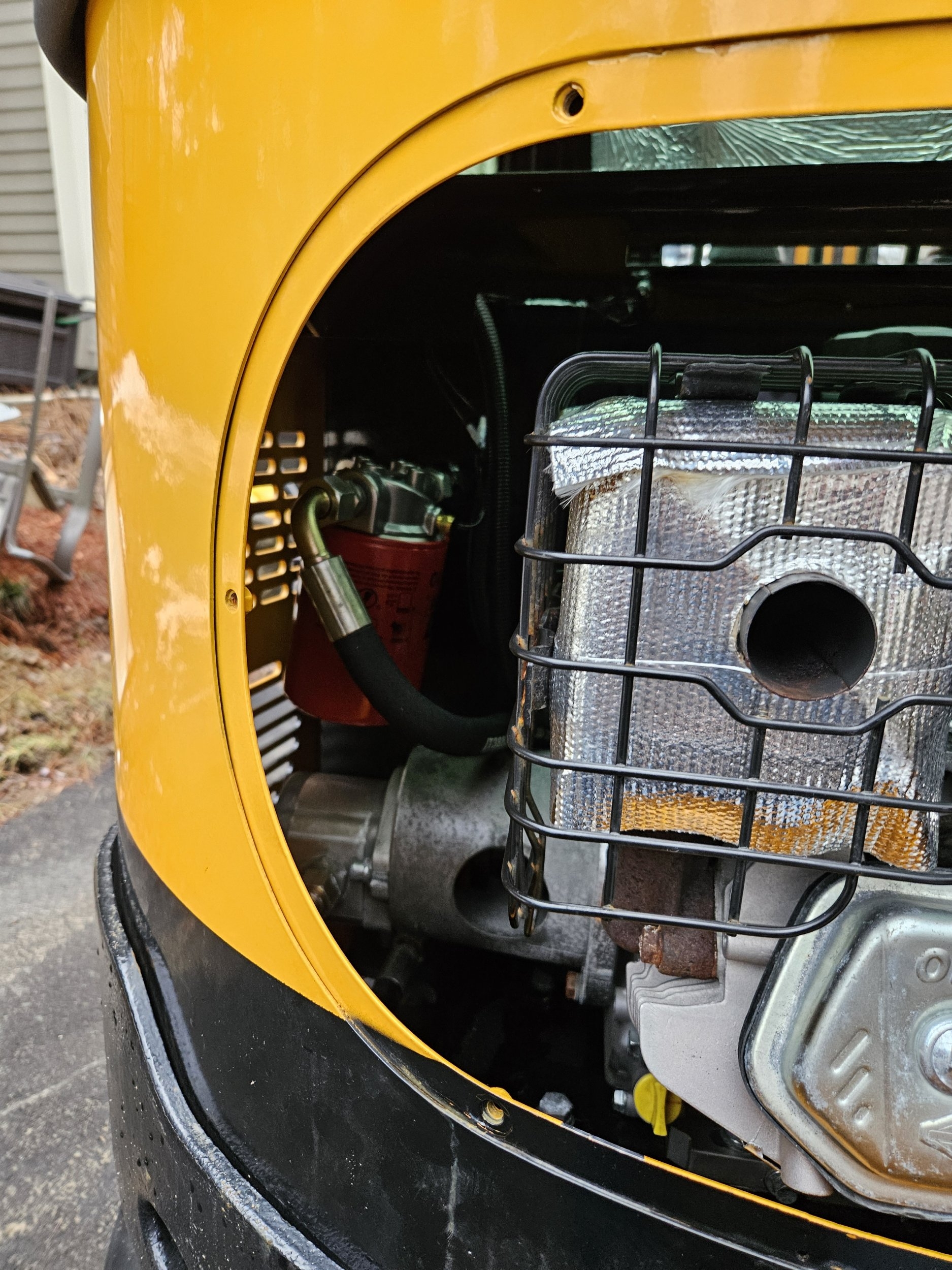

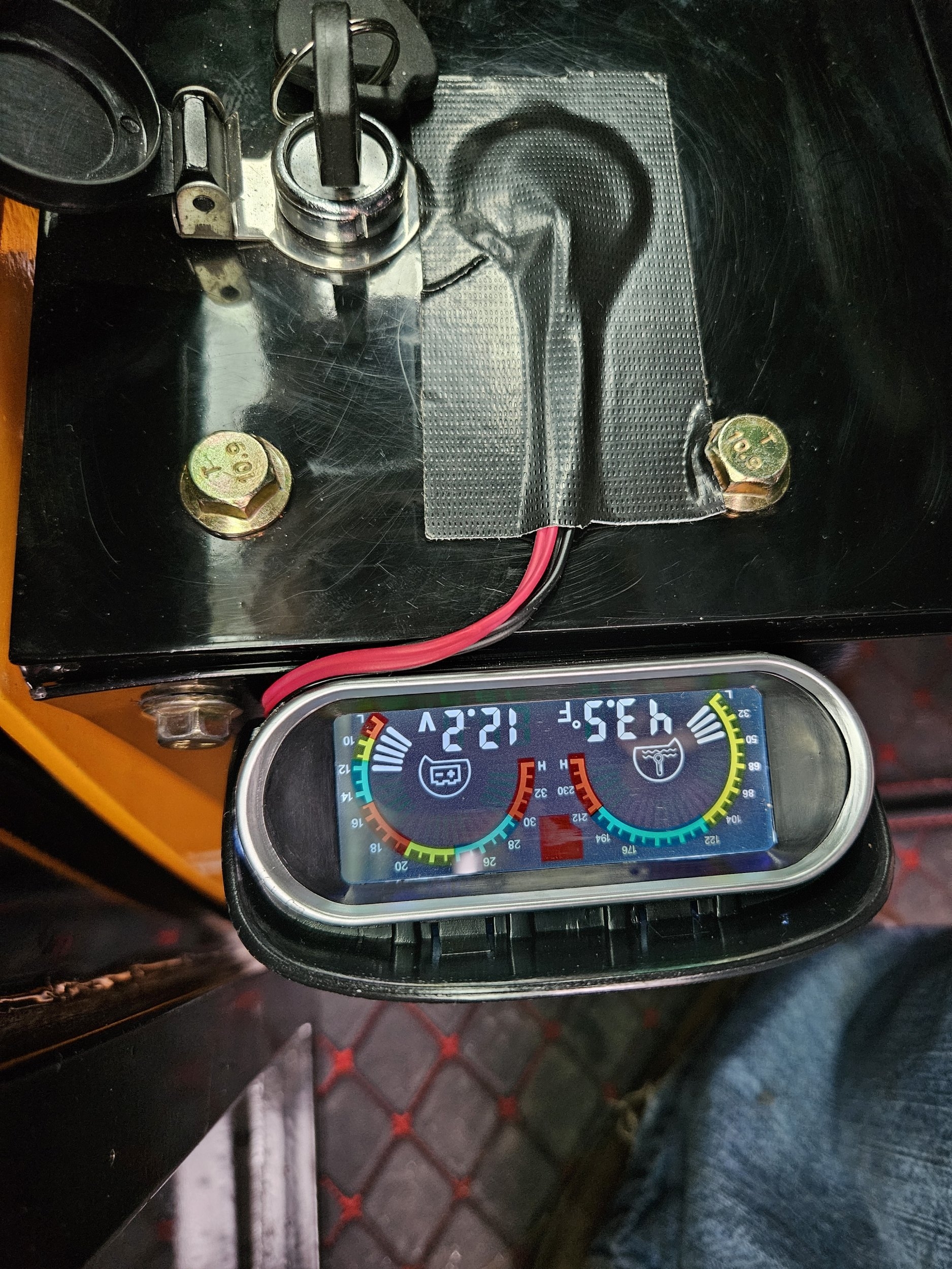

I got a chance today to get a hydraulic filter and temperature sensor plumbed into the return line on my Typhon mini-x today. I thought I'd share a couple pictures and part numbers of what I used in case anyone else has a similar machine and needs to add a filter.
I needed two fittings to go from the metric din fittings to ntp on the filter head - those are:
5307L-15-08
5007L-15-08
The filter head and filter I used are:
Buyers FH625
Baldwin BT839-10
I also added a temperature sensor into one of the ports on the filter head so I can make sure I'm not overheating the system. The pictures of the gauge are one with the machine off and the other running and warmed up a little.

Someone in a different thread asked about where I bought the parts -- the fittings were from a local hydraulic shop and the other stuff was:

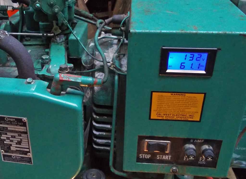

It is amazing what kind of LCD gauges you can buy these days, cheap. Your engine probably puts out plenty of current for these.
I got this LCD AC/DC voltmeter for my old Onan generator I refurbished. It was only $10-15.

I got in the remaining parts in the afternoon mail. It took me a good hour to install the filter mostly because my return hydraulic line was short. Having to get the hose pulled and stretched enough to allow the swivel nuts to tighten on either side of the filter assembly was a fight. Especially with hydraulic oil making my hands slippery and the tight working area where all this stuff is at.
Filled back up the hydraulic oil and ran it a bit to check for problems. It seems to be A-OK.
Once again my thanks to "drawthree" for providing the part numbers. I likely would have not bothered with a filter if I had to try and figure things out myself.
