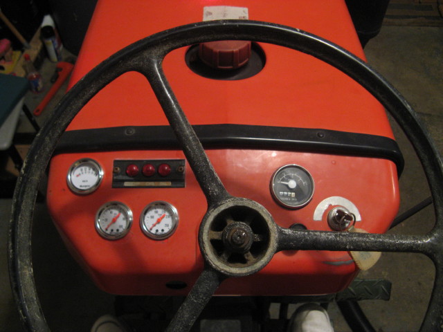

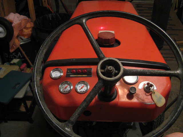

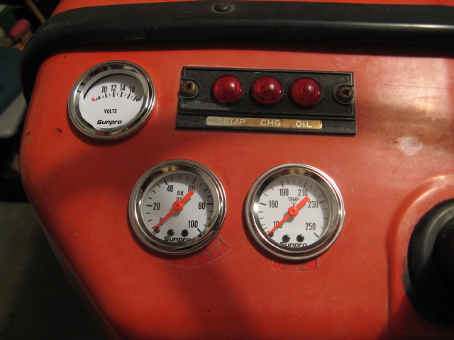

Seeing as the theme of this thread is adding gauges, I figured I would share my recent gauge additions on my 1981 YM336D
I bought the sunpro triple gauge set and a cheapie driving lights kit from walmart.
Here is the final wiring diagram:
The main +12v going to the key switch is plenty fat enough to handle all of the lights. It is 6 or 8 gauge wire. The on position connection is labelled BR2, if I recall correctly. No idea what BR2 stands for, but that was it.
I used a divider block in order to put eye connecters on each wire individually instead of tying them all together in a massive glob of twists and tape. The divider block just floats inside the dash.
At the same time as the gauges, I added new headlights, so the wiring diagram shows how I did that, as well.
As for the oil pressure and temp gauges..
The Sunpro kit comes in SAE only, but they make an adapter kit for metric (which our tractors are). I opted against the metric adapters and simply used a tap and die set to hone the threads of the temp sender to SAE threads. It was simple to do and I don't plan to return to idiot lights.. ever, so going back to metric isn't needed.
At the same time I ordered the sunpro gauges, I also ordered 10 feet of 1/8" OD (outside diameter) copper tubing. The sunpro kit is nice but it includes cheesy plastic tubing for the oil pressure line, which increases the chance of getting cut and spraying you with hot oil (as happened to a member here). The copper tubing is a pain to run, but is doable and just takes some patience.
I didn't even need to re-tap the oil pressure hole, as the threads are so close the SAE fitting screwed in without issue. I used teflon tape on both fittings as a precaution.
As a side note about the copper tubing.. you don't need a bender, just use your fingers as it is easy to bend. Don't use pliers as you run the risk of kinking it which renders it useless.
And the finished product, ready to warn me of impending doom at a moment's notice.

Domush, your gauge panel is just beautiful. You wrote a terrific how-to guide as well. Thanks for posting.

Can someone post the size metric adapter needed for the temp gauge for the sunpro gauges, is it the m14? I ordered the metric kit years ago for a John Deere and only used one adapter from the kit, I kept the rest but they are not labeled so I Dont know the sizes, also does oil gauge need the same size adapter as temp? Hoping I can use what I have. Thanks
/ Adding Guages To your Yanmar #69
From my notes the temp gauge adapter is 16mm x 1.5mm for my 1500. The oil pressure adapter was different. I think it was part of an adapter kit, so I did not note the size.
/ Adding Guages To your Yanmar #70
YM2000, so I assume YM2210, used 1/8" British Standard Pipe Thread for the oil pressure sender. Here's an overly-longwinded post I put up when I replaced my oil pressure sender. More than you ever wanted to know about oil pressure senders; information gathered as I researched what I needed.
BSP isn't as odd as it sounds. Apparently it was universal for Japanese automobiles - at least it was 30 years ago. So Autozone had several senders to choose from.
US 1/8 pipe thread is nearly identical. Half of my various US fittings would thread right in, half didn't have enough taper to catch the first thread. Later I read that BS 1/8 pipe has one more thread per inch than USP but that wasn't apparent in my experiments. I didn't have any problem getting a seal with the ones that threaded in.
In summary - the oil pressure adapter from Sunpro to generic Japanese car should be the right one. It might even be labeled Sunpro>BSP.
