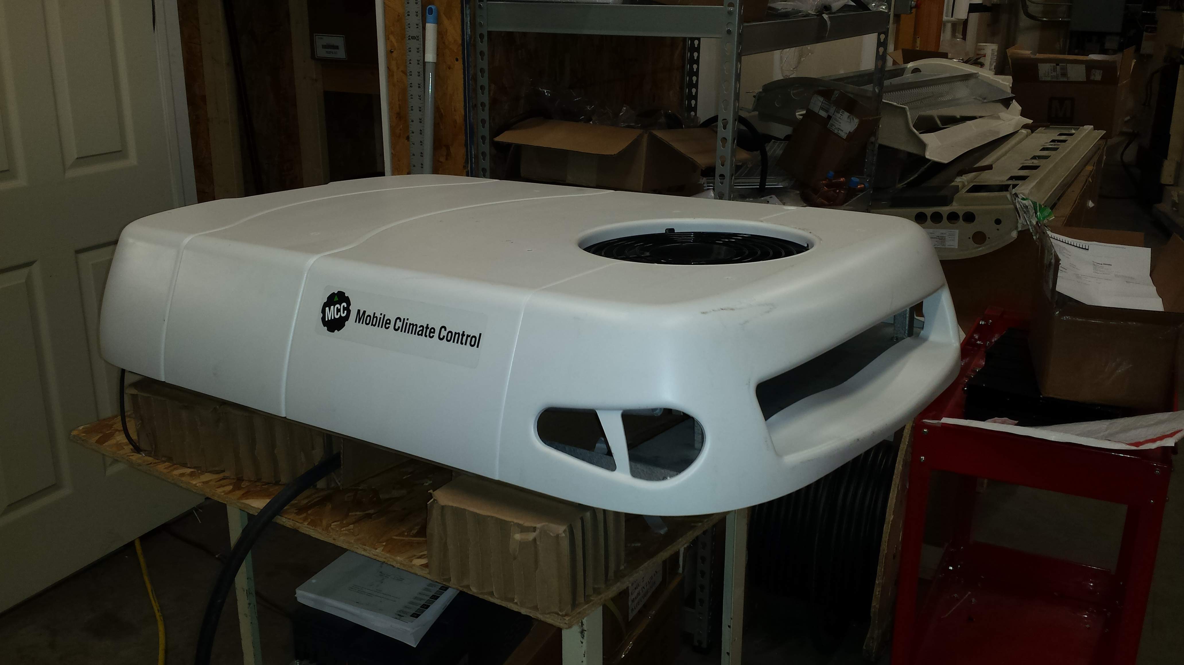

I would like to try one of these on my cab when i get tired of swapping it every spring and fall. It runs on 12v DC including the compressor, only thing is the alternator would need 50+ amps just for the A/C but it beats running any hoses and finding a way to mount an open drive compressor. weighs about 80lbs.
I have a similar rooftop AC unit on my van ... runs off a large battery bank to cool the van while the vehicle is not running and I'm in the bunk in the sleeper.
You are correct in your assessment of the power requirement (50+ amps) ... and it would likely do a fine job of cooling a tractor cab.

I wonder what they cost I don't see prices listed
   / Adding Cab and Air to Smaller Tractors #34
They may be rather pricey still ...
I haven't price-shopped lately, but when I bought mine a few years back it was over $4K ...

We don't currently sell these to the tractor market but if there was enough interest we could put some pricing together.

Yea that is a Bit pricey but I'm glad there is a option. Do you have to add a separate battery bank?

It can be a hard choice for either the factory cab, aftermarket, or build your own. I got lucky and found an aftermarket one for a Ford 4000 made by a company in Traverse City, MI cheap, and am adapting it to my 3000. It came with an RV type roof mounted heater/AC unit, 12V. The fan was locked up and needed replaced. It has a 25 Amp circuit running it. Its 5,800 BTU AC and 1200W heat with variable settings. For the small area I think it does pretty well. We found one like it at an RV store for $485 to put on my neighbors Kubota Curtis cab.
I used the 3/8" closed cell brown foam for insulation and additional noise dampening. The OP is doing a great job with his.
