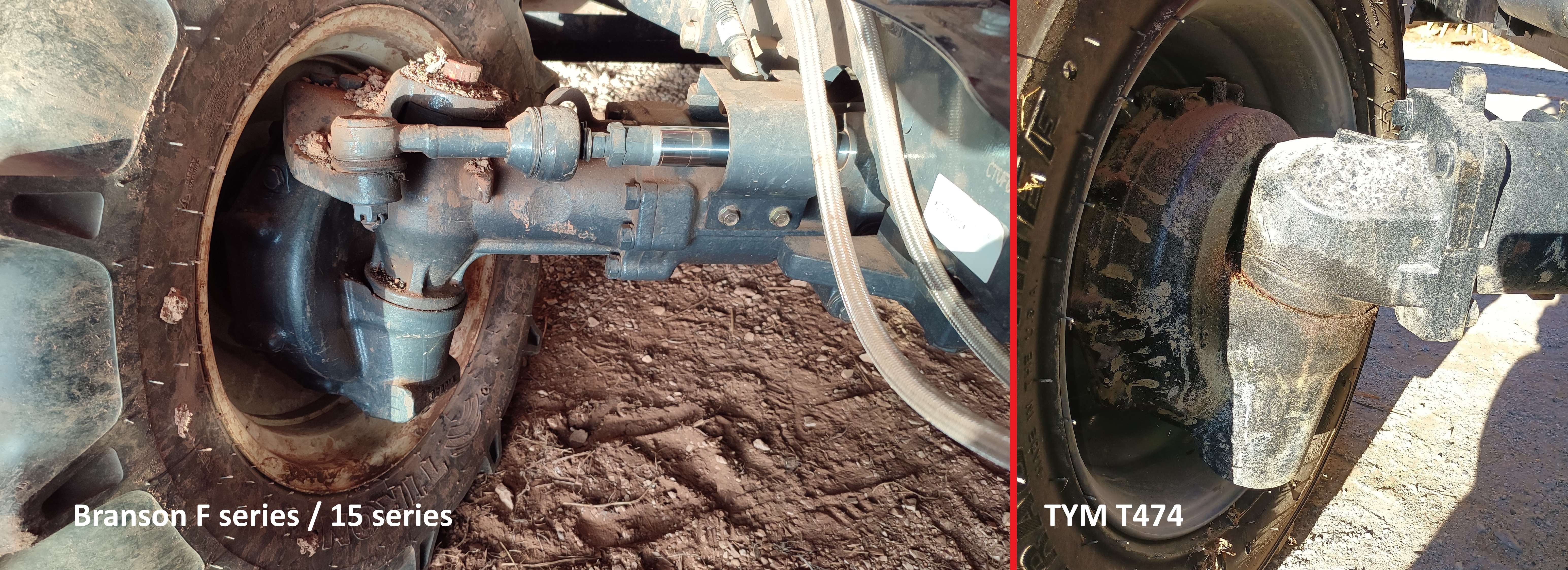

Have you inquired or considered about the 5520 instead? The 4 digit models, former Branson models, are much better built all around. Specially in the front axle as I'll show in the picture attached. The T474 and T574 have problematic front axles.
You also get a 4 range transmission version 3. Stronger and thicker castings all around. Sturdy controls. It has the same turbocharged engine as the T574.
It's not because I have own one but because I've compared them several times side by side and analyzed the workshop manuals of both brands. The former Branson models are really well built.
This picture compares the front axles on the XX15 series vs the T474. Same happens in the XX20 series vs the T574. Another one is the use of ball bearings on the rear axle while the former Branson models use tapered roller bearings as it should be on such axle.
I do agree. The construction of the axles, bearings and housings is night and day. There was a thread here detailing the design of the front axles, due to failures. The **20 series tractors are built more heavy duty in the drivetrain, and the 4 range transmission is beautiful
I also really doubt many TYM dealers know the internal differences in the tractors. They are comparing visible options and controls, not construction
