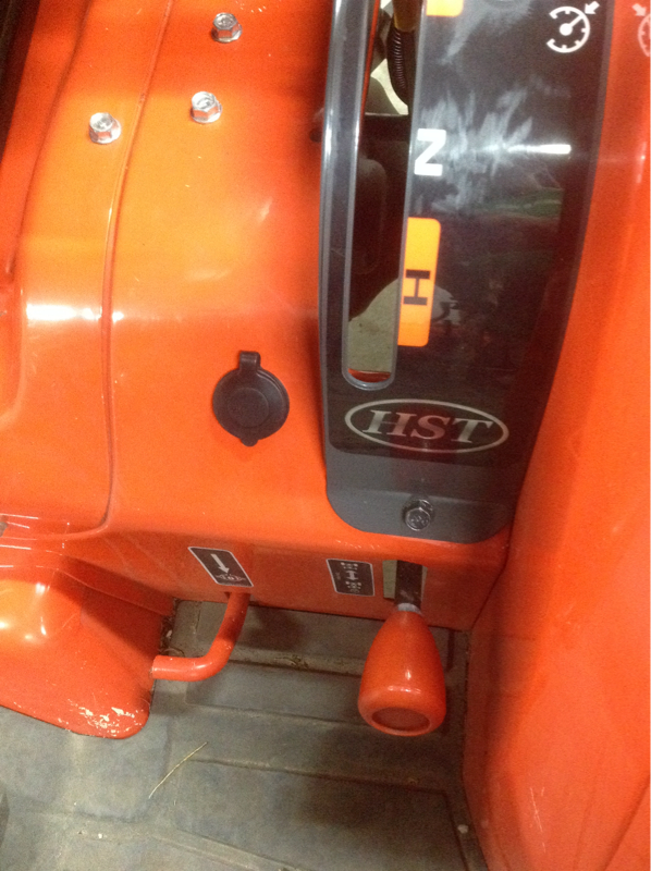

Since I'm adding addition fuses, I decided to go ahead and add a 12v power outlet. I saw how someone else on TBN used the existing hole near the seat, so I decided to try it as well and it's nearly a perfect fit. Not sure what this hole is for, but it was from the factory and came with a rubber cover over it. Just popped off the cover, inserted the outlet and tightened up the nut underneath. Will use one of the 10amp circuits on the new PowerHub once it is installed.
Now I'll be able to add a portable strobe or bring along my phone car charger.
Could have been me as I did the exact same thing three years ago :), It is the hole for the mid pto kit control if you have a Grand L40 like I do.
Norm,
I think it was you! Thanks for the great idea and for clearing up the mystery about this hole. Makes a lot of sense now that you mention it.

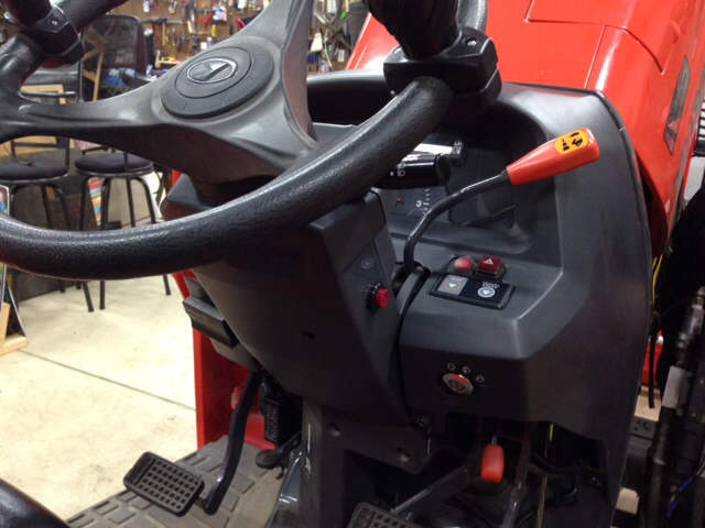

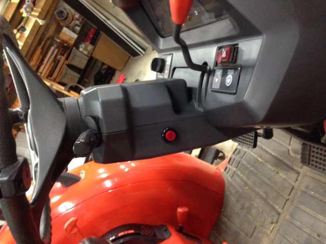

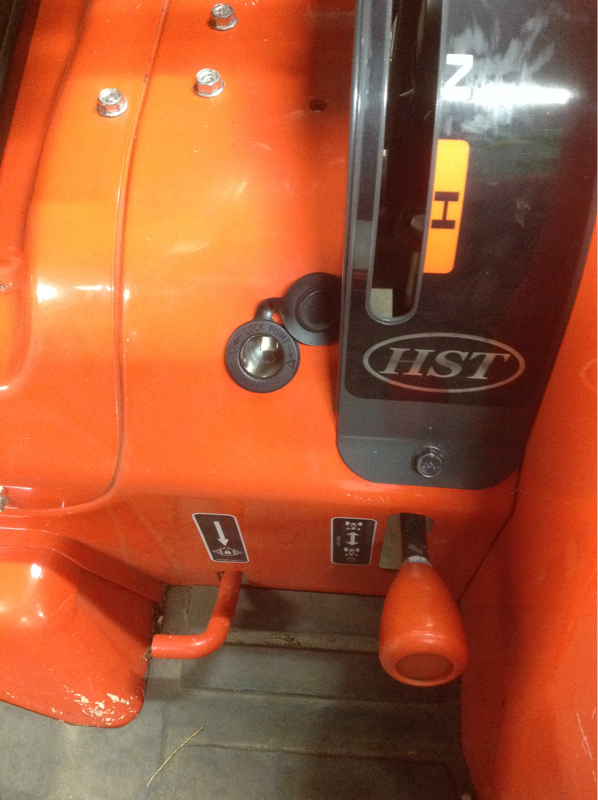

Ok, finally got all the electrical parts in and had some time to get everything wired up. Here's where I ended up putting the horn button.
I like the placement and although I doubt anyone would think this is a "factory" location for a horn button, it seems to work pretty well for me.

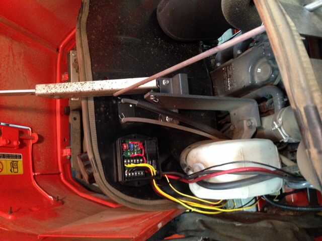

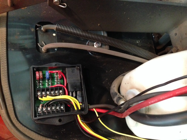

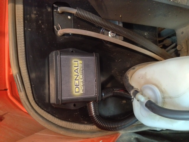

The most difficult part of this project has been deciding where to place the aux fuse box. I wanted a location that would be easily accessible, somewhat protected from the elements and have enough room for a neat and tidy wiring setup. I ended up putting it under the hood and just in front of the gas tank. Here's a few pics of the work in progress.
I'll post a few more pics when I have all the split loom on and everything secured how I want it.

Here's the final pic of how the aux fuse box ended up.
