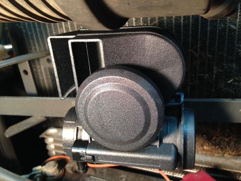

<img src="http://www.tractorbynet.com/forums/attachment.php?attachmentid=336421"/> Mount up that baby and you will be the envy of all the other TBN'ers
I started looking for a good place to mount the horn and to my surprise, there was a perfect spot just below the air cleaner. The mounting bolt even fit into the pre-threaded hole in the cross brace. I'm guessing this is a standard bracket used on cab models and they mount the standard Kubota horn there. The Strebel horn bolt just happens to be the same size.
I did a quick test on the horn sound and it is definitely LOUD! Time to run the wiring.

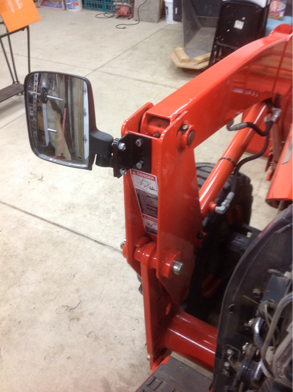

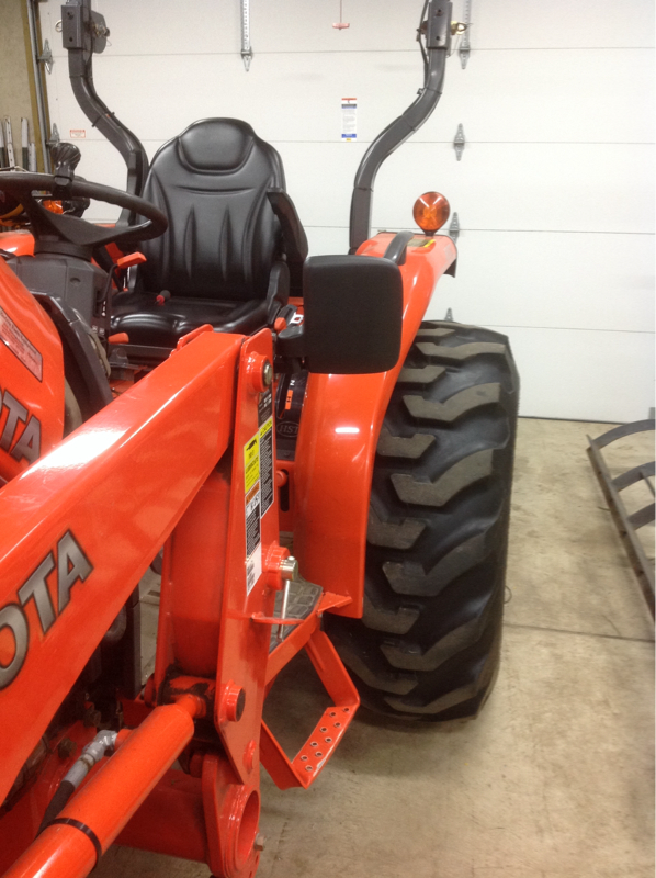

Well, I know this thread is about a horn install, but since I was waiting on some extra parts to arrive I decided to add another item to the 3540. Most of my mods have been electrical so far (except my bucket hooks), but this is one I've been wanting to do for several weeks after seeing 4shorts add them to his new BX - mirrors.
I had some 2x2 angle iron left over from my aux light mounts, so I made up a couple of brackets, drilled and tapped some holes in the FEL support arms and mounted up a pair of mirrors. Here's some pics
Hats off to 4shorts again for another inspired mod!
