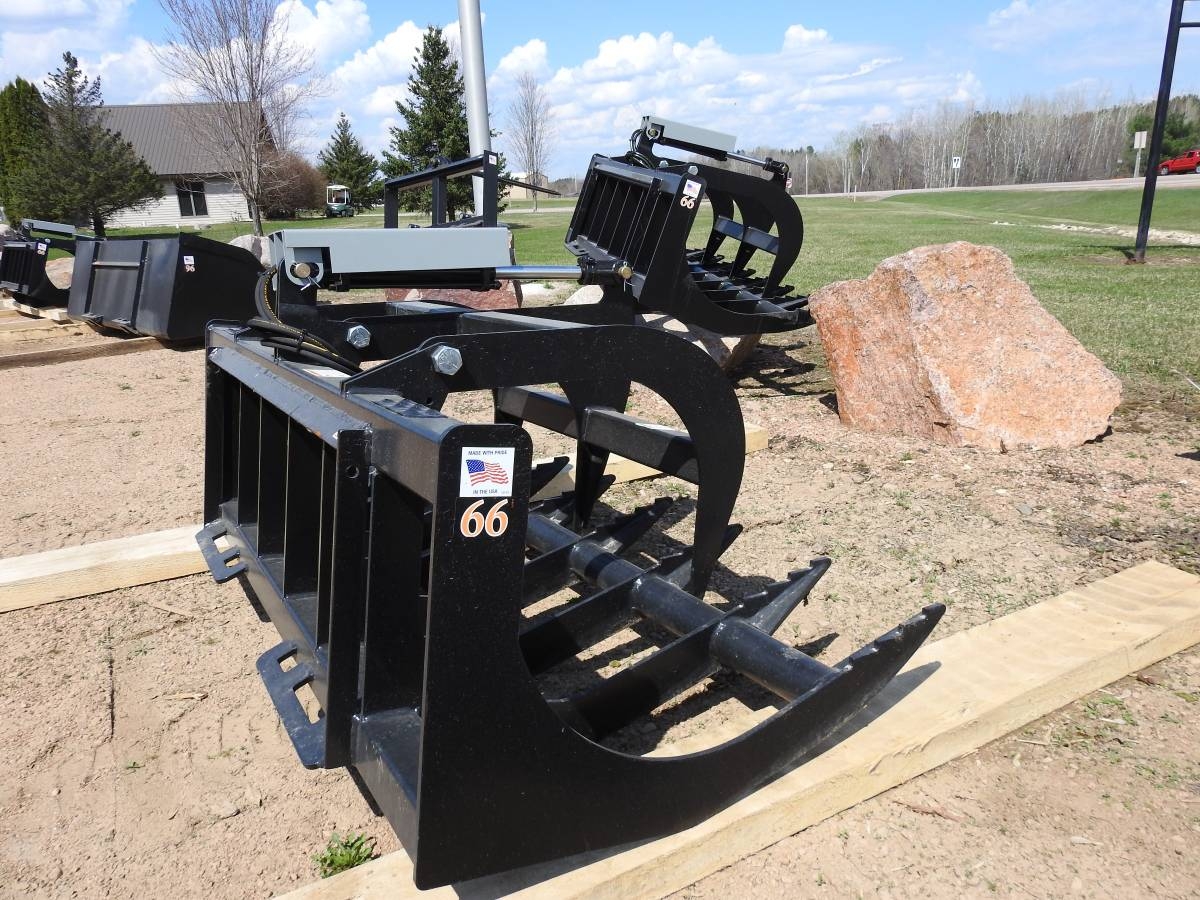

I think I am getting a 66" version of the CID seen here:
They have one of the "LS" labeled ones, it's more of a clam shell with two cylinders. better for grabbing smaller posts. I like the CID for grabbing a bunch of brush and small branches. It's also what I "know" so sticking with that.

Price of the CID grapple is $2095.
I think the 2 cylinder "clam shell" rake grapple seen here: Rake Grapple - LS Tractor USA was actually cheaper at $1895 but I had experience with the CID. I think it's better for big piles of loose brush. I was a little leery of a 2 cylinder in case I picked up something irregular and torqued it too much.

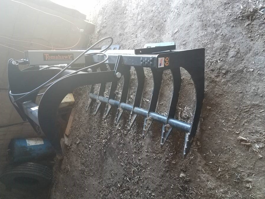

I also picked up a grapple from a guy in Marion WI. I saw his add on Craigslist. It looks like the same grapple as you are showing in the picture. My Dealer also had one on his lot for $1875. Same piece of equipment. Check out the Craigslist add under Appleton WI. Much less than the dealer price and I was able to pick it up with a trailer and about an hours drive. I also picked up a stump/ditching bucket. That stump bucket works better than my back hoe. Slices and dices!
