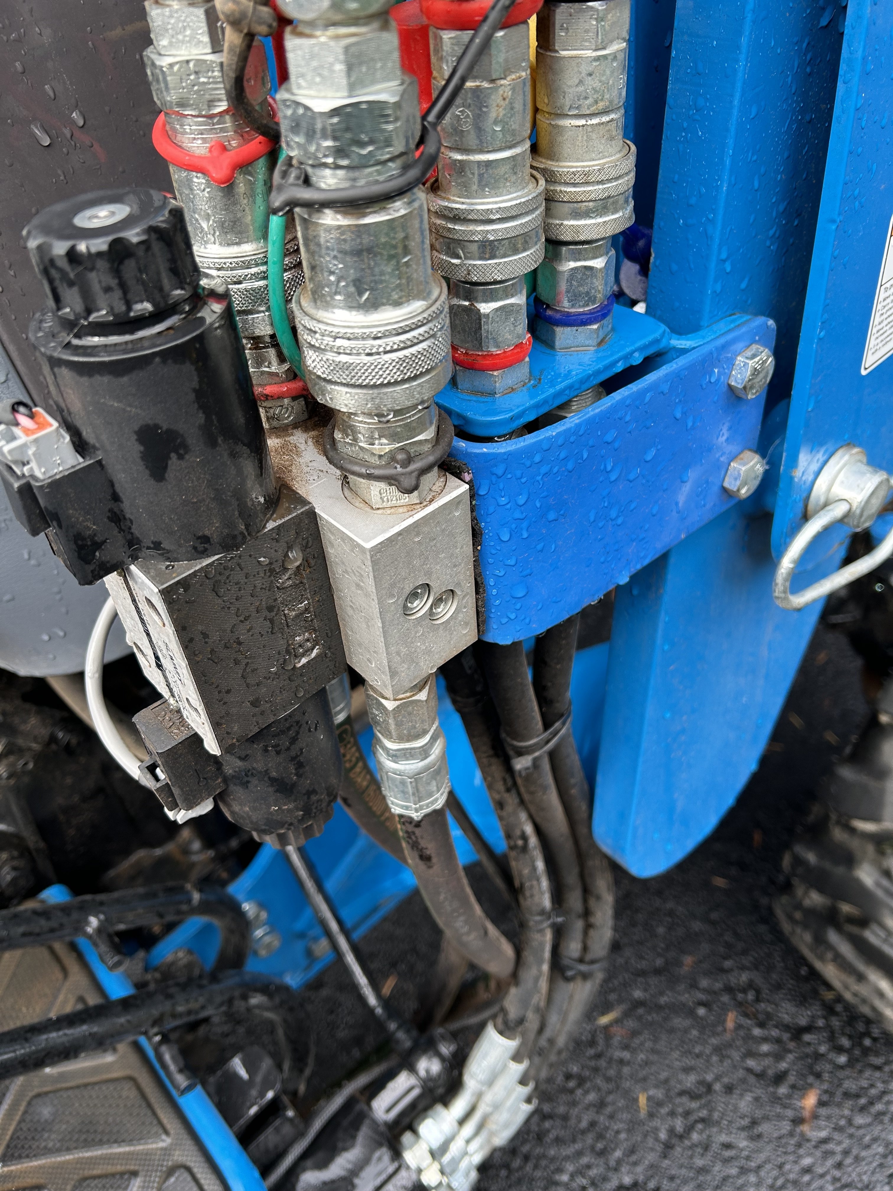

The hose length came out to 14'. The fleet farm store in WI has a 15% off sale on hoses and cylinders so I got the hoses. I had to go online to get the bulk head hydraulic fitting and paid about $75 for all the fittings. $75 for the hoses. But I have to fabricate a mounting bracket for the crossbar on the FEL and run the hoses which might be a real headache.
Where did you mount your quick connect couplings on the cross bar on your last tractor. Centered or off to the side?

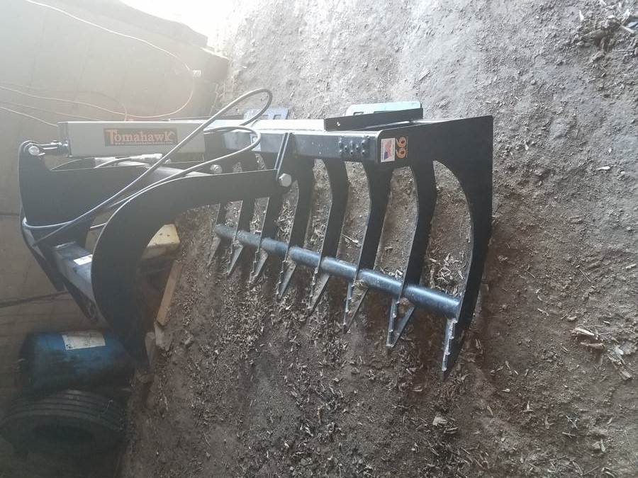

I also picked up a grapple from a guy in Marion WI. I saw his add on Craigslist. It looks like the same grapple as you are showing in the picture. My Dealer also had one on his lot for $1875. Same piece of equipment. Check out the Craigslist add under Appleton WI. Much less than the dealer price and I was able to pick it up with a trailer and about an hours drive. I also picked up a stump/ditching bucket. That stump bucket works better than my back hoe. Slices and dices!

Slow and steady wins the race. I finally got to ordering my third function and went with the WR Long one. I couldn't find my tractor in their offering, but after calling they explained it was based on your loader model, which they did have. Typically I overestimate and think I can get something done in an hour, but it takes me 6. This I put off for a while partly because I thought it would take too long, but for once it was the opposite. It probably took me an hour max. They certainly made it easy for you! I ended up ordering the Job Site root grapple i linked on the first page of this thread. I think i'm going to wish I would have bought these a long time ago. Thanks again for all the guidance!
For the electrical hookup, it comes with a 10A in-line fuse, but I see I also have a spare 10A fuse slot on the tractor. There is a red wire running to one end which i assume is a hot lead, but does anyone know what type of pin to crimp on the end of the wire to push it into the other side of the fuse holder?

I wired mine up when it's hot only when the key is turned on .
