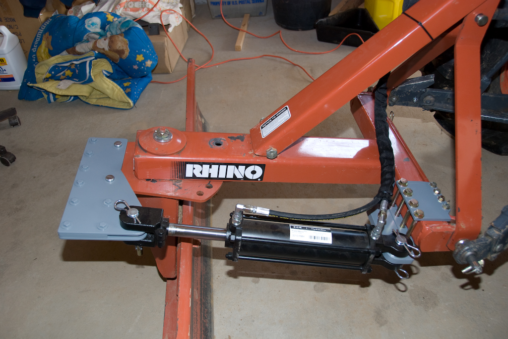

I haven't done it but was thinking about doing an angle cylinder for my rear blade, some one posted a pic don't know what forum/thread but you can get an idea from this pic.
If I do it I would want it to work with blade both forwards and with blade turned around should only require a couple of extra pins. I guess if I do it to the blade the same cylinder could be used on my rake, they're both 6'.

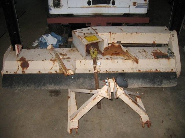

This is a Finn power landscape rake. The original mount angles the unit 15 degrees to the right. It is a solid mount with no adjustments. My plan is to alter the base, make it swival in both directions with the aid of a hydraulic cylinder. If I find a compatible pin and sleeve about 10" long I have the steel in stock to make the base.
I wonder what engineer came up with the fixed position idea ?

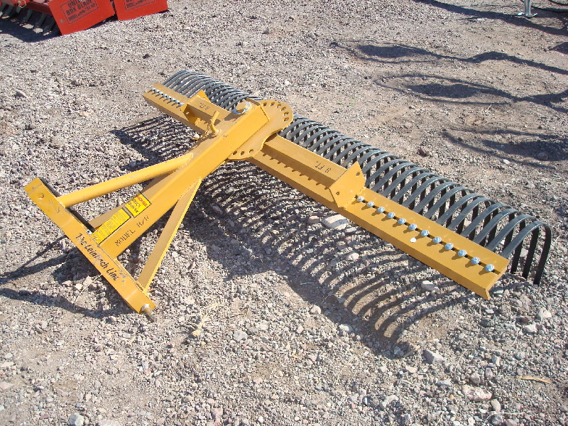

Be careful with those cheaper rakes. That Challenger will pretzel a cheaper one. I had bought one of those $500 rakes, lasted just a few times before it looked like a churro.:( Remade the rake part with new channel and 4x7x1/2 tubing, now I need to work on the 3pt mount and add hydraulic angle.

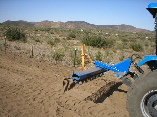

I see on page one of your thread Rob was kind enough to post a link to my home made rake build. The attached videos pretty much sum up it's capabilities. I hope you don't mind me posting these here as the thread is 25 pages long and these videos might be somewhat cumbersome to find.
A simple power angle cylinder would be a relatively easy add on to many rakes just like Dirt posted above. During my brainstorming , I checked out several styles of rakes prior to building from scratch and found the Leinbach Model RR to be constructed such that it would be the easiest to add a single cylinder for power angle. You might consider checking one out to see what you think for yourself. Below is a picture of a Leinbach 8 foot Model RR. As you can see there is plenty of room to place a power angle cylinder mount and cylinder. Not only that, the cylinder mounts could be placed such that one end of the cylinder could be easily un-pinned, rotated 180* then re-connect the cylinder for power angle in reverse. I'm just lazy and configured mine so it could be rotated 360* without getting off the tractor.
Larry
