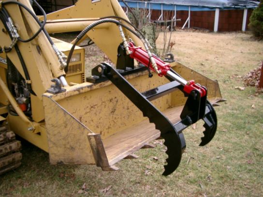

Just got the ATI Grapple - see photo - it's great for moving RR ties, has already saved my back. Has anyone taken theirs off before? Either remove 8 bolts & take the whole thing (would be a monster to remount I think) or should I pull the 3 bushings where the jaws mount and the 1 on the cylinder?

Yes the grapple is easy to take off by disconnecting the hoses and pulling the two pins for the grapple arms and the back pin for the hyd cylinder and its off. No tools required.

Here's a closer shot of the ATI GK-4866 grapple on my NH TC33DA. Haven't had a chance yet to really stress it, but there's enough squeeze to easily lift & move a very waterlogged RR tie (one I couldn't even break free from the ground manually) in a straight up lift. I purposely kept the bucket pointed straight down as I moved it about 500 yds just to see if it would slip out - no movement at all. No manual pressure on the hydraulics was necessary. I do think it would benefit from some serrations in the jaws - as they come they're just a straight edge, will have to think on how best to do that.
One of my concerns was mounting & dismounting. I talked to ATI & they said no problem just driving out the 3 main pins & the one on the cylinder - they are all made with grease fittings & a locking crossbolt. Then I can pull just the jaws & the cylinder off & leave the crossbeam on, without having to undo the 8 bolts on the ends of the bucket. Otherwise remounting the whole monster would be a monstrous chore for 1 person I think. I don't think it needs to come off for most dirt & snow work anyway.
PineRidge you asked about cost - I don't really have a breakout because this was a throw-in in the deal I made for the tractor. I'd be curious what others have paid stand-alone. ATI's website is http://www.preseeder.com/attachments/
. They are very responsive to questions.
