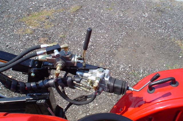

Here is a control pic from my grapple upgrade. It is a 4 way valve open center I purchased on e-bay and also you will see the adjustable flow restrictor on the close line. Works great and really is handy when picking up limbs and debris on the property.

Care to divulge the cost of valve and flow control (for 12vdc diverter $ comparison)? Was power beyond orig equipped or purchased after? $?

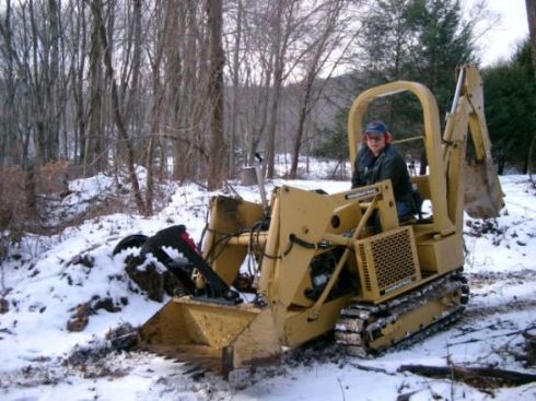

Finally got the hoses I needed to hook up the new grapple. So I took it out for some play time in the woods to try it out. It works real good for gathering up brush. Its probably not as good as a dedicated root rake/grapple might be, but its certainly a useful tool for a pretty reasonable price.
Here are a couple of pictures of the grapple in action.
John

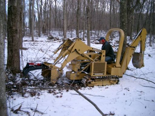

Here's another pic.
