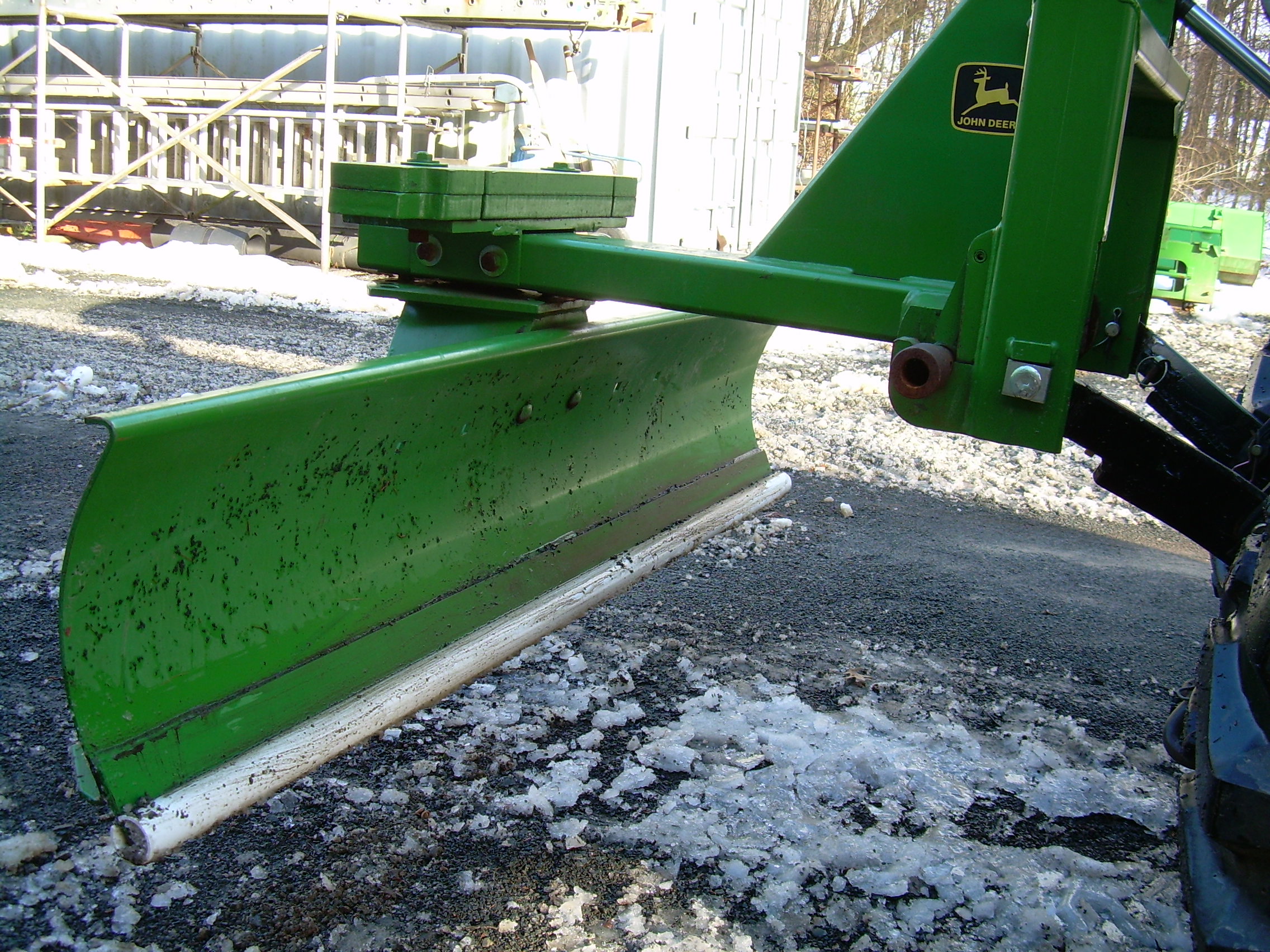

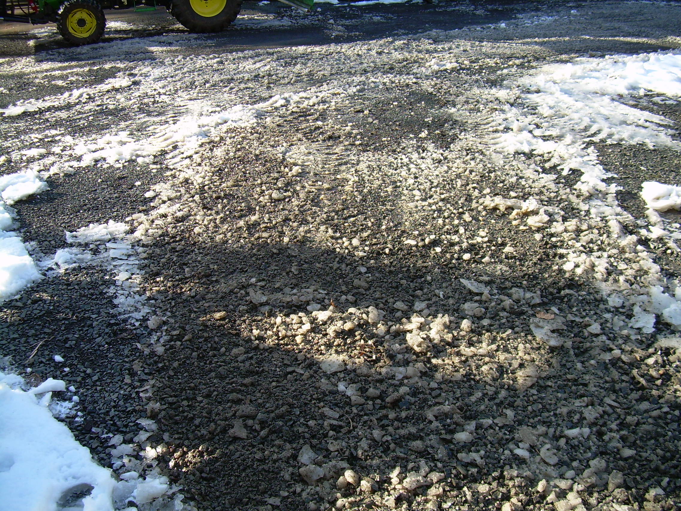

Had 3 inches of snow yesterday. Put a 6' section of 2" PVC pipe on my 6" snow plow/blade. Worked like a charm on my blactop driveway. No more scratches on the blacktop. Then I gave it a try on the gravel drive to my barn.Once again worked like a charm. There are some great ideas that come from a lot of people on this forum, and this one ranks at the top.

I got about 4-5 inches of snow and tried the ABS black pipe on my Meyer Snow Plow. Worked like a charm on asphalt but did not work on my 12 year old gravel drive. I had cut the groove using a 1/4" router bit and my router table. The slit opened up and it wold not stay on the blade. It opened up the slit and keep working off from one side or the other. I would like to try it again but use some 3" PVC.

I think you would like a table saw cut better, imo. It is straight and true and allows the pipe to grip the blade better. Also, you get more grip off a smaller diameter, 1 1/2 pipe. The larger diameter pipes lend themselves to more floppy, at least on my blade, 2" is as big as I can go. Give some other combinations, (this stuff is cheap to try) and see if you get differing results.
Chris -- I too would recomment the table saw - make 1 cut (1/8 of an inch) and try fitting it with a "persuader" __ I find on my rear blade I need a little bigger cut but I can force it on with just one saw cut. I am surprised it did not work on gravel for you -- I always use mine one gravel -- amybe it the pull versus push or something

I agree that the table saw cut is the best way to go. Small slit, good grip. I am getting read to put PVC on my loader bucket to get at the places I would normaly back blade since back blading will slide the PVC off the plow blade. As soon as I can find some ABS, I will switch over.

I know in longer threads, things get lost. PVC's shatter point in 32 degrees. ABS is tougher, down to -40. That in a nutshell is the difference. There are even better plastics, but are more difficult to locate.

Well this is the first time I have heard of using ABS for the FEL. I got a piece from work and slipped it on. We had about 20" of snow this week end and I had about 8 hrs of tractor time pushing snow from neighbor hood drive ways. 2 stone, 3 gravel, and 3 paved about 200' each. Each of these was done twice. The ABS is still usable and it only came off twice because I forgot it was on there and back dragged. I am getting another piece to have ready when this one fails. Who ever came up with this idea or at least posted it THANKS
