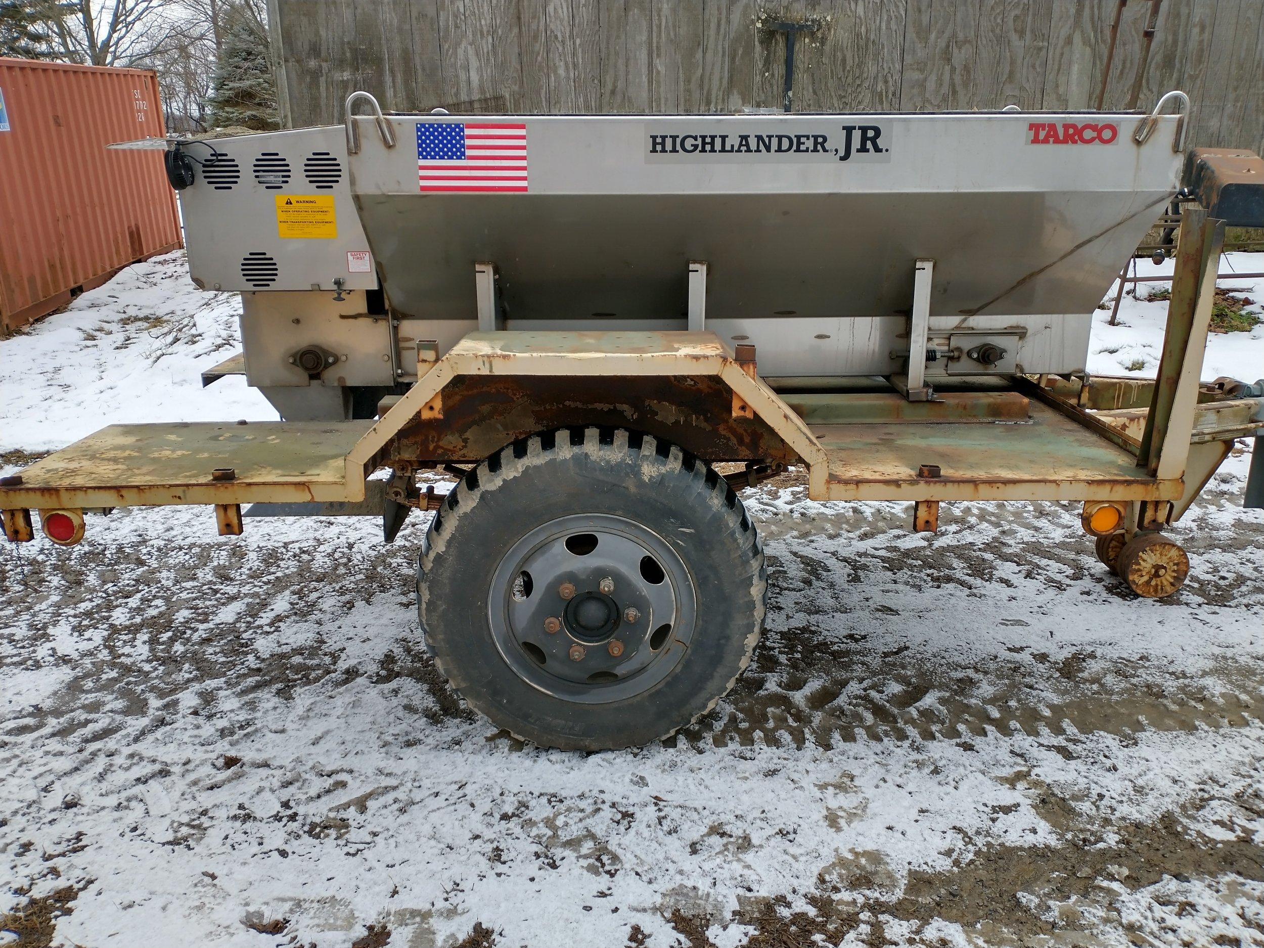

Straight salt is not good for them as it will thaw the gravel/dirt and become sloppy and slick on top.
Sand with just enough salt mixed in to keep the freezing in the pile limited so you can dig it out does a good job.
Sander is mounted on a trailer now,

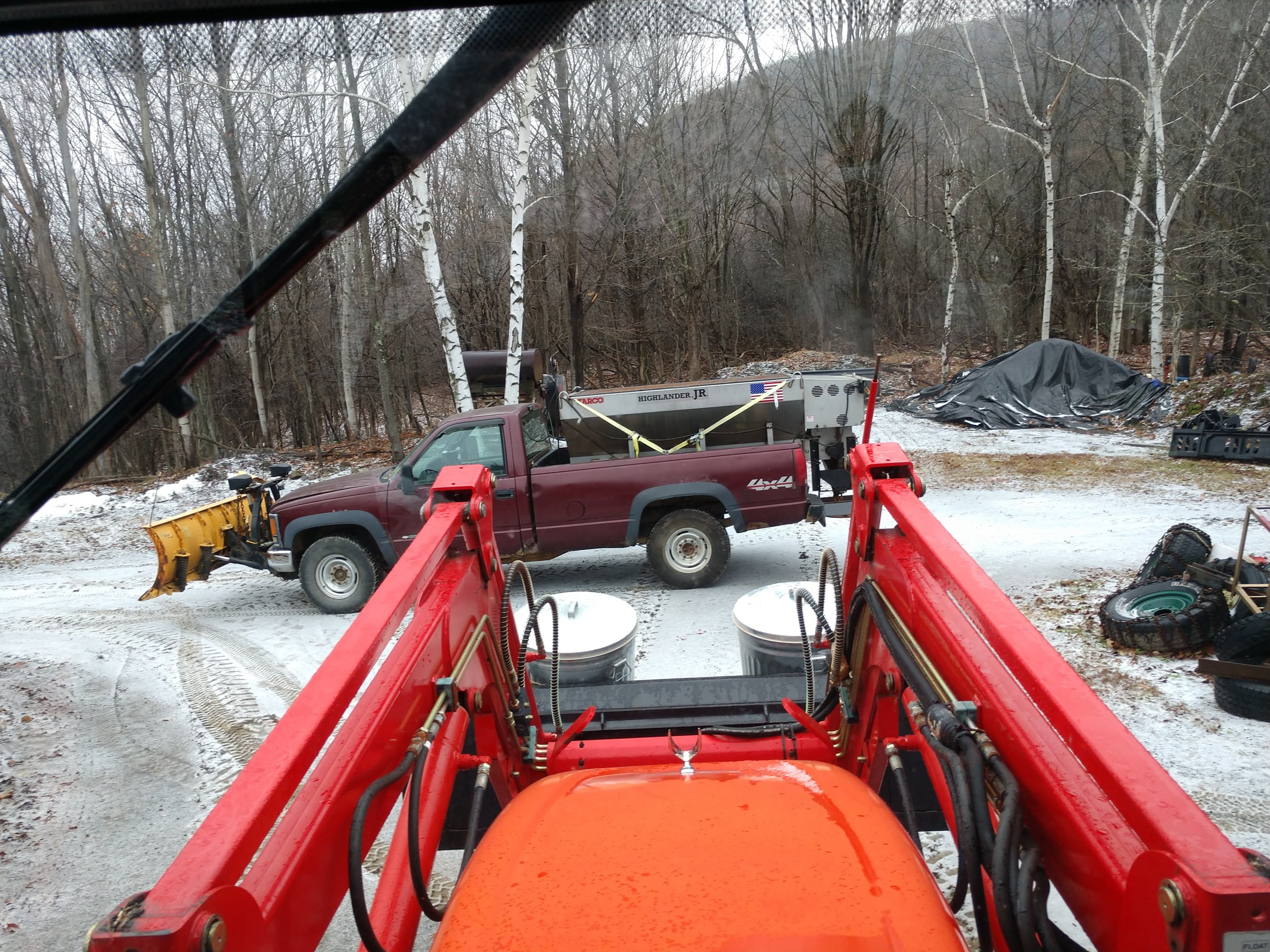

When it was truck mounted, it is also handy for spreading ashes on the driveway to save sand and use the ashes (I burn coal for supplemental heat)
I have to sand my driveway as most of it is 14-16 degrees or about 25% slope and much of it is shaded,
any wheel traffic on turns the snow into ice and then it's a bob sled run with an S turn in it.
Not real nice in a vehicle.

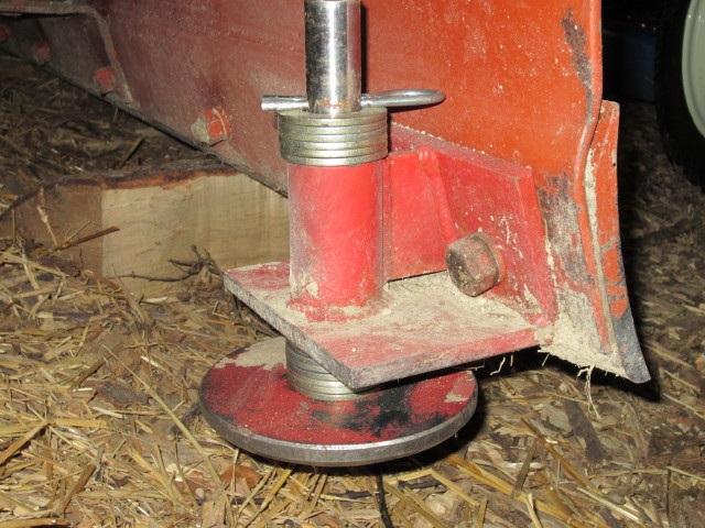

I made shoes for my 7' rear blade to prevent dig-in. Like other's said, most times I just run the blade backwards.
