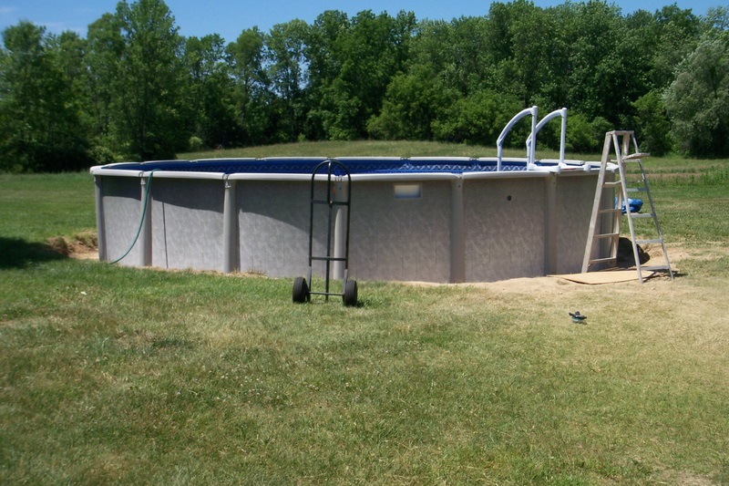

I'm a little behind you......4 Little League games in seven days, real job, side job, Little league Parade, blablabla, etc. It never ends!
Pool parts sit in garage waiting for installation. Next week looks much better.This is where I am so far.

Renob, with the pool on site and the ground broken and the summer heat on top of you, you will have the pool up quickly. What brand pool did you get? If it's Doughboy then our instructions will be the same.
This pools instructions called for the liner to be draped on the sides and then secured with clamps as shown. We had good luck with the ones shown in the picture (99 cents each at Home Depot). As the pool fills tension is released from the clamps. This keeps the wrinkles out because the liner is being stretched while the pool is filling. The tough part is after the pool is 24" deep and then removing the top rail about three sections at a time and re-attaching the liner to the wall. The 22 sections of top rail took us from 7 pm to 1 am to un-install and re-install while one held the liner and the other screwed rails.
Do you have electric in place for the pump? I ran dedicated #10 wire with a 20 amp breaker and GFI plug. HD had a green electrical outdoor pool box outlet with the plug and a switch already to go so I used it and it works fine.

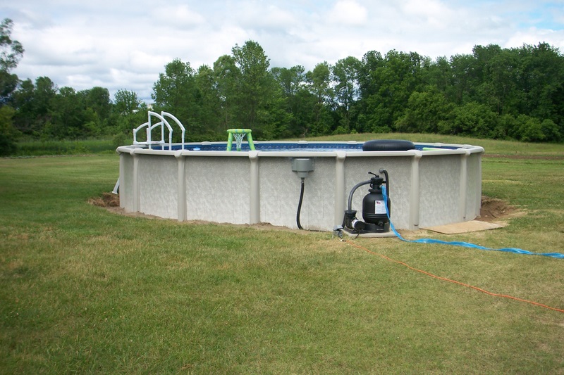

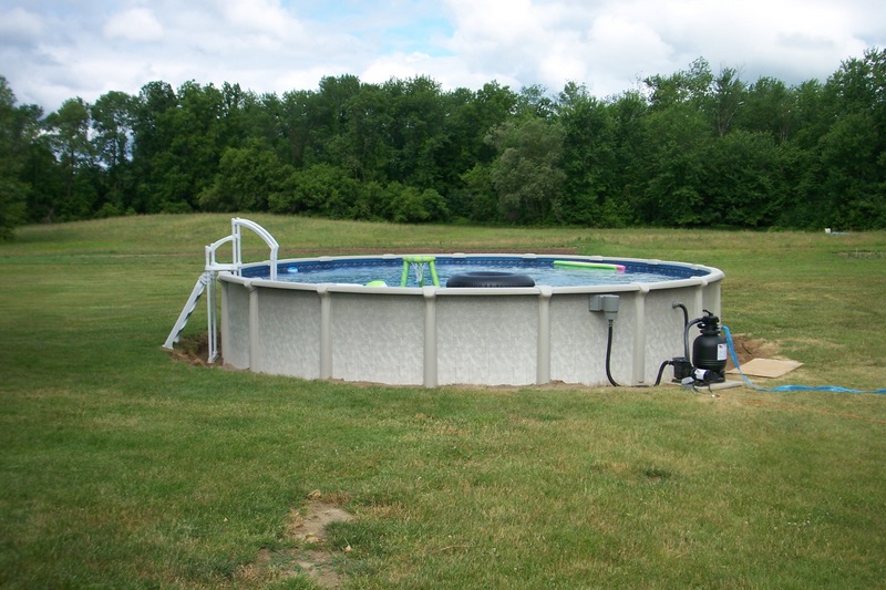

Thanks all for the information. Pool has been in for a couple of weeks now as installation went well . Can't keep the kids out of it. Deck construction is underway and will be done this week. Then permanant electric will be run in a trench with a dedicated gfci circuit.
The installation actually was not that difficult as long as all is level and round. Thanks again for all tips given, the knowledge given by TBN members is priceless.

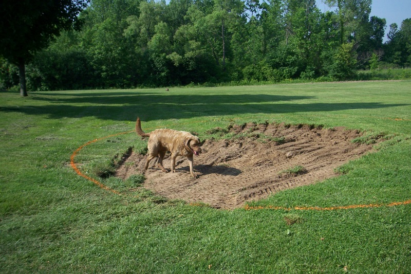

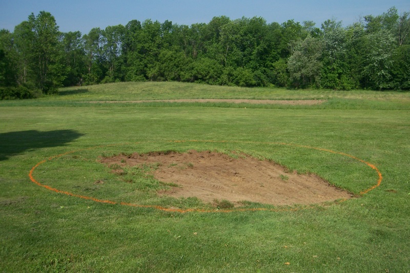

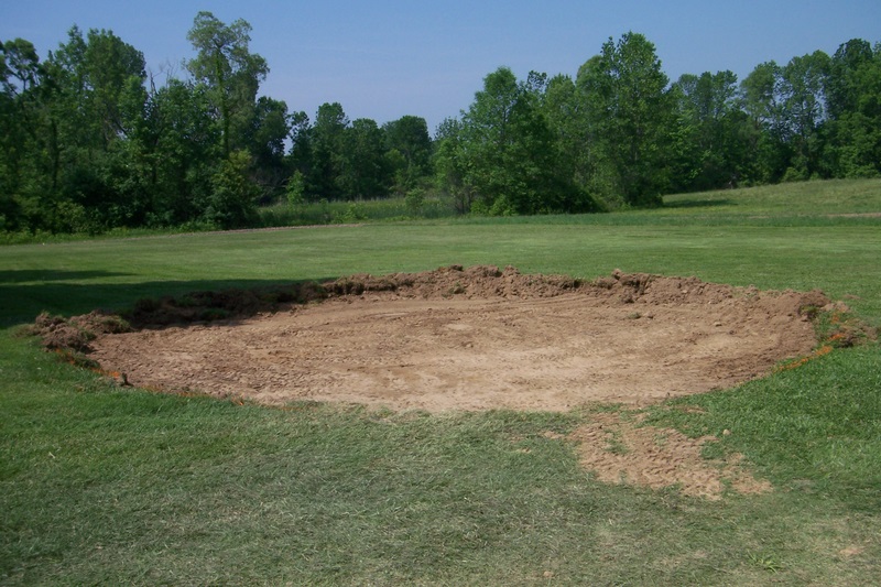

Tips: Keep away from trees, and out in full sun. At your latitude, you may want to consider some kind of heating to extend season. If you're on a well, go slow filling (or have it commercially filled), don't want to exceed well drawdown. Level, level, level! Since mine was round, I drove a piece of rebar at the center, and used a 12' 4X4 (hole in one end for rebar) with a level on it and went round-and-round digging, filling, and tamping until completely level. Then levelled sand bottom with it (never had problem with sand, 5' of water made sand bottom very hard/stable). Carefully center liner. Smooth wrinkles as you fill. Enjoy!:)

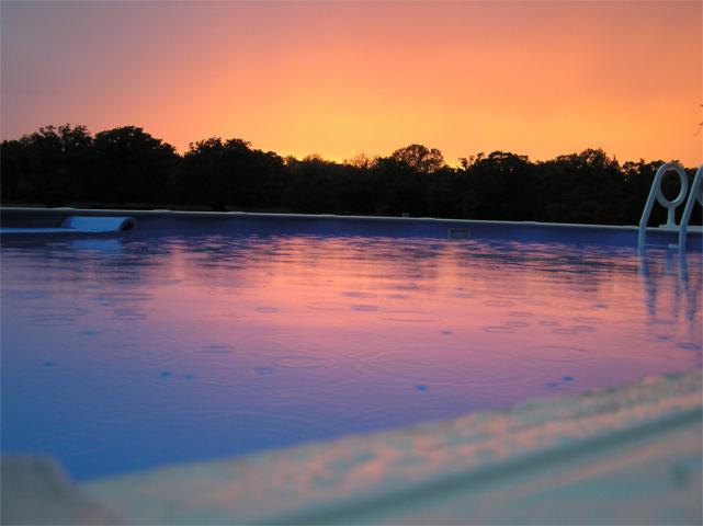

Hey , my deck construction is also underway and will be done next month.:D

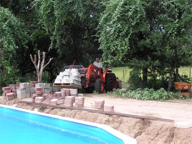

Here is a peek at it in progress, and yes there is a tractor involved!

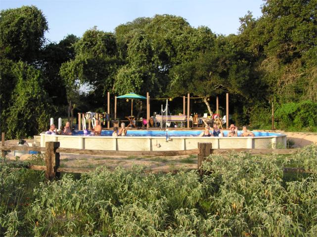

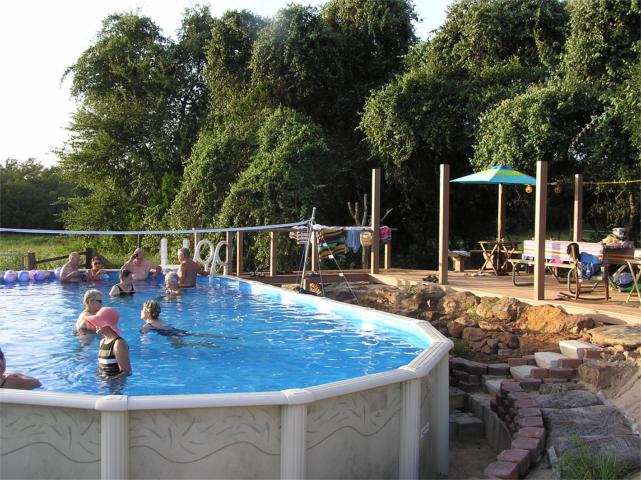

Today was splash day in the new pool for the retired group of Lee County volleyball players. (we need a pool so we won't break any bones.:D )
13 people played a competitive 4 games.
The tractor dug the pool below grade, dug and hauled rocks, and moved pallets of cement blocks and retaining wall blocks.
The deck was made with composite decking and Tigerclaw side connectors. The connectors were slow at first but installation was quicker with experience. The deck is 24'X12'.
We play with 20 of the 99 cent balls as seen in the photo and retrieve the balls after each game.
Build it and they will come.
