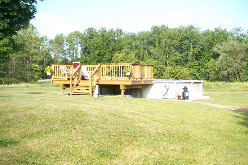

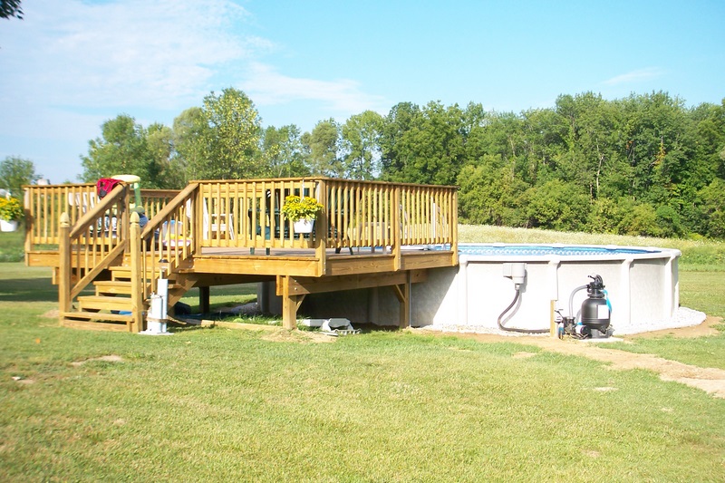

Yes the pool project is finally done. Thanks again for everyone that contributed. Every aspect of the pool install went well. I was quite apprehesive to tackle this part of the project, having no experience with building a pool.
I had built several decks before, so this end was not a problem. It did take some time to decide exactly where I wanted it to meet the pool as to maximize deck space in relation to pool and yard. I am happy with the outcome. The deck is PT wood measuring 12'x16'.
The last part of the project was to dig a 40' trench and install electric from my small workshop to the pool. It sure is nice not having the extension cord across the lawn. I also installed a 40amp timer in the shop to turn the filter on and off. This is a handy addition.
Your project came out fantastic. It looks like your crew is having a blast!
Again thanks for all the help and kind words,
