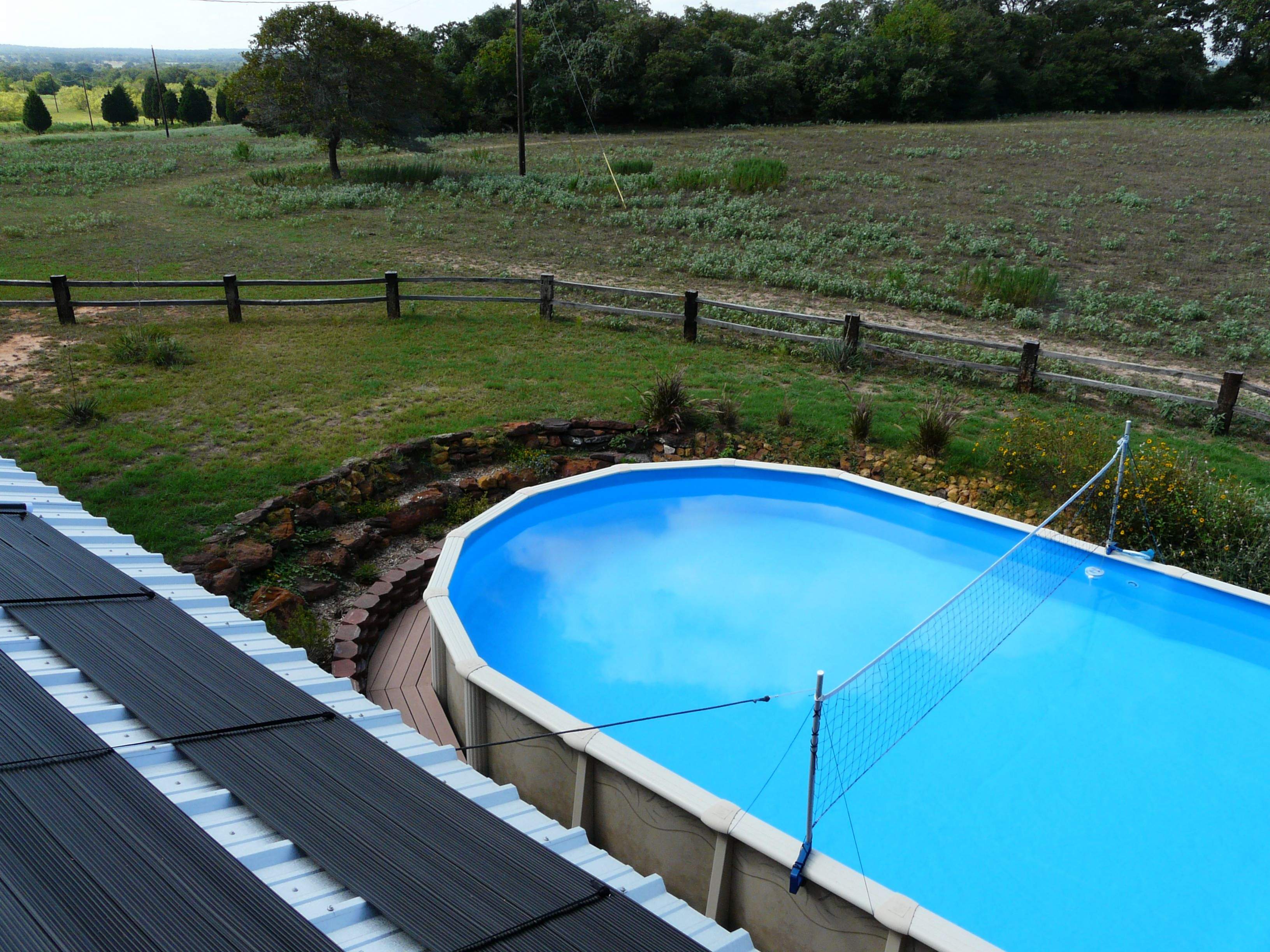

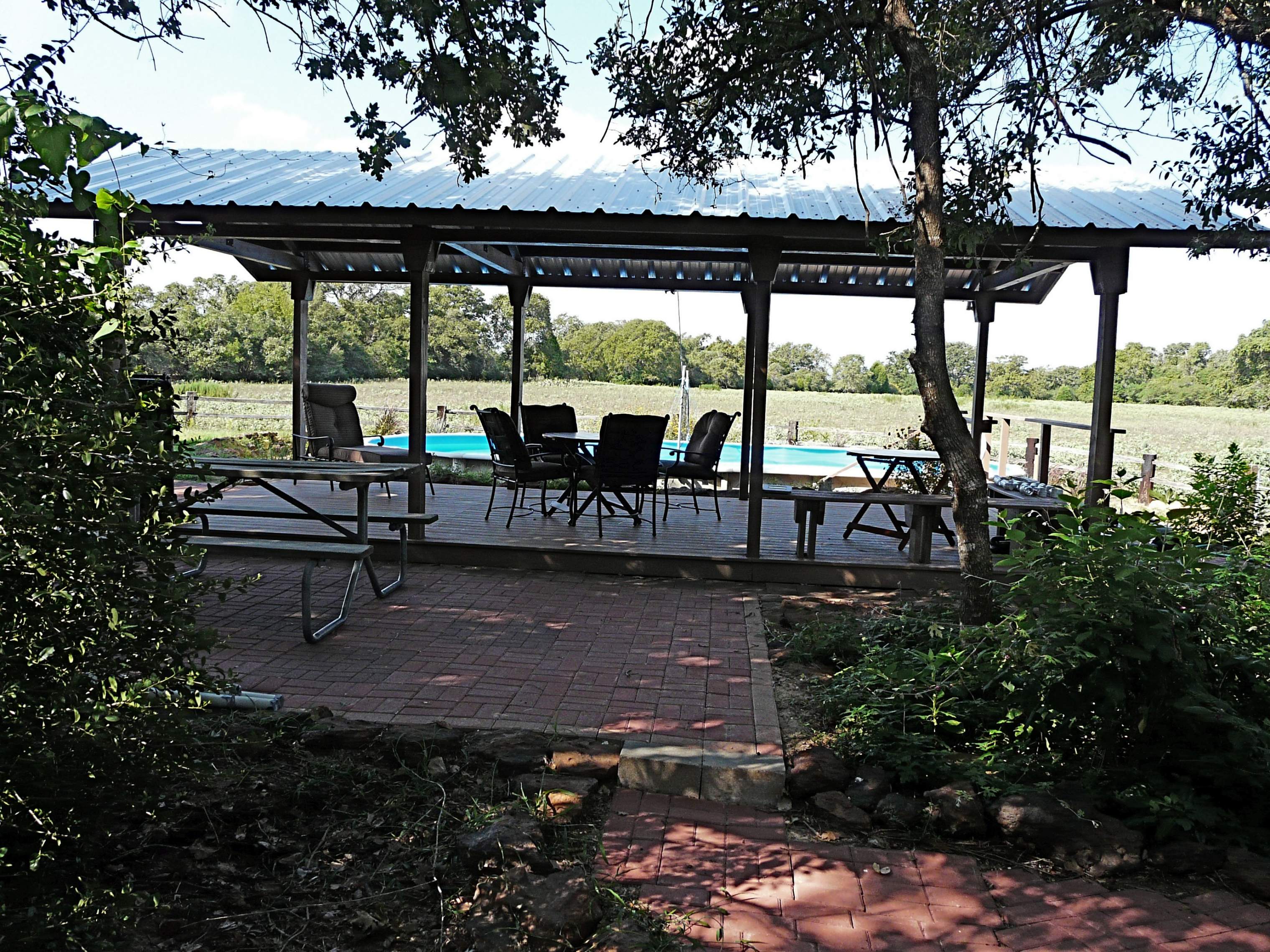

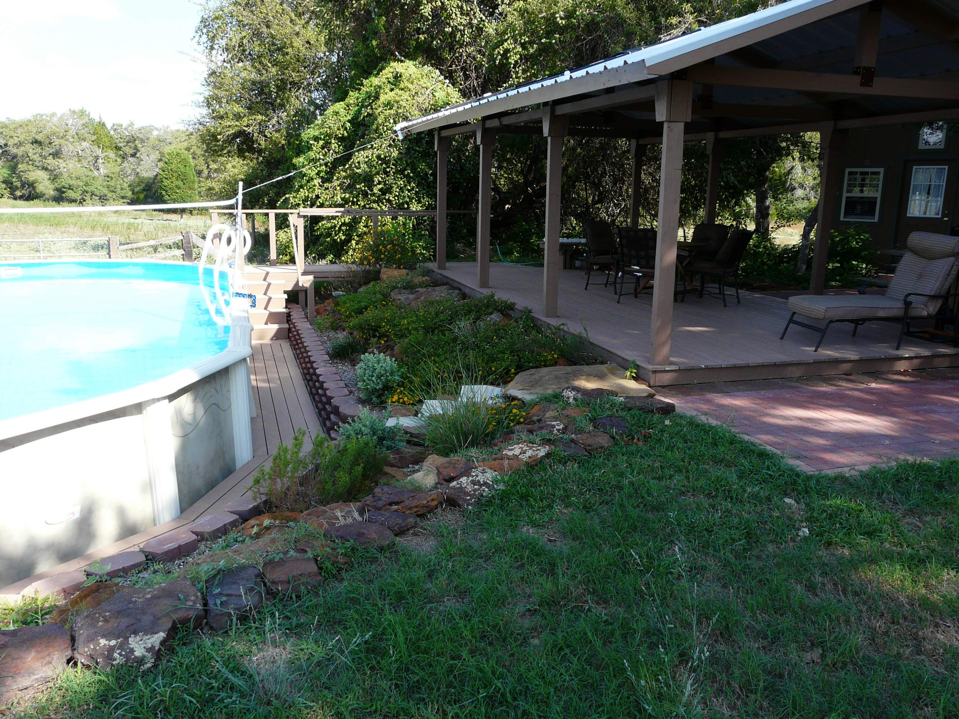

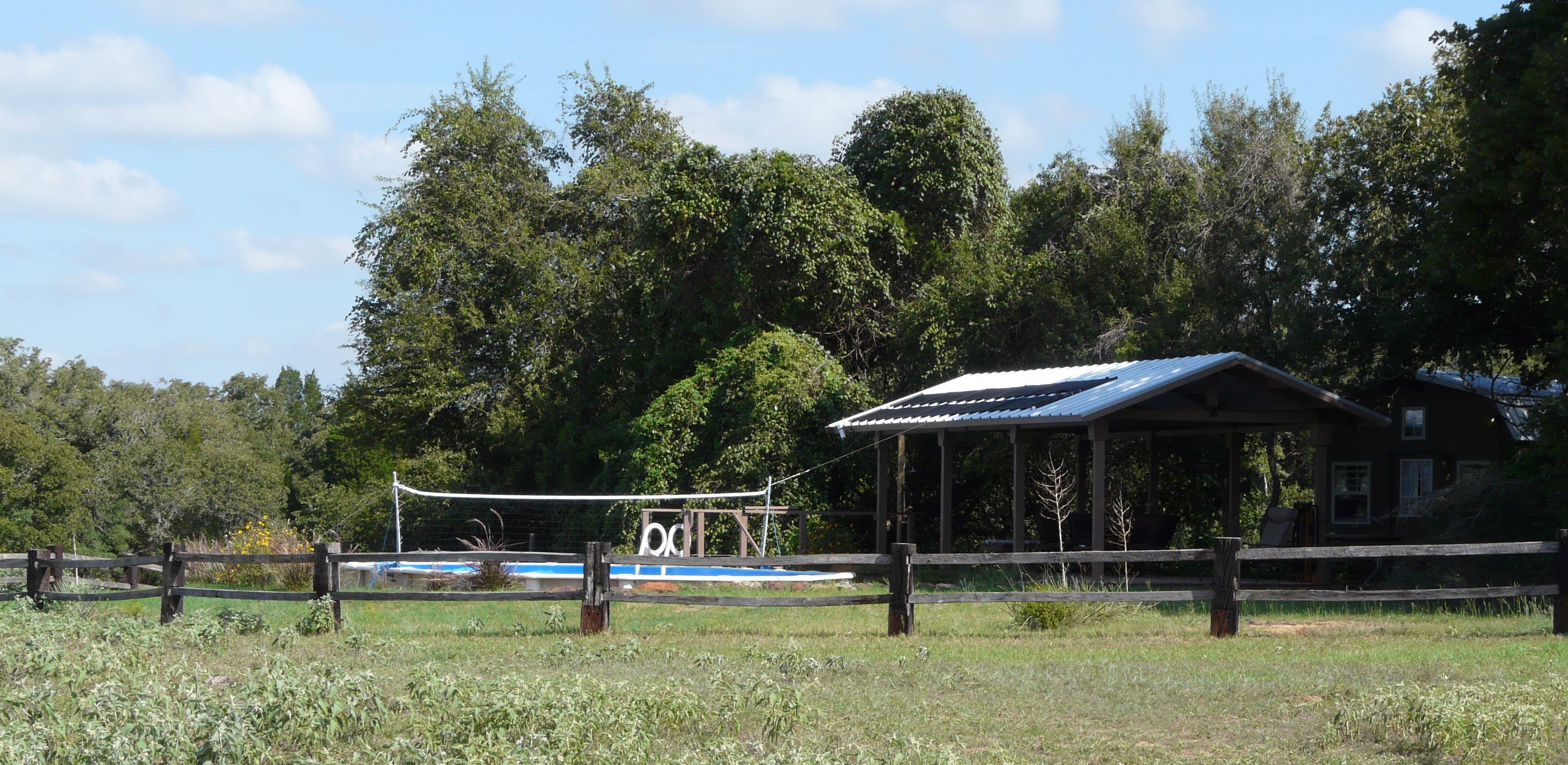

Jimbeam here are a few photos. I'm putting up to solar water heater on the roof, I'll know in two weeks if it works satisfactorily. The deck surrounds the pool at a good height to clean and keep critters out. The weekly volleyball games keep us fit and competitive. Pool temp Sept 7th 85 degrees.

Hey TxDon, that really looks great!
Who has to get out to go retrieve the volleyball after you spike it?:)
I'm interested to hear how the solar heating works out. I know one of the best things you can use is a translucent bubble insulation pad that you just put on top of the water. It will eliminate the surface cooling as the breeze passes over the water. Also, it allows the sun's radiance to shine thru and warm it during daylight.

Last year we used the solar cover but it kept getting dirty and it is easier to clean the pool than to clean the cover. On windy days it would be bunched in a corner or on the ground. It did keep the pool warm till mid November.
I'll let you know the results of the solar heater on the roof experiment.

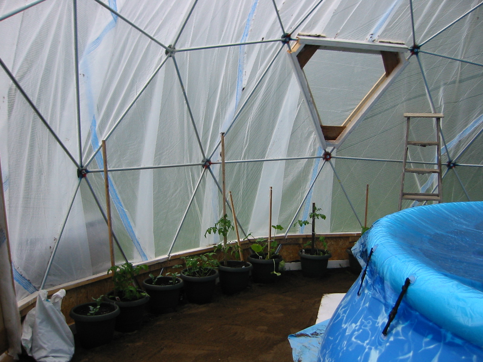

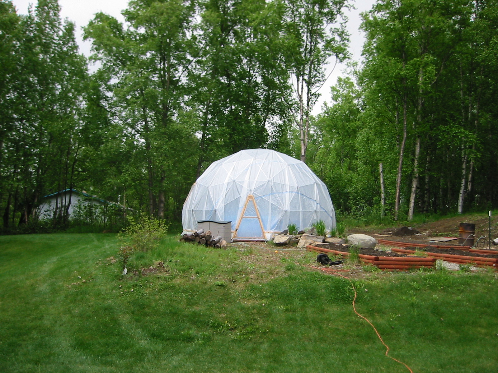

That looks very nice!!! Yes.... its a ongoing battle to keep them clean, but its worth it.
Here in Alaska with the ground temps so cool, I use carpet pad under the pool and I built a dome cover, which makes a great place to grow tomatoes:)
