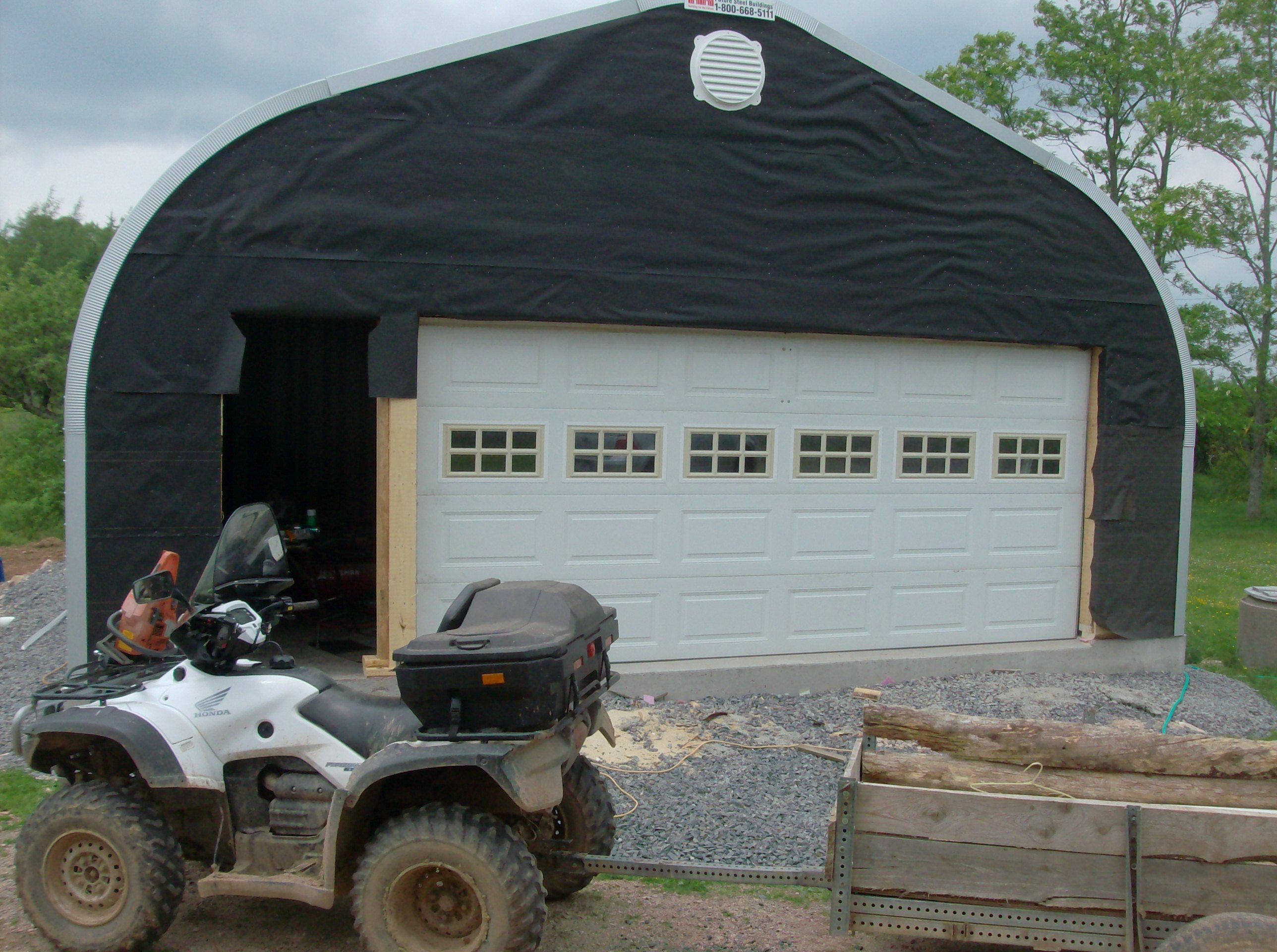

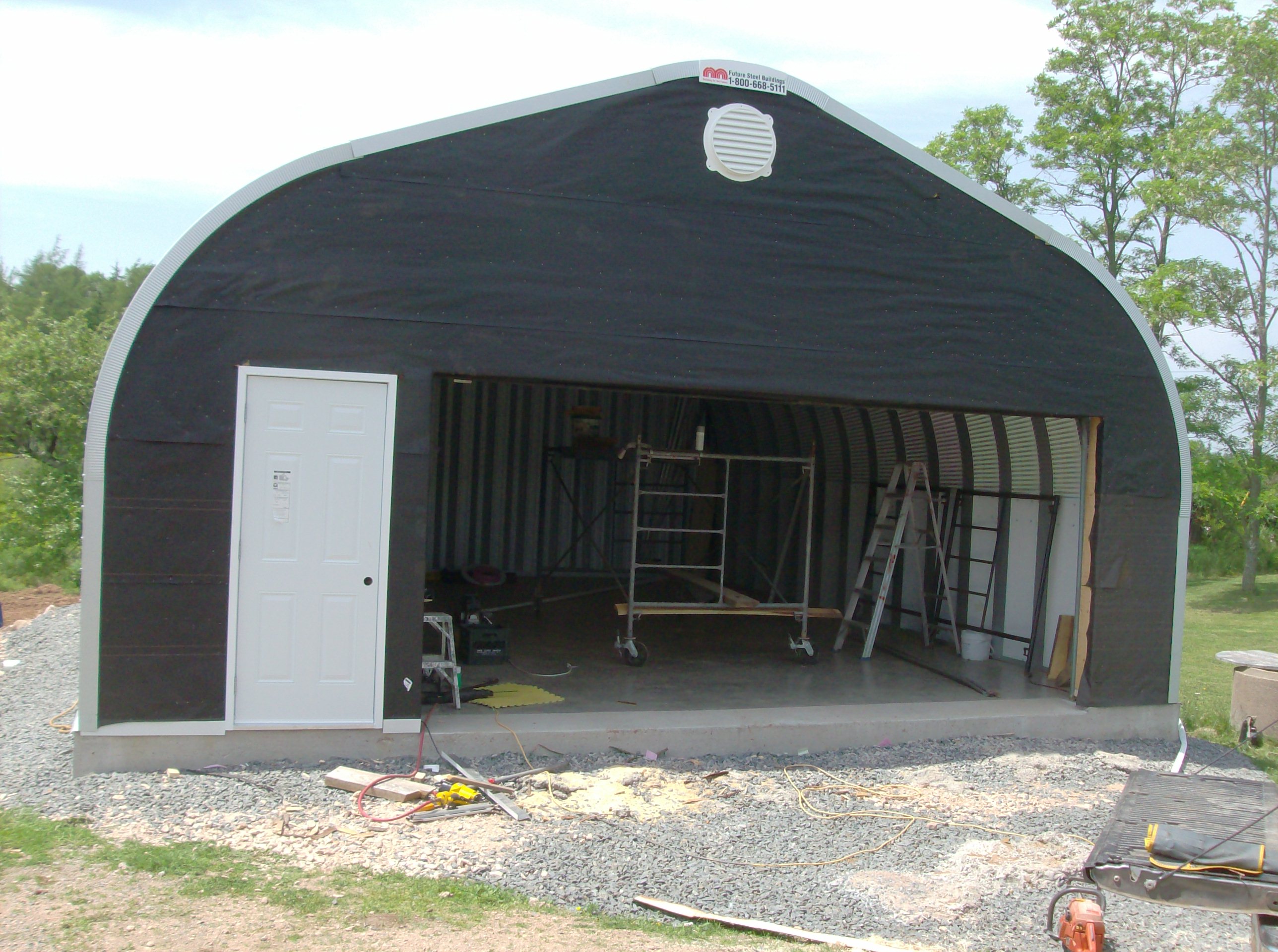

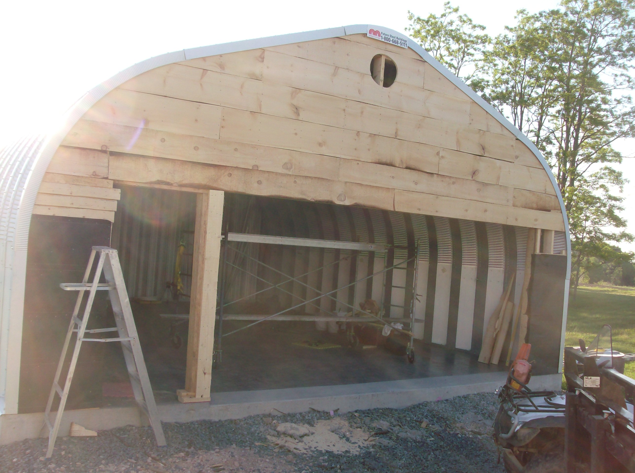

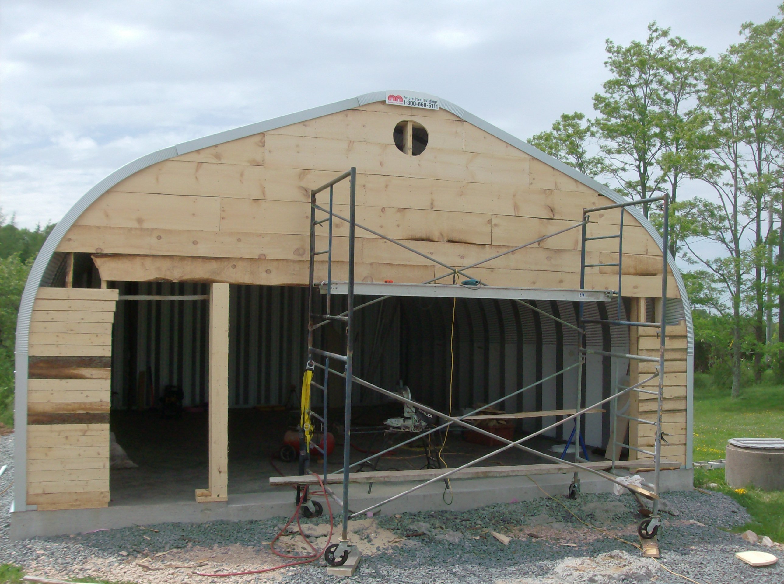

Been working on the front wall . All takes time when I have to harvest the trees before I mill them into boards or 2x6s. Issue I have now are the bolts are leaking water where the arches tie together. Cant tell which ones as they cant be seen . Only water showing up at the bottom of several rows.
No heat in building just storage.
Door is not framed yet as I didn't buy it. Stopped boarding is as I need to buy some vents to allow air movement.
Bent my flashing today. Dave to blend my flashing in I will paint the outside trim white and then will match.
BTW the boards are pine 1x11 and 14" x11'

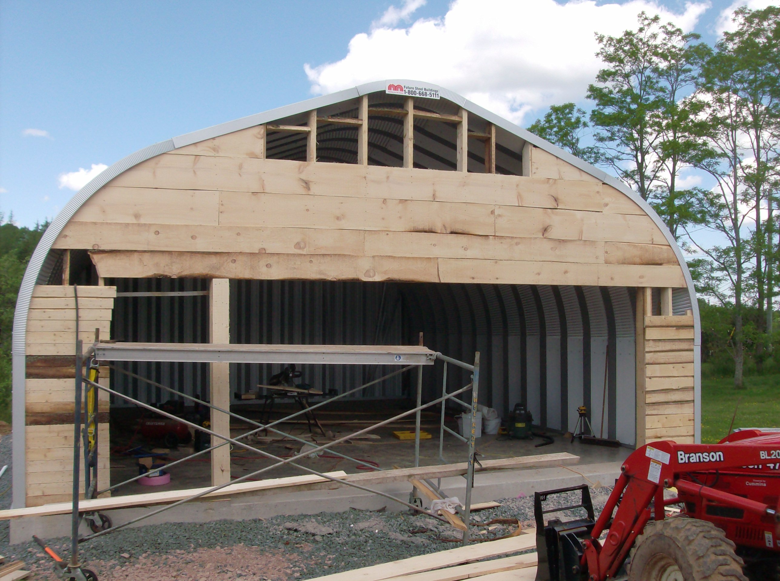

You don't know how nice it is . I need a 2x4 I go make one . Considering the hardware store is 35 min away.Last fall I built a pole barn and needed a 21 ' 2x4 so I made it. That was strange looking. Finished up the top today milled out 3 more 2x6s for the man door HPIM3558.JPGHPIM3559.JPGand got ready for tomorrows work.
Once the wife picks a color for the siding it will be time to wrap up this project.

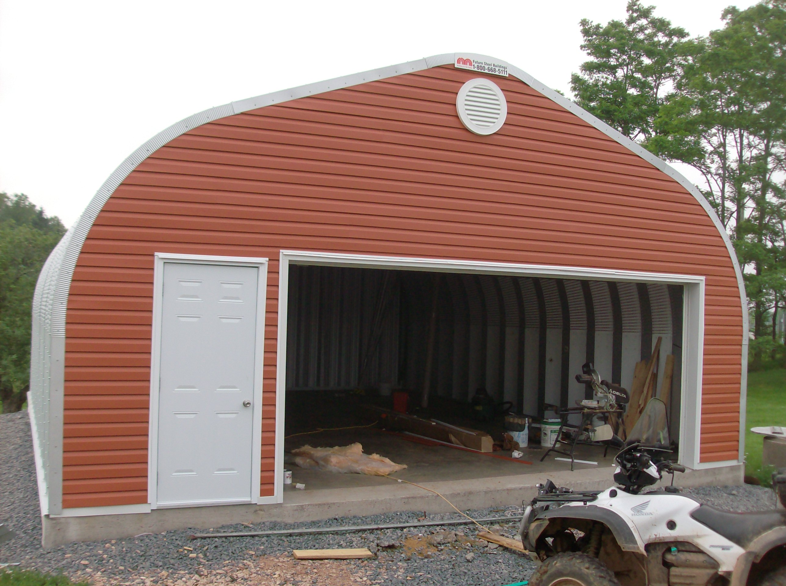

Well just had my final inspection and passed. Thanks for the assistance.
Now to get the water leaks fixed .

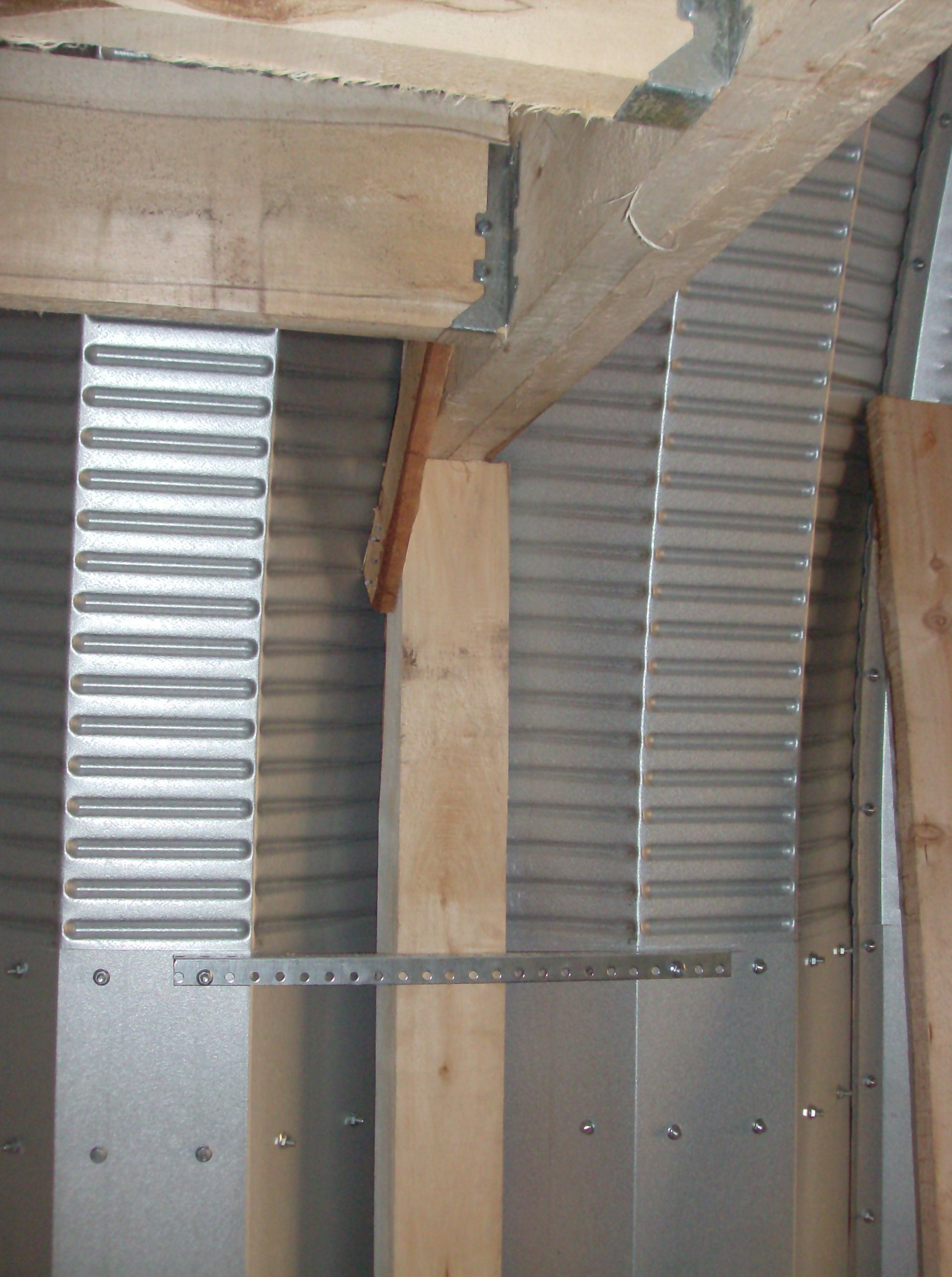

Think I have beat the leaks Seems to water was rolling in as it goes down the straight side wall Because the bottom is chalked and the chalking seems to build a small dam maybe 1/4 high the water can't get out so it flows inside through the rivets and layers of metal in the base plates.
If the next guy building one was to slightly bevel the outside pad base plate area Then a smaller dam would be required .

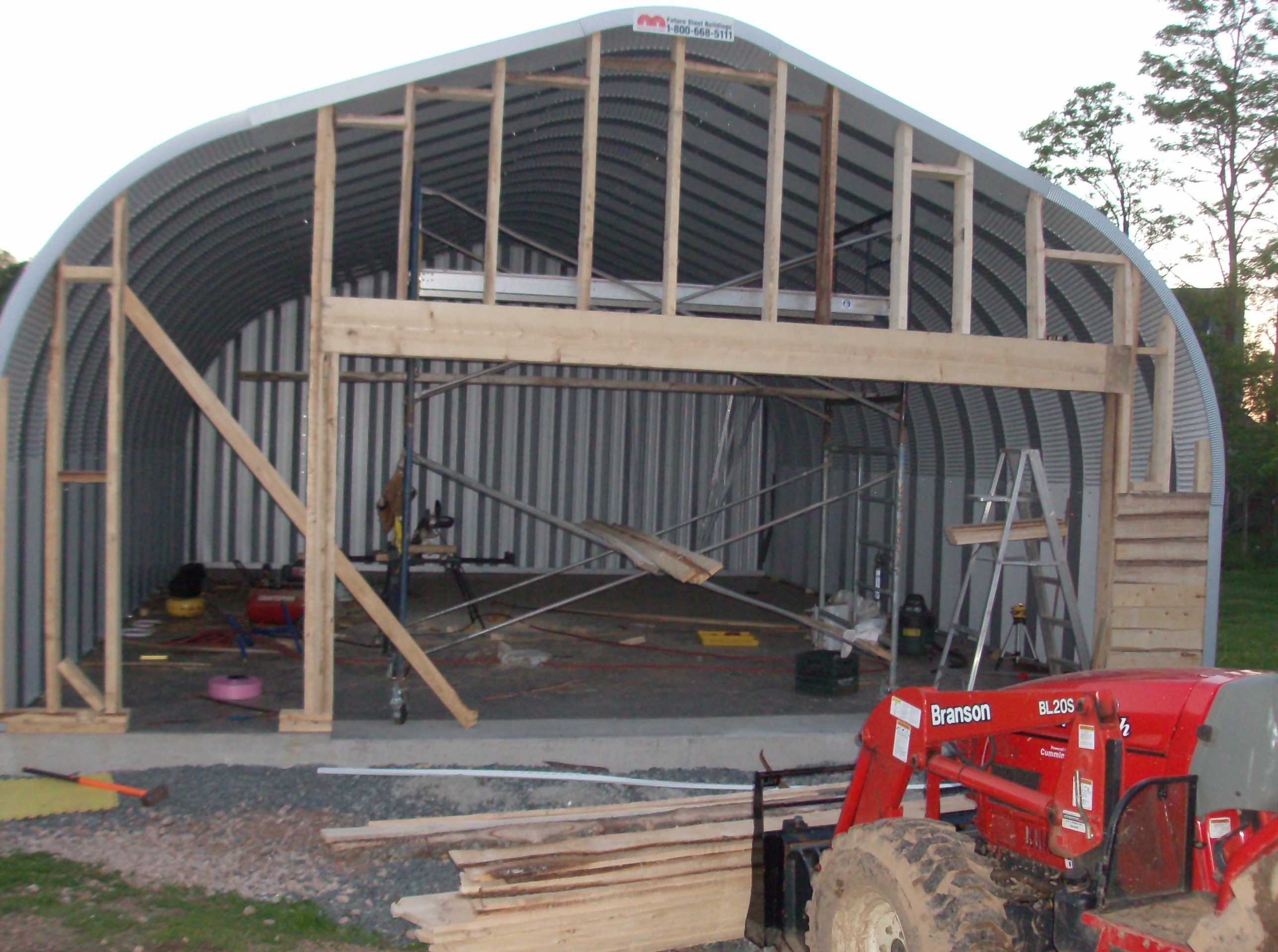

Had a couple hrs yesterday to start work on the mezzanine Built from 2x8 poplar and spruce I milled myself. Should make a lot of extra storage in the wasted area above.
Will nail the boards on today . At least the ones I have then its back to the bush for more logs to mill.
I have a similar bldg., 30X50,and I used the commercial base plate to join the bldg. to the pad, utilizing 108 redheads. I have never been able to stop the water migrating under the base plate, and after 10+ years, am getting a considerable amount of rust and corrosion where the water accumulates. It seems to me that the water comes in around the nut/washer on the red heads, and the seams in the base plate. When the base plate was fabricated, it was stitch welded, so that leaves a path for water. I've thought about filling the cavities inside the bldg. with paraffin, but that would be expensive. Please post some pix of how you caulked.
