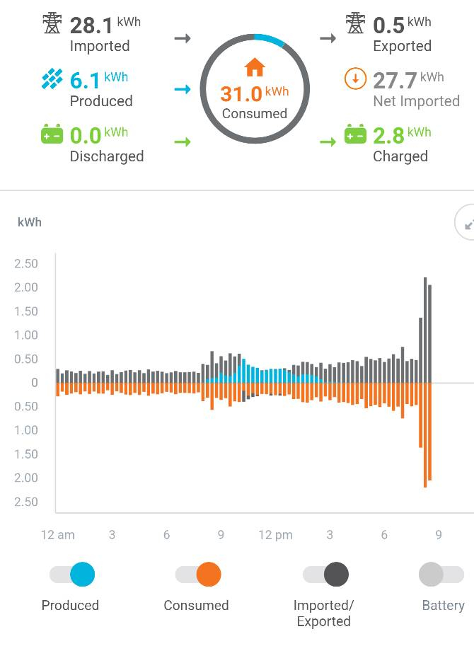

As I stated earlier, I have a wide-open placed ground mount of 10.24kW DC, 7.68kW DC array.
Today was stormy and gray; here's the production:
As you can see, it only beat our consumption during a brief time and overall produced only 6kWh today. I've seen darker days, too though there certainly wasn't any sun or thinning of clouds either.
This production wasn't enough by itself to keep furnace, fridge, freezer, and occasional well going in an extended power failure (we have 30kWh of battery) if needed in the winter.
I think I'll start figuring out how big of a back-up generator I need... I don't need a transfer switch (I've got that as part of the battery system), and I could actually wire in any 240V generator but one with electric start would be nice :)
Today was stormy and gray; here's the production:View attachment 724808
Sent from my Pixel 3 XL using TractorByNet mobile app
Since you have batteries, you can size the generator to run for six or eight hours flat, at 60-80% load taking the batteries to 80+% charge and then run off the batteries until the next day, for maximum efficiency.

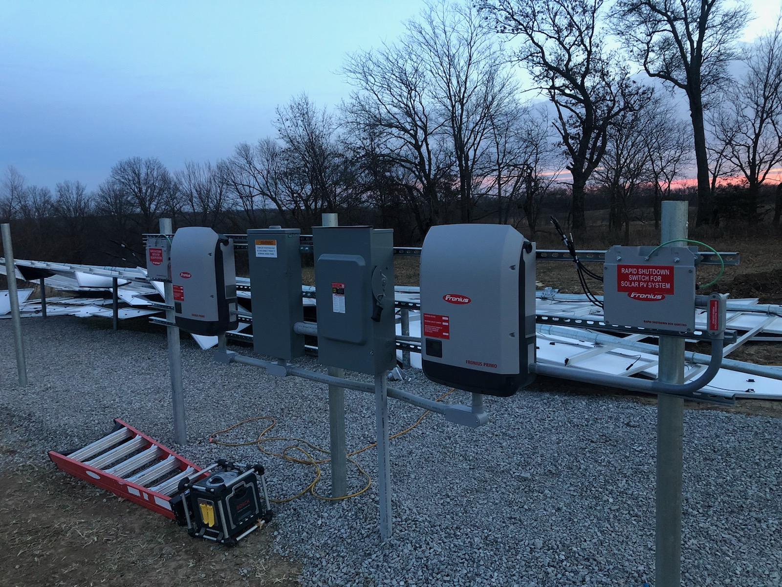

Panels are getting a test tonight. So far so good but we are getting wind gusts in the 80+ mph range. A few strong enough just now when I was outside checking panels that they were pushing me sideways and hard to stay on my feet. Looks like I may have a small amount of shingle damage on the roof. Will have to check in the morning. Big props to our electric coop. They do a great job of line maintenance. Most of our nearby city is out of power and ours hasn't even flickered.

This was a nice site to see this morning. I know of 2 people that lost panels last night. Lot's of downed fences, trees, etc. Highest wind gusts recorded in our area were 85 mph. We never lost power but the outage map showed 27,000 without last night.

Great job on the construction!
