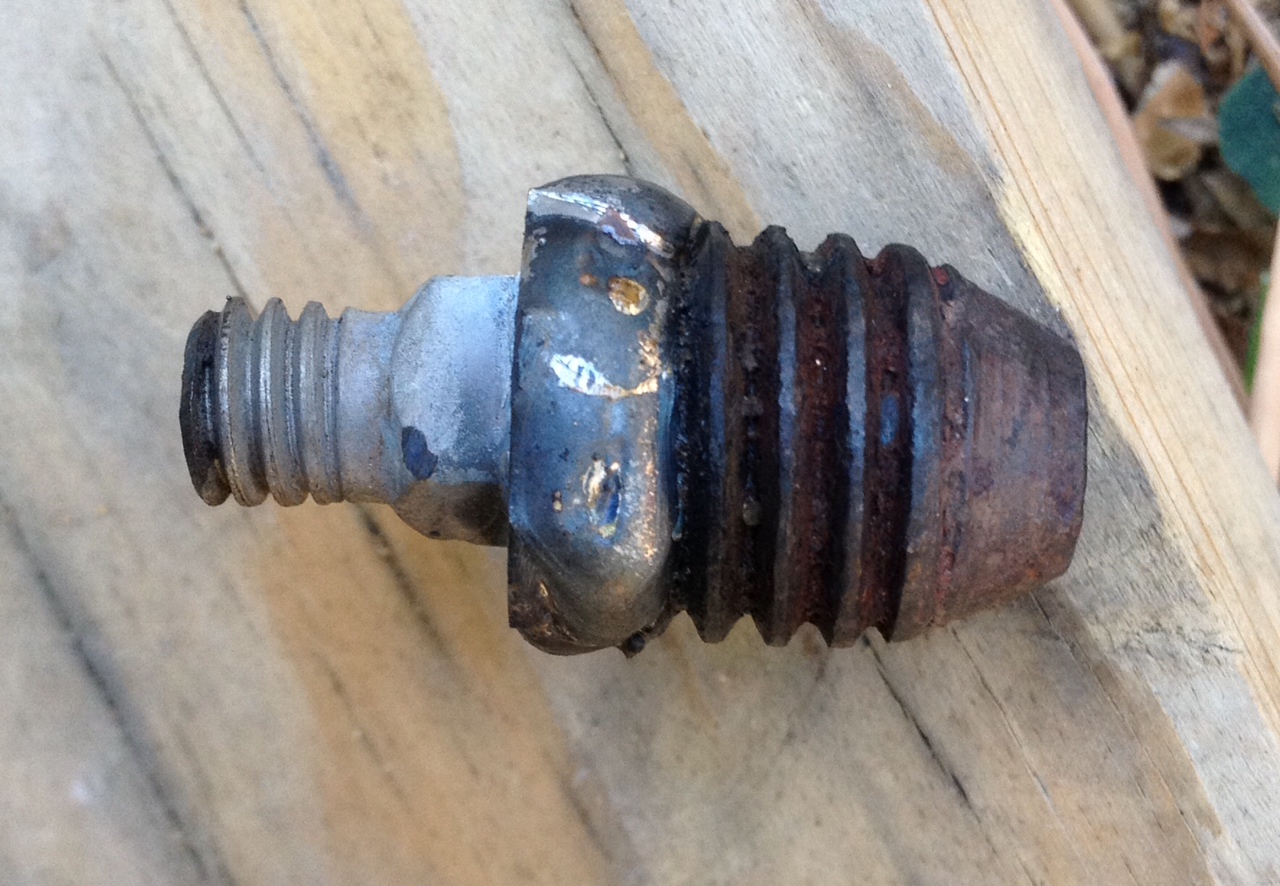

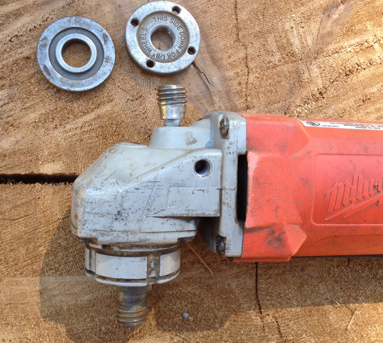

Some angle grinder attachments include "the nut" such as a wire brush cup. Others (like thin cutoff wheels) require the 5/8-11 fittings. So when you remove the fittings, and the 'nut' where do you set them?
I usually set 'em somewhere then knock them off the table. Because I'm grinding I don't hear them tinkle deep down into the scrap pile :mad:.

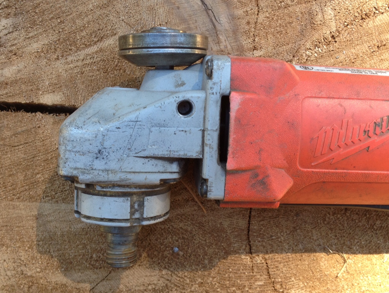

I welded a 5/8-11 thread stub to a 5/16-18 bolt, to act as a holder for the fittings. It screws into the handle hole (I never use the handle on a 4 1/2" grinder). But anyway it's pretty easy to make with a MIG. And Mudd, it's not likely to cut parts loose on the freeway! Newbies could do this, and be successful (even if their welds never pass xray tests :D ). Some guys "could" do it with stick, and of course James would TIG it :D.
This part could be molded out of plastic and would sell well, I think. MFRs should have moulded this thread stub into the grinder's plastic housing somewhere.

Glad you guys like it. For DeWalt angle grinders you need an M8-1.25 bolt, and of course the 5/8-11 side is standard for all.

Gary I can't remember the last time I used the wrench on those fittings I just tighten/loosen by hand. It sure doesnt seem like they will rattle off the holder.
