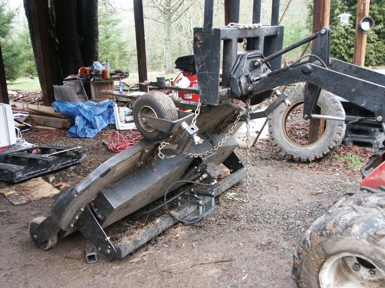

One of my many projects before I have to go back to work is fixing the mower. PT put it together wrong, with the spare bolts installed on the other side of the stump jumper. So I have to take them apart because....
I need to create a bumper to stop my blades from sticking on the stump jumper.
This said, what do you guys think of using a hockey puck drilled through the center? It is hard rubber, but I am not sure if it is too hard and will just shatter when a blade swings into it. The other idea was just a chunk of old tire. I thought the puck would be better cause it would be ballanced weight wise.

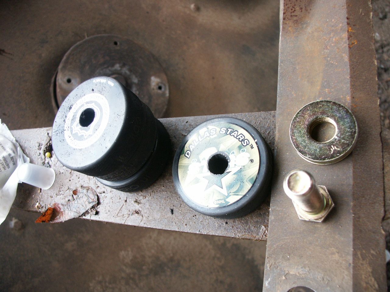

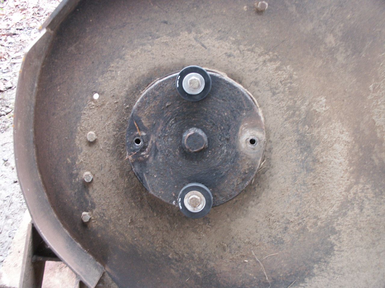

Well, I spent all day working on the mower. It turns out all the bolts I thought were installed backward were actually broken off heads. What a PITA.
But I wanted to update you all on my bumper quest. I went out found a truck tire. 20 ply. And tried to cut it up with NO success. It would cut in one direction but not in the other. Used a sawzall and everything.
So I went back to plan A. Hockey pucks. Drilled just fine, maybe too easy (will they survive).
Here are some pix. In the brief run that I did before the PTO acted up they seemed to work quite well...
Two notes. First is that they stick further down than the blade bolts. Not sure if this is going to be an issue or not
Second, the mechanic who was up here looked at it and said I should put a peice of pipe inside all of this so that I have something to tighten down on. I passed on his idea but, maybe in the future....
Carl...

Carl,
Cutting tires is tough, but it goes both ways...
My bet is that the pucks will fracture, since they have no internal reinforcement from fibers, but you'll find out soon enough.
Your mechanic buddy makes a very good point; if the puck can spin on the bolt, rocks and debris can rotate the puck, rather than grinding on it. Since it sticks out....
Let us know how it goes.
