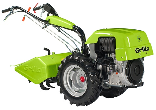

/ A bcs by any other name.... #19
The grillos are according to the websites don't have all speeds both directions (not that matters with soil working ). From what I have heard the difference between the BCS/Ferrari/Pasquali and the grillo is that the BCS are a bit more user friendly and a bit dearer ($ is comparable here) than the grillo. Here is the photos of the US models and the AU models
g131_diesel.jpg US model
grillo.jpg AU model
