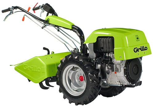

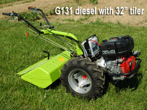

The Valpadana are more expensive and the only have one reverse gear. The Grillos that are here are not the same as the ones as farmerboybill was talking about. I think the the 40 would do all that you need it to. I looked at grillos and valpadanas but we decided on the ferrari because of versatility and price.
   / A bcs by any other name....
#18
I've seen a few places selling the 131 which farmerboybill recommended. Haven't priced it yet but the smaller models are selling at prices comparable to the US sites.
I'm not that worried about the reverse speeds on the Valpadana but they do look quite pricey and as they are built in Turkey and I don't have anyone to recommend them, they are not at the top of my list.

The grillos are according to the websites don't have all speeds both directions (not that matters with soil working ). From what I have heard the difference between the BCS/Ferrari/Pasquali and the grillo is that the BCS are a bit more user friendly and a bit dearer ($ is comparable here) than the grillo. Here is the photos of the US models and the AU models
g131_diesel.jpg US model
grillo.jpg AU model
