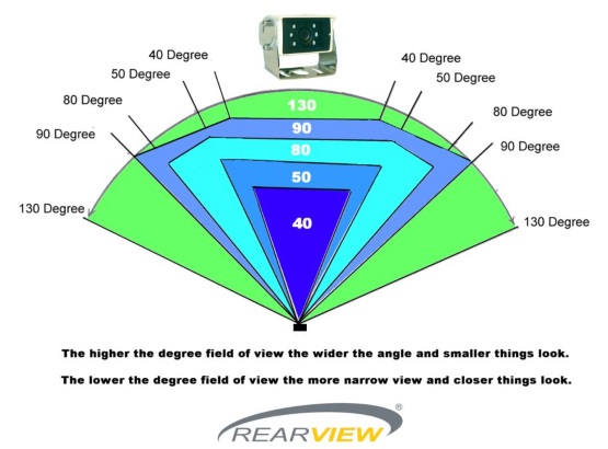

I put the same one on my tractor thinking it would be good for snow blowing and just being able to see behind me but I found that the picture was just to far away. The only thing I really used it for was looking at it while driving up the road to see vehicles coming from behind, other than that it wasn't of much use to me. Maybe they make better ones that have a close up.
Backup cameras have a wide field of view. You need a camera with a narrow field of view:
The one I have on the front is 50 degrees and works gooder :D.

Okay, I didn't know much about them but I figured for $50 I would try it, that's what I get for not knowing about them before I spent any money on one..
