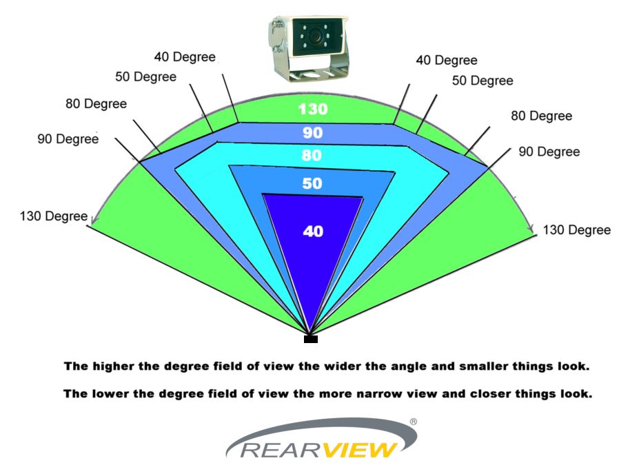

So I see that Amazon has front view cameras which allow you to not have the grid lines. Plus if I see one with a more narrow field of view, would that be desirable?
/ A backup camera for $50!!!!!!!!!!! #455
A narrower field of view does provide a less warped perspective onscreen.
/ A backup camera for $50!!!!!!!!!!! #456
A visual aid for perspective of perspective.
I have 50 degree on the front and 180 degree on the back.
