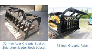

I just bought a rake grapple. $1375 shipped. Works good and has 5 yr warranty. Got in 3 days after ordering it.
Mine is a 60" on an L4400. I have the skid steer upgrade on my loader. They have larger grapples available (72") if you are interested.
