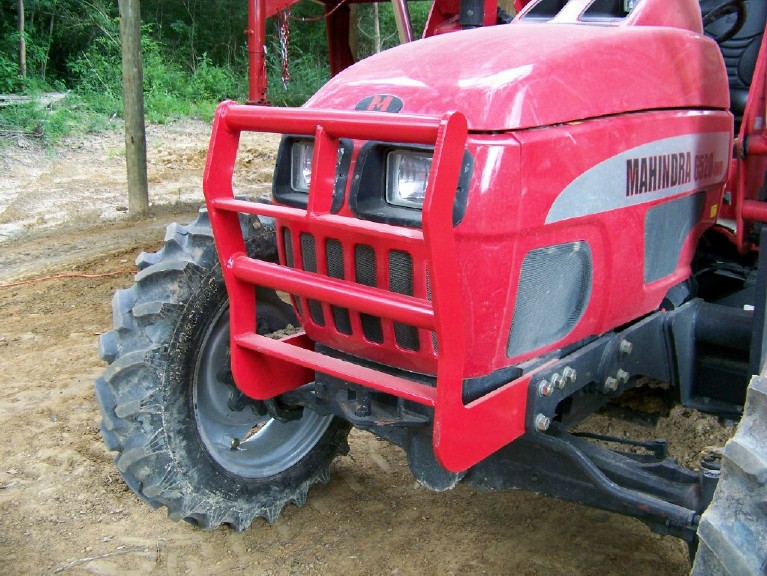

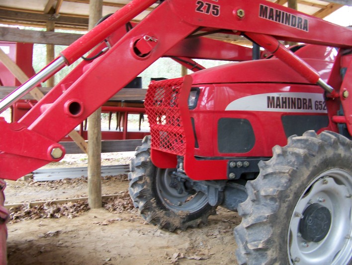

Then you need a Mahindra bumper and modifly it like I have mine.
hugs, Brandi
How much does that bumper cost, and where can I order one through the mail?
/ 7520 lift capacity #22
Any Mahindra dealer. It is a KMW product. I got mine with my tractor and I think it was around 120 dollars. Then I added 1/2 inch thick braces, then added the expanded steel. I bent the expanded metal at work and had my local welder tack it on.

Just so you are aware, the bumper for a 7520 is slightly different then the 6520. My dealer and I discovered that when I was trying to get one.
If you look at Bindian's picture, the loader frame is outside of the bumper frame. The frame would have four holes to match the the hole pattern. On the 7520, the bumper bolts over the outside of the loader frame and only has the first two vertical holes. Make sure that your dealer is aware of this so you do not get the wrong one shipped.
Brandi, I like the modification on your grill guard. The guard is plenty stout but minimally protective. I think it is by the grace of god over my skill that I have not mangled my grill while cleaning up trees with my grapple bucket.
I remember something about a two bolt hole grill guard. I am glad mine has 4 bolts. Two bolts in a vertical can be sheared with enough force at the top of the grill guard.
I nerfed my grill in one day before the extra braces and expanded metal. The grill comes off fast with, I think, 6 bolts. I dug a bowl shaped depression in my dirt floor of the barn and laid a towel on it. Then I placed the grill on it and with a small block of wood and a hammer, carefully beat the dent out, then repainted it. But I have years of sheetmetal experience on airplanes.

I forgot to take my camera:(, but the owner at Top Flight lent me his ancient polaroid camera:D. The 7520 engine casting is wider than a 6520. When a 6520 doesn't have a grill guard installed, but has a loader, a 1/2 inch thick shim plate is installed where my grill guard mounts. I have to loosen all 7 (see left photo) forward loader frame bolts to install my grill guard. If I had a 7520 I would weld a 1/2 inch plate over the area of the forward holes ON the grill guard and then you can have 4 bolts for the grill guard, but they would be two different lengths. I forgot to detail the front axle, but I think the 6520 and 7520 has the same axle, thus the same deminsions.
