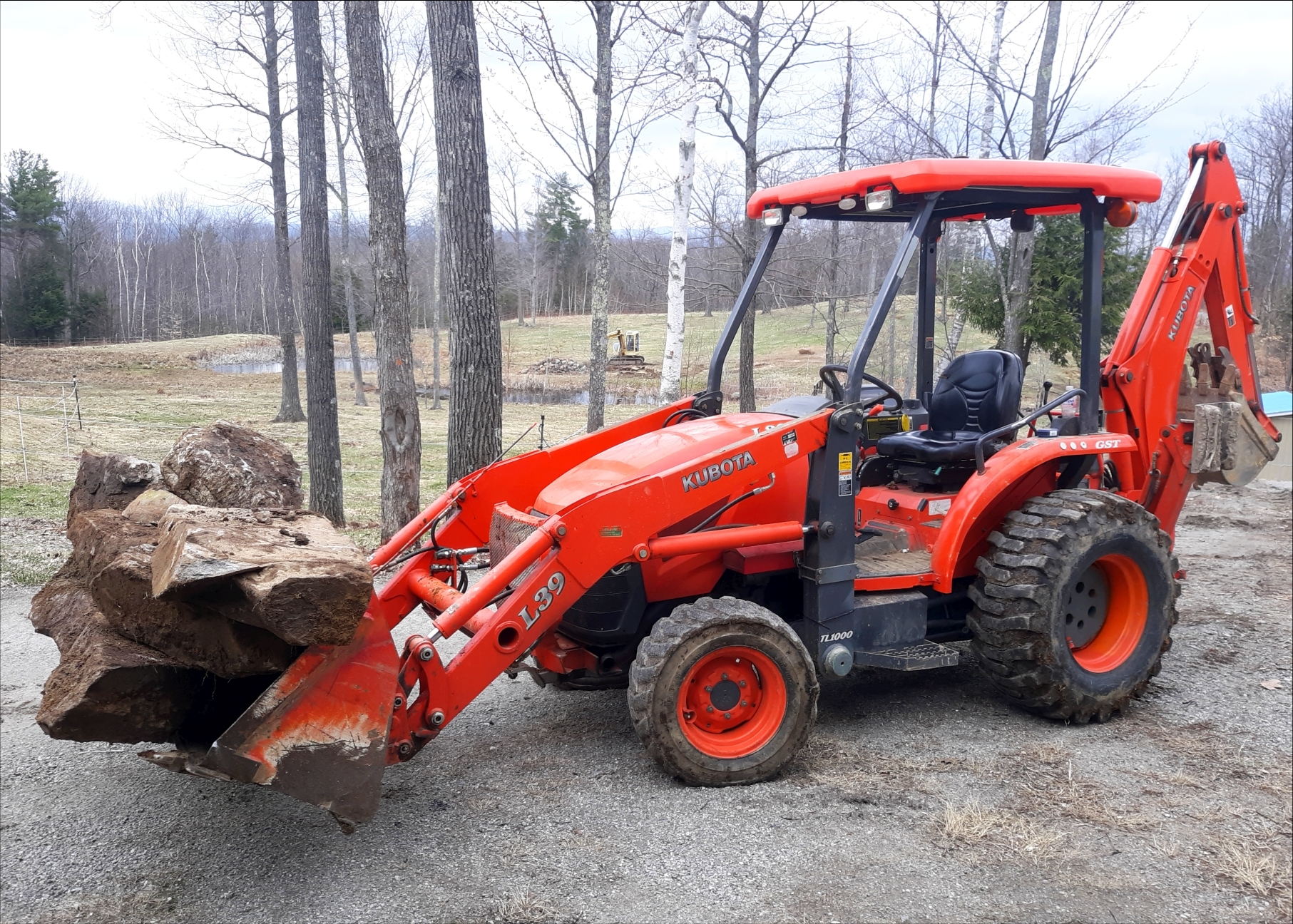

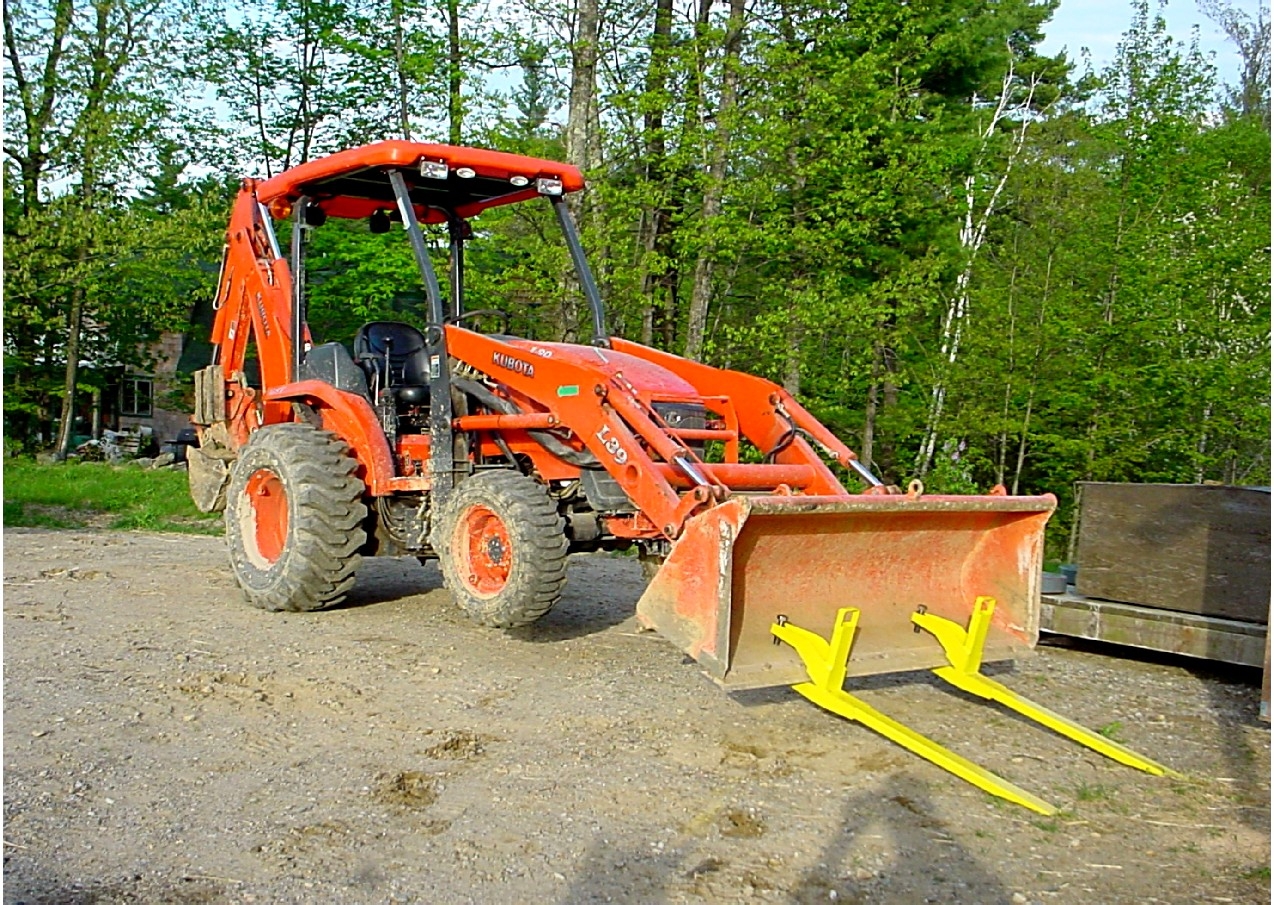

With bucket forks Tractor Ballasted to 8,200 Lbs, upsized Lift and Curl Cylinders by 5mm my L39 will lift 1800 Lb pallet. Think you can handle 2,000 Lbs with SSQA forks. I have no idea how much this weighed, but the forks were mounted to SSQA in this photo.
The ONLY thing you'll get with those clamp on forks lifting that kind of weight is a nice SMILE in the bottom of the bucket and probably stress the side sheets to the point where the welds will crack as as well.
/ Kubota L47 fork capacity #20
