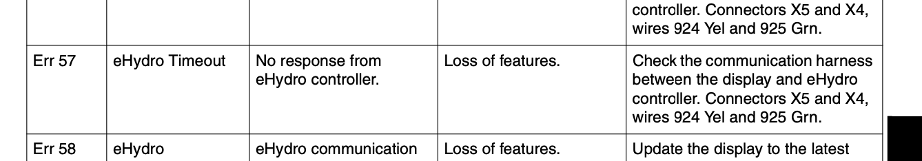

Bush hogging in tall brush on my food plots and ran over a hidden stump. Tractor stopped moving and a 57 code came up. pulled the tractor to the barn and went online. Most posts said Hydrostatic controller fault, check fuse, wiring and then control box. I didn't find any wires or plugs pulled ( there are a lot of them!) The control box seems to be underneath right behind the pedals. It looks like no damage. I called the 2 dealers near me. Neither could give me a guestimate on price. Since I can't get it on my trailer ( no winch) they want a bundle to come get it. I have had maintenance issues with both companies. They both like plug and pay style of fixing things and most of their mechanics work on gators, zero turns and garden tractors. Any ideas before I bite the bullet and send it to them. I had posted recently about replacing it as it is getting old and breaking more often ( this time it was my fault) but got sticker shock and was hoping to wait for covid supply chains to get back to normal and hopefully more sane prices. I did find a 2018 kubota m6060 for mid 30's that might be solution . Any help in checking the system or where the wiring or the module is would be appreciated

error code #57-

Ended up being a loose connector and a blown fuse. The fuse box has 2 30amp ,4 20 amp and 1 10 amp. Care to guess which one powers the hydrostatic transmission control module? That little 10amp. That could have been an expensive fuse. I have had that tractor since 2005 and that is the first transmission problem I have had.
