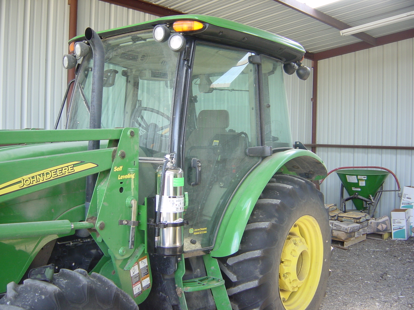

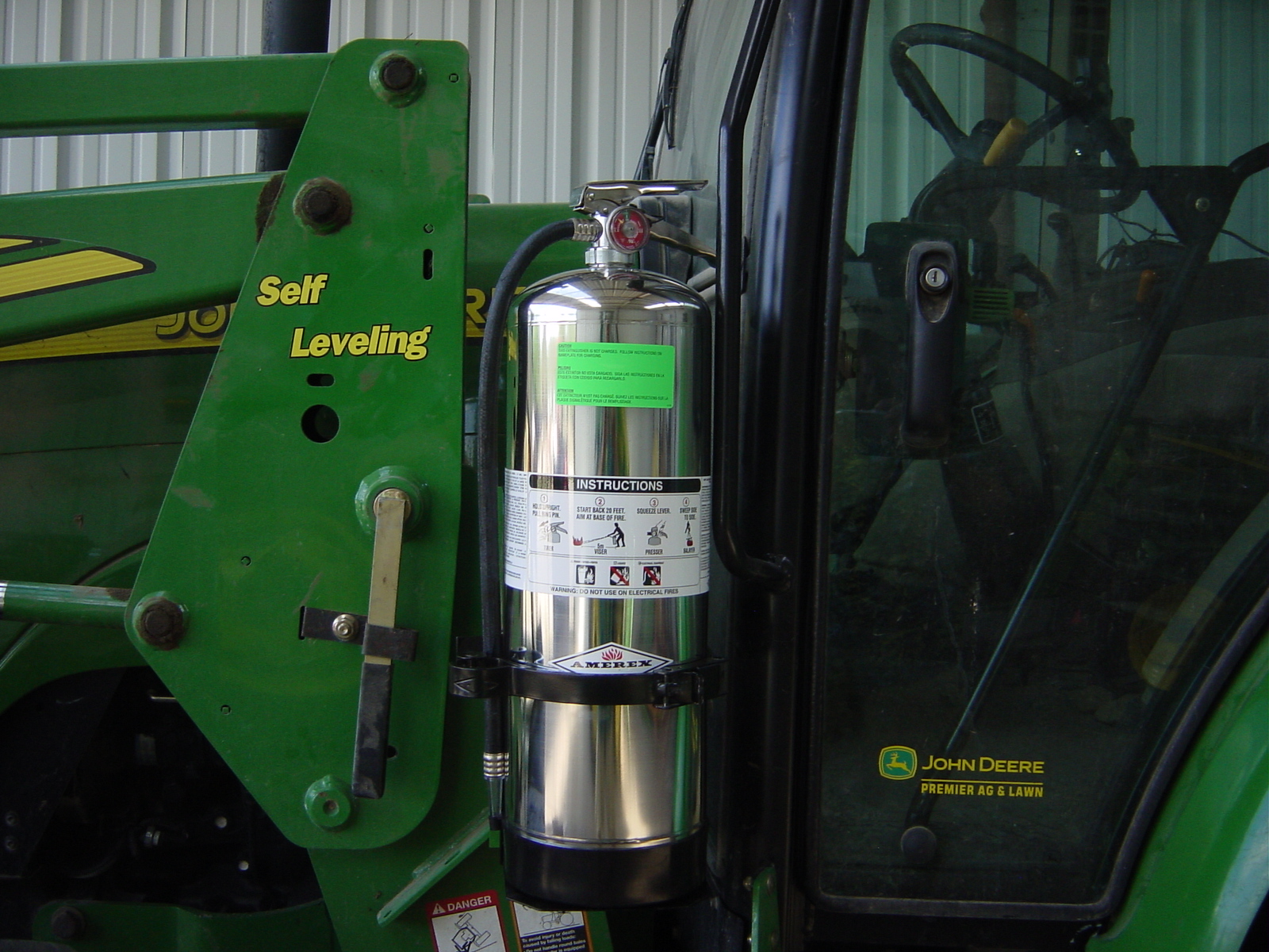

After one too many grass fires while cutting hay I decided I needed a good size fire extinguisher on my tractor that is easy to get to, etc. Here is what we came up with.

Thats big !
Same one as mounted on my baler and I have one on my welding trailer. Water and refillable - so, it should work. I have a smaller chemical one in the cab, but I hate to waste it on a grass fire since I can't refill it, etc.

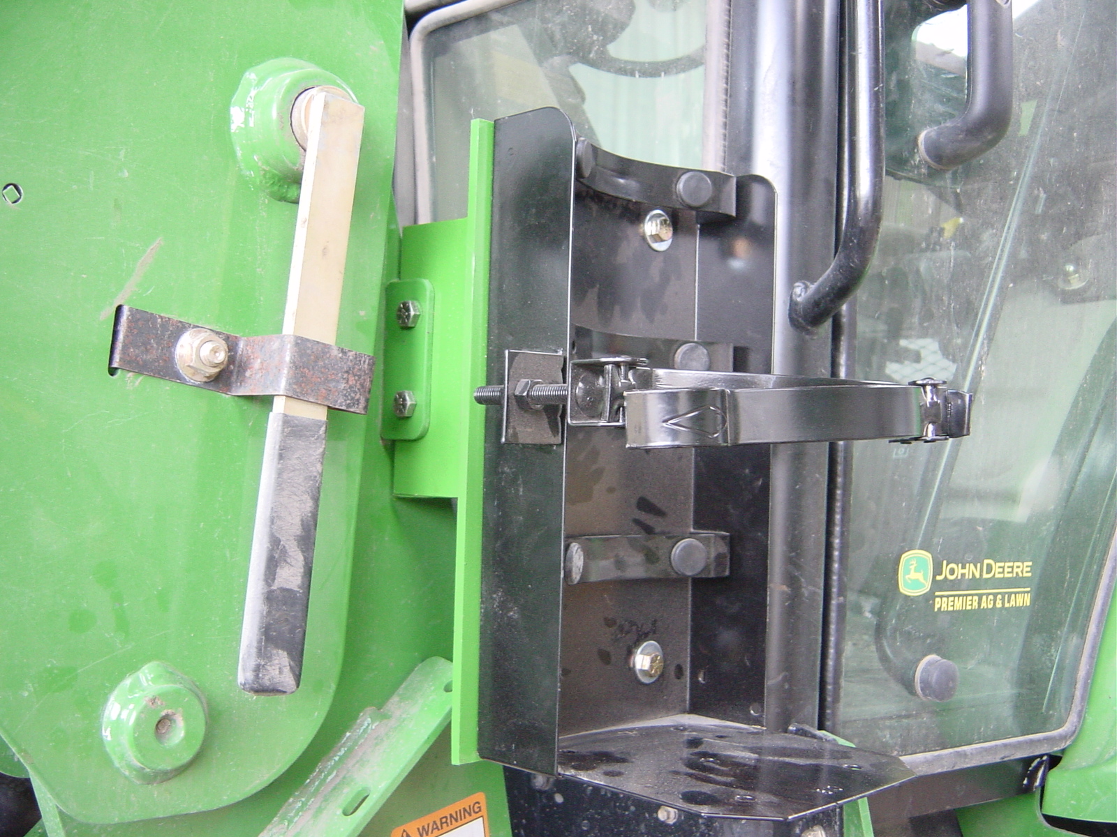

I like it. Did you build the bracket or buy it? If bought, where?
I need to mount one on my 5101 and would rather have it on a heavy duty bracket outside the cab like you have there rather than inside the cab.

I looked and could not find a good solution. So, a buddy of mine looked and it and the tabs on the loader brackets for the fenders and lights looked like a good spot.
A buddy of mine wanted one also. Maybe we need to crank out some extras. We painted this one, but we could get them powder coated.

Next time you refill it, try a "little" bit of dish detergent with the water. It allows the water to penetrate better and extinguish fire.

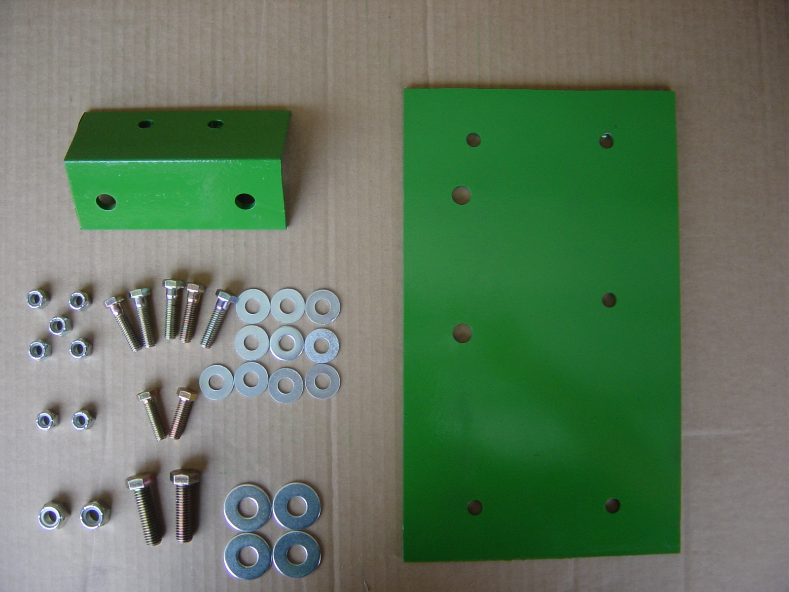

I bought the outside unit from my JD dealer. it is the same as they put on their balers.
We had to fabricate the mount. It bolts to one of the tabs on the front end loader.
D.

I had to make the mount, but they stock these fire extinguisher and and the holder. Same as you see on balers.
