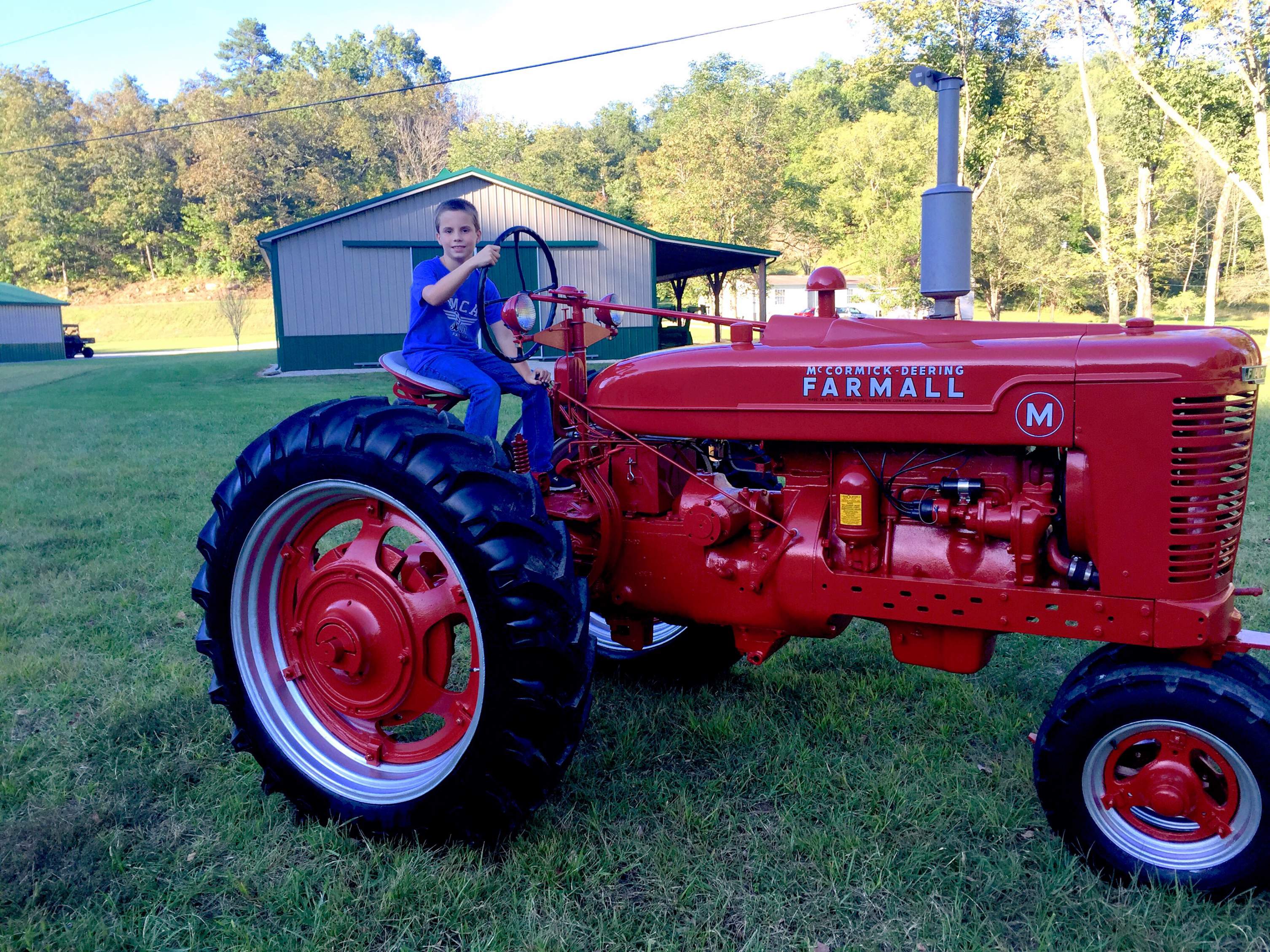

Thanks guys, not being stupid but how do you post pics on here? Do you have to use an image hosting site?

#33
image.jpg. Test

#34
Yeah im not completely ignorant:thumbsup: thats my son on my neighbors tractor I helped him restore, just finished it last week. Sorry to bring red paint in a JD forum. Just testing how it worked. I will post pics of new 5055e when it arrives and give you my impressions.
