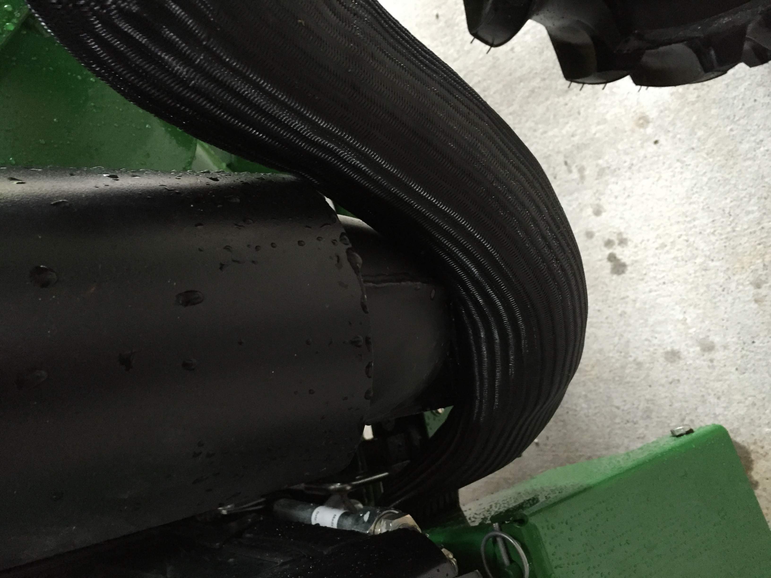

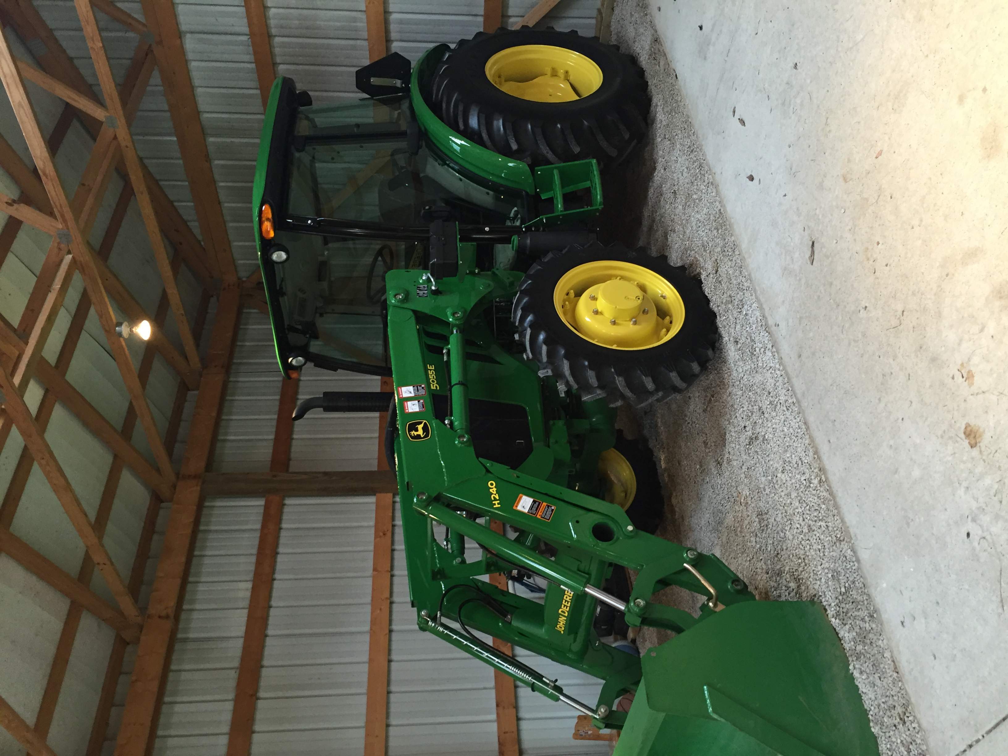

They delivered it Friday afternoon. Got it in the barn to inspect a little. Radio had no power, radio antennae was missing, loader hoses were tight against the exhaust stack, loader hose bracket was installed wrong and you couldnt even mount my loader on it. So...2 hours later I get the hose bracket fixed CORRECTLY, which also fixed the hose on the exhaust issue. Dealer came this morning, power wire had came undone on radio, quick fix. I just don't get the uncaring, incompetency nowadays. Not got any seat time yet due to this monsoon but I can tell you this engine is WAY quieter, service guy says its the new injector pumps which eliminates the injector knock? Still unsure on the regen/dpf but once I get some hours on it I will report back.

Very nice looking tractor.:thumbsup:
I like the tier4 engine. It quiet for sure and still puts out power. My tractor did a re-gen at 55 hours. It took 15 minutes and the engine went back to normal.

This is the loader hoses against the exhaust stack. That is what made me irate. Now Deere stepped in without argument and got me a new tractor, this is all on the dealer. Evidently they realize it because the manager is coming to work on it himself this evening. Im no rocket scientist but not an idiot either and that right there was just plain pathetic.

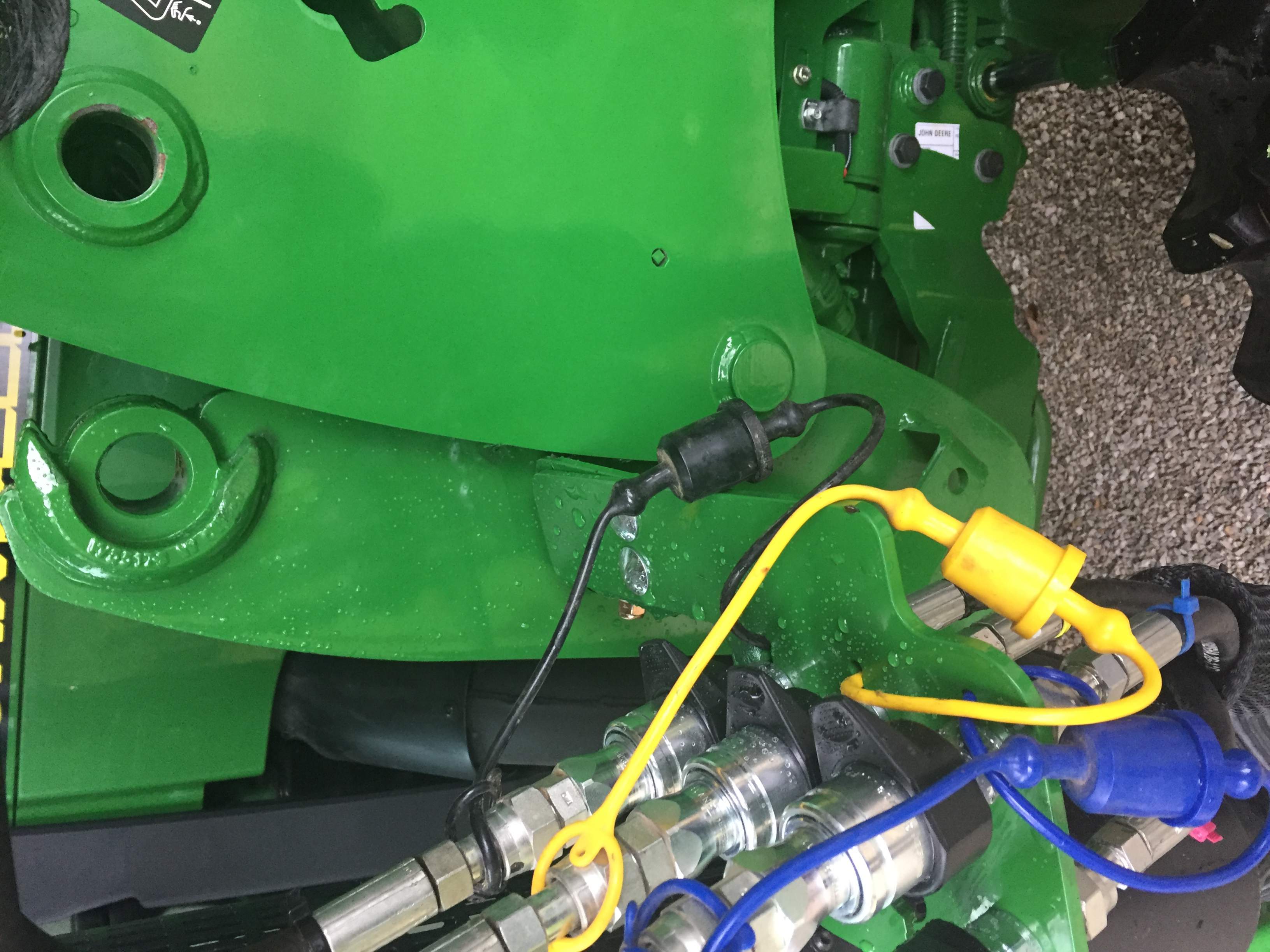

Then i try to mount my loader and this happens...however I spent 5 minutes to remedy both issues myself. We shall see what the antifreeze leak turns out to be...
