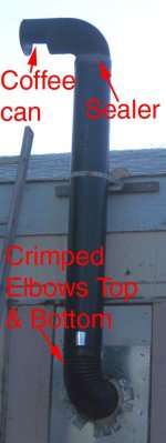

Just got my wood stove pipe replaced. Old pipe was a thin cheep one and only lasted 2 years.

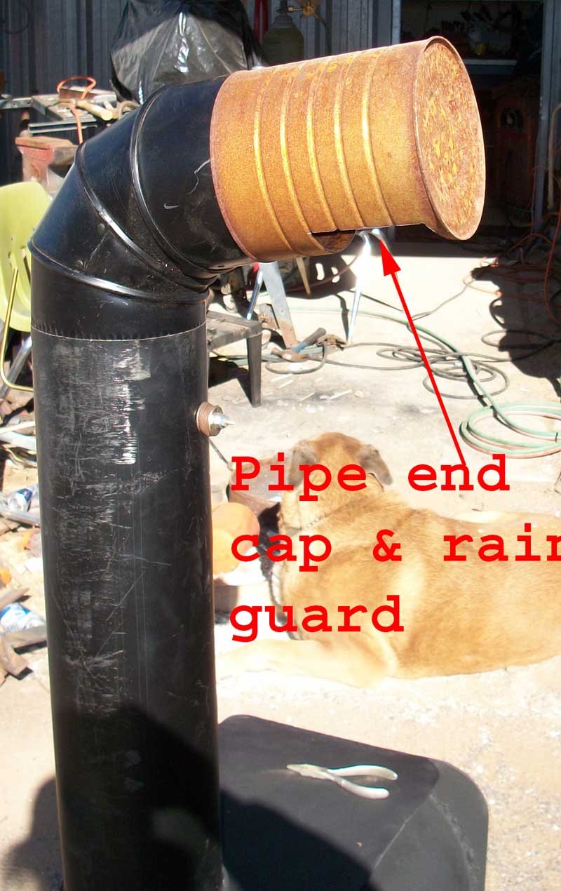

New $5 pipe (Found it at Habitat for Humanity) is real thick & heavy, with a tight fully crimped seam. Just one step below the porcelain coated pipe. Used crimped elbows as they are almost as thick as the pipe. The Coffee can topper works better than the commercial rain hats & lasts about 2 years. This is the 3rd one that I have made and the first one painted. Maybe the paint will make it last a little longer.:)
Fitting it together and putting it up was one of the few things that has gone smoothly lately. :thumbsup::thumbsup::thumbsup:
Could not do all that and not build a fire. No it was not needed, just had to test the pipe. :laughing: Da!!! it works. :thumbsup:
So on the cool mornings coming us now I can have a little fire. Am ready for the actual cold that is coming.

Crash,
always good to use the heaviest guage stove pipe and elbows (non-galvanized), it comes in different guages at the wholesale level, some stores don't carry the good stuff, find the supply co's if not.......
cheap stuff is probably 28 guage......IIRC good stuff is 18 or 20 guage.....heavier is definetly better....:thumbsup:

Didn't measure the guage, but its in the 20 range. Maybe high teens.

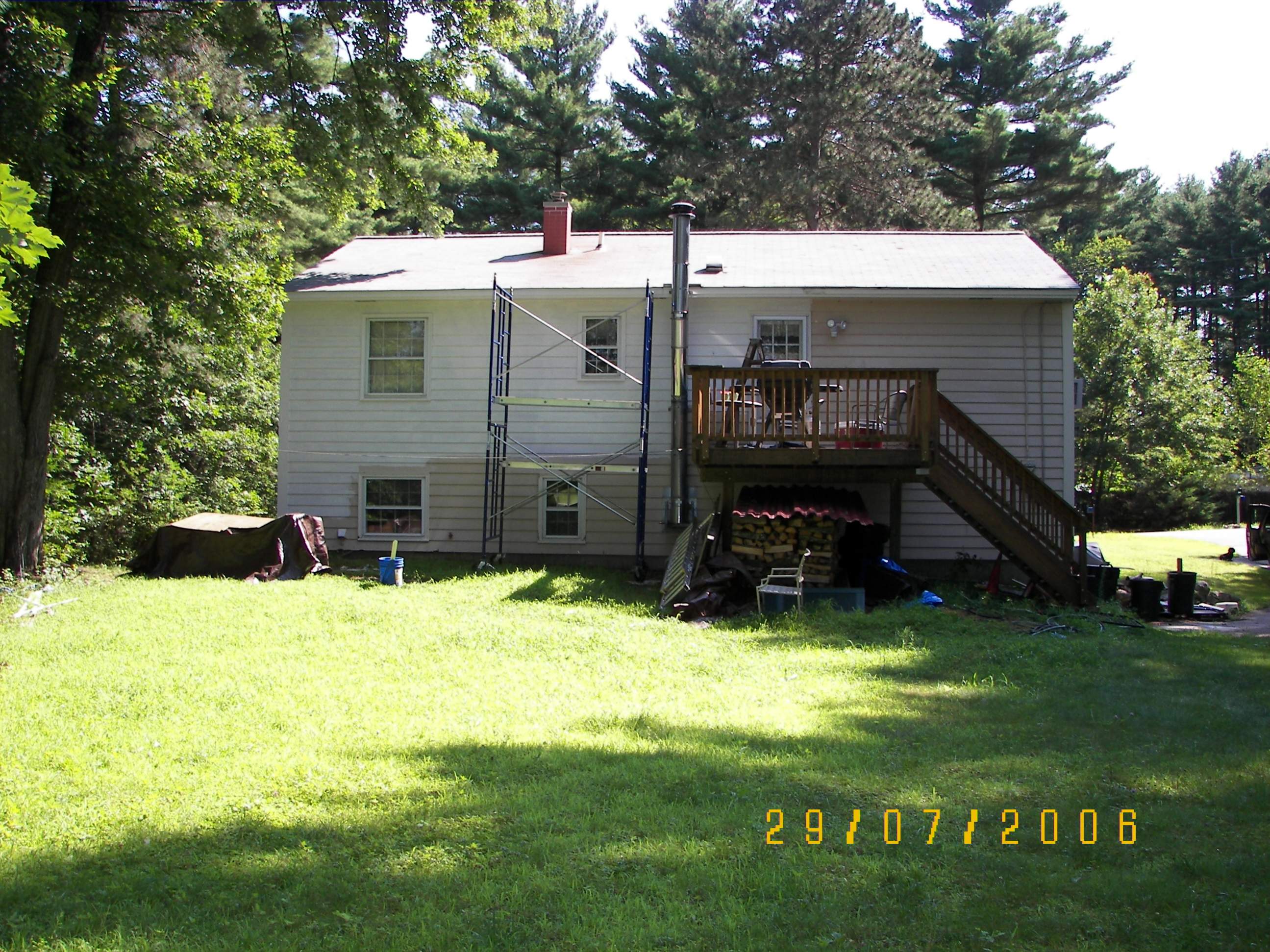

Your pipe looks good but around here the FD wouldn't approve on that type of pipe outside......I have stainless insulated pipe on the outside and the same stuff has been up since 1984.......

The stainless stuff I have is Metalbestos All-Fuel Chimney 10"ID.......BIG $$$$
But it lasts.....when I put mine up in 1984 I had some used stuff and bought some more new to match......(the old stuff was at least 10 yrs older)
I never intended for it to last as I was going to just add a cement block chimney when it crapped out, but it still stands and no trouble, why take it down...:D

We have single wall pipe up to to the double wall that has lasted from 1980 to date. As far as the tin can you can put over the opening to keep unwanted animals out.

A coffee can cap held up for 4 years on my outside stove and it was just left to rust, no paint. I will put a piece of rabbit wire over the opening to keep the birds out. Cut out is larger than the can pictured.
