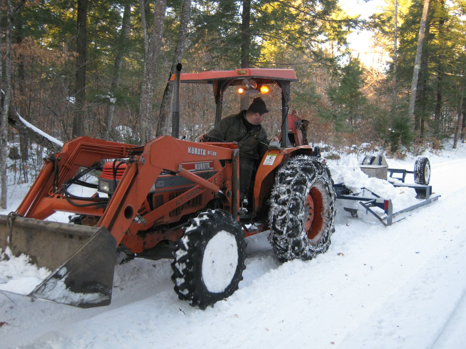

i was curious.... i had asked more then 1 dealer now about putting chains on the front of a 4wd tractor.. both dealers told me the same thing.. it was BAD for the tractor to hae chains on the front.. somethign about the front wheels not being designed for that.. idk..
has anybody else been told the same??
Yes I have. I was told the fronts over drive ( or try to travel faster than ) the rears in 4WD by 2% to 5%. So it is best to let them slip so the difference in rotational speed won't put lots of stress in the drive chain.

The main service guy at my Kubota dealership told me that when in 4WD the front over drives the rear by 2% to 5% depending on tires and inflation. He said if I chain up the rear don't put chains on the front, let them slip.
The 4-wheel-chain concern is understood, and I do see their point due to differing wheel speeds, however I just don't believe it. There is no way that chained tires on snow/ice generate more traction then tires do on grass, dirt, or gravel. If the drive train isn't ruined during normal 4x4 operation, I don't buy that running 4 chains will create greater drive train strain. Hey, I'm a poet and don't even knowit.

Unfortunately I think the dealers are being very general in their statement. Very likely they don't want to give the precise area of concern, which is turning with a 4x4 vehicle, in fear the customer will forget the details and blame them later. Except for true "all wheel" drive vehicle most 4x4 trucks and tractors can not compensate for the changes in axle rotation speed between the front and rear axles when cornering. I have seen this so many times were someone new to a 4x4 vehicle drive from a snowy street in to a dry parking area like a parking garage. You can hear the drive train binding up and see the driver fighting with the steering wheel to make the vehicle turn.
A properly design 4x4 drive train will have no speed different between the front and rear axles when going straight, and any micro speed different (like 0.01 %) will be compensate in tire flex. You can drive all day on pavement in 4x4 as long as you go straight, but cornering is a different issue and when the damage normally occurs. I really think the chains on the front tire statement is more of a CYA, since the dealer can not predict how you will operate the tractor.

Possibly he is sure, but he is wrong about that part. For normal proper setup of a 4wd the fronts lead a few % -- they are always scratching a little bit when going straight. This makes for good handling and responsive steering since the fronts pull in the direction turned for gradual turns and as turning sharpens they come to a neutral condition where all tires are pulling evenly ... sharper still and the backs start pushing the fronts and thats not as good for steering. If the ratio starts out neutral at straight the pushing starts immediately as you turn ... not as good.

Most dealers who opine on this topic speak from the experience of profiting from their customer's misfortune. The precise "area of concern" is shock loading caused by front and rear wheels spinning and a front chain cross-chain grabbing a frozen, fixed object and shocking the front axle driveline which typically CAN shell the bolts holding the front ring gear to the differential carrier, snap the front pinion shaft, or if one is lucky, split the front driveshaft coupler. Will this type of damage happen to every user of front-only chains? No. But it does happen. It's all about how lucky one feels and how impressed one is with his or her operating skills. And as I stated in a different thread on this topic, tractor brand is immaterial.
You would be wrong in making that statement. Almost all MFD axles lead by 1-5% and a very few lag by the same percentage range.

Thanks for the informed replies. The idea that shock loading on the front drive train is the big problem rather than unavoidable "windup" makes alot of sense.

I dont know if it is good or bad, but you asked, I ran chains on all 4 wheels all year long for 8 years and 202 hours on my B7500 doing mostly loader work and a little mowing. We have really steep hills here. I had not trouble with the front end, or any leaks. The tires were not loaded. I took them off the day the new tractor arrived, no excessive tire wear. I am not reccomending this, I am just telling you what I did.

With the snow and ice we have had I have chains on both front and rear. I have field chains on the back and 2 link truck chains on the front. I would not run chains on the front only. I would think it would stress the front diff. Really don't have any thing other than gut instinct to base this on though.
