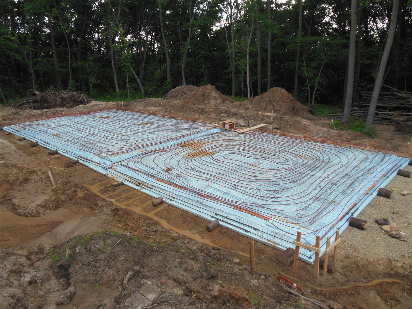

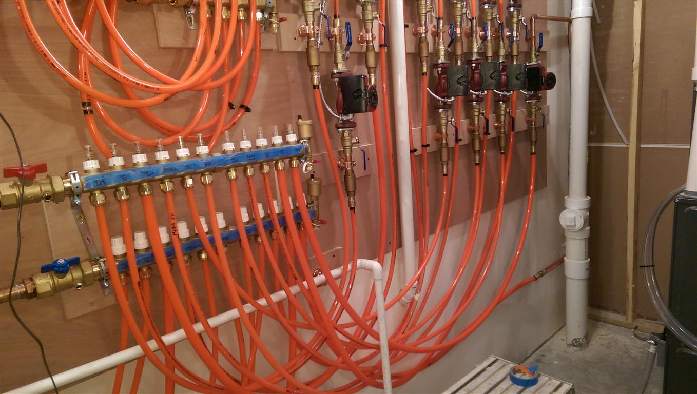

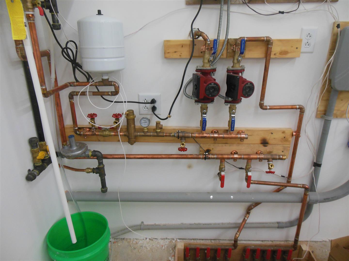

Some photos of my shop setup. 2 zones - 5 loops on one side, 4 on the other, ~2600 sf total. The shop is 32x80 with the 2 zones split about 32/48 on the length:
The house is zoned pretty much by room. I lost 2 zones during construction, which was very annoying. One was me being stupid and I screwed into a tube after it was VERY inaccessible. the other one i have no idea what went wrong, but it would not hold air pressure after i got it all together. I think there are now 12 functioning zones in the house. I put down 2x sleepers on the main level and poured 1.5" concrete over the tubing, then an additional layer of subfloor over that

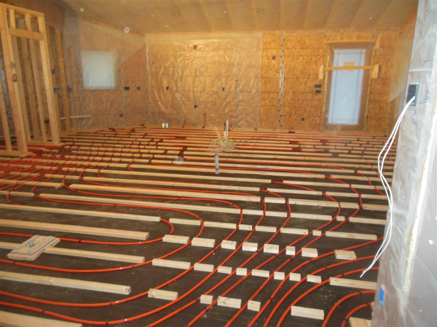

Main floor tubing:
