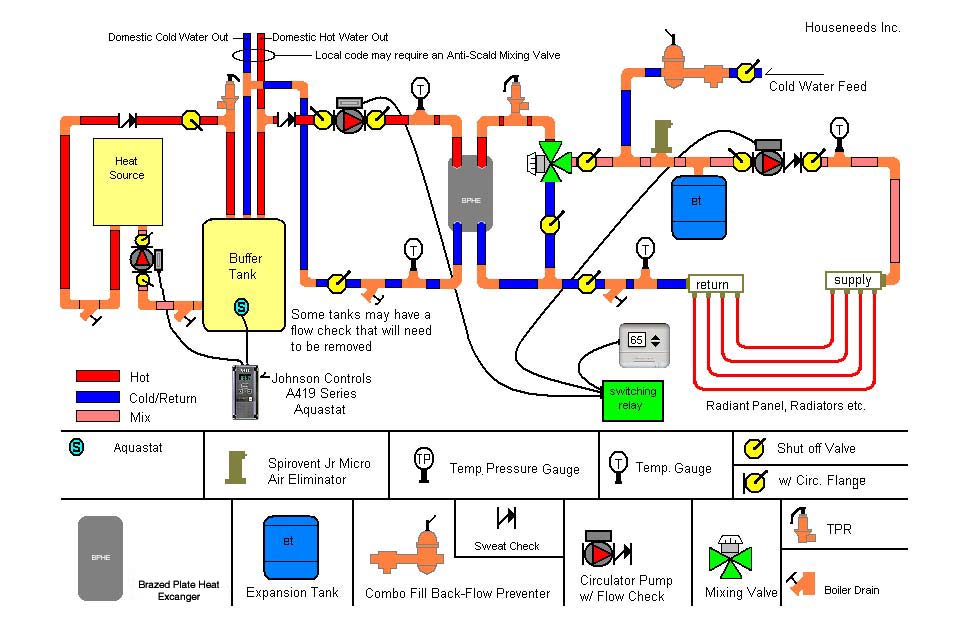

The above is the more correct system other things will work. There is however trade offs. They do not show flow control on floor loops. If you do not have antifreeze in your floor you could delete the exchanger.
How would this design apply to my setup since I'm only providing radiant heat, no domestic use? Which parts of that would be unnecessary?
   / 48x39x14 shop build #256
A lot because you are not using anti freeze in your system. Only other question I would have is does your boiler require a guaranteed flow. Provide make and model on the boiler and we will look up.

Truckdiag - The system you show is very complex and covers both DWH and radiant in a combined system and pretty clearly uses a boiler. Thus the need for the heat exchanger for that whole set of radiant loops. I didn't want to mess with that so I separated DHW from radiant. I have not dealt with boilers directly, but my understanding is that boilers heat the water to very high temps (they gotta call them BOILERS for a reason, no?) and thus require mixing valves to temper the loop water with return water so you aren't sending 180+ deg water to the floors. One of the things that makes using a tankless (or even a regular tank HW heater) work nicely for radiant, is this reduction in complexity. You don't need mixers or other complexity as you can supply more moderate temp water directly. And you don't need additional controls as the tankless lights up when it sees flow (a zone kicks on) or a tank heater lights up when the thermostat says the water temp is low enough to need heat. 120F is not that hot. It violates some radiant engineering rule as I know they like the outgoing and returning water temps to be only like 20 deg different, but it still works. Again that holy war issue...
The exchanger is there because you do not want the gycol going through a tankless boiler or any boiler for that matter. Once again your system working proves that it will work without. You have stated that hard water is the route to all evil in a tankless boiler system. We are saying gycol coming in direct contact with the heat exchanger in the tankless boiler may very well play a bigger roll in tankless boiler failures. He(son) seems to think that the direct contact is causing the gycol to break down. That has been my sons experience and he has replaced a lot and re-piped and installed the exchangers. The buffer tank he did not want to explain or maybe couldn't all I got was a 40 gal electric hot water heater is cheap, why not use it.... I'm not convinced you need it with a tankless boiler and I will not be using one in the barn addition.
