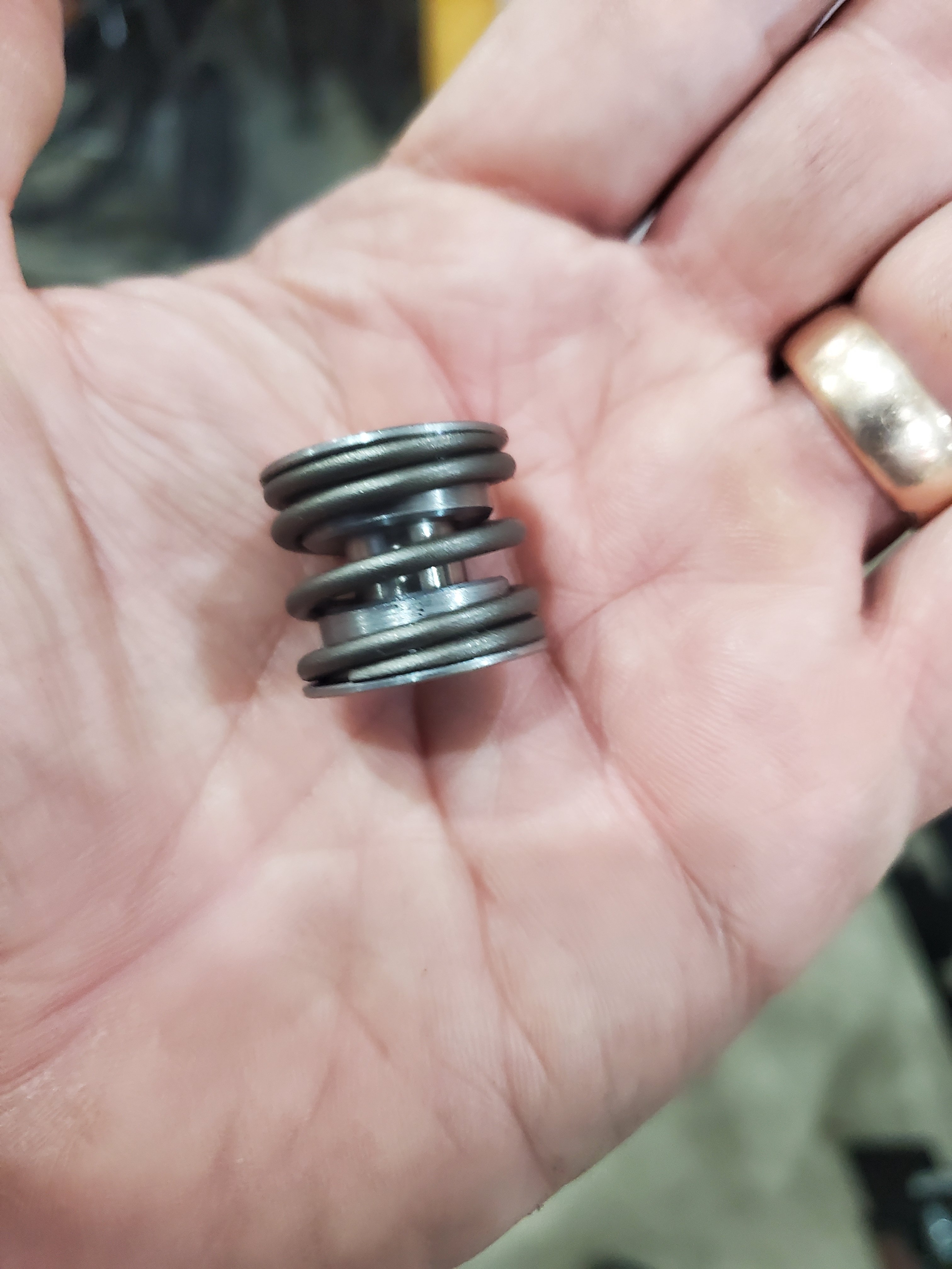

Here is a couple pictures of my valve, and a picture of the part I need.

When I remove the detent kit, there is nothing to maintain the lever position. The lever essentially flops around. I'd like it to spring back to center.
/ 4820c rear remote #11
That's for a "float" position. The valve should work normally if you don't push the lever into the float position. You should feel some resistance before it goes into the float position. To defeat it, just remove the ball and leave the spring. You paid extra for that "feature".
