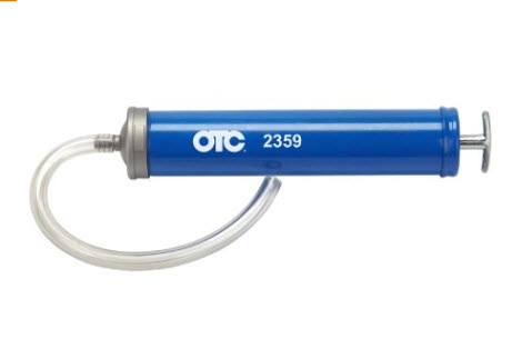

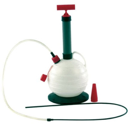

No problem. It happens all the time. Best solution is to use an oil sucker to draw out the excess oil. Quick and mess free.
If the fill hole is large you can use one of the small cylinder type. Otherwise one with a long thin hose should work.

Follow up guys- borrowed a plunger type sucker and gave up on that as being too slow. then disconnected line at the small in line screen-messy and I got two teaspoons out. finally woke up. Unscrewed one of the third valve drybreaks that sit on end of loader arm, hung a bucket, started machine and controlled discharge with third valve lever.
