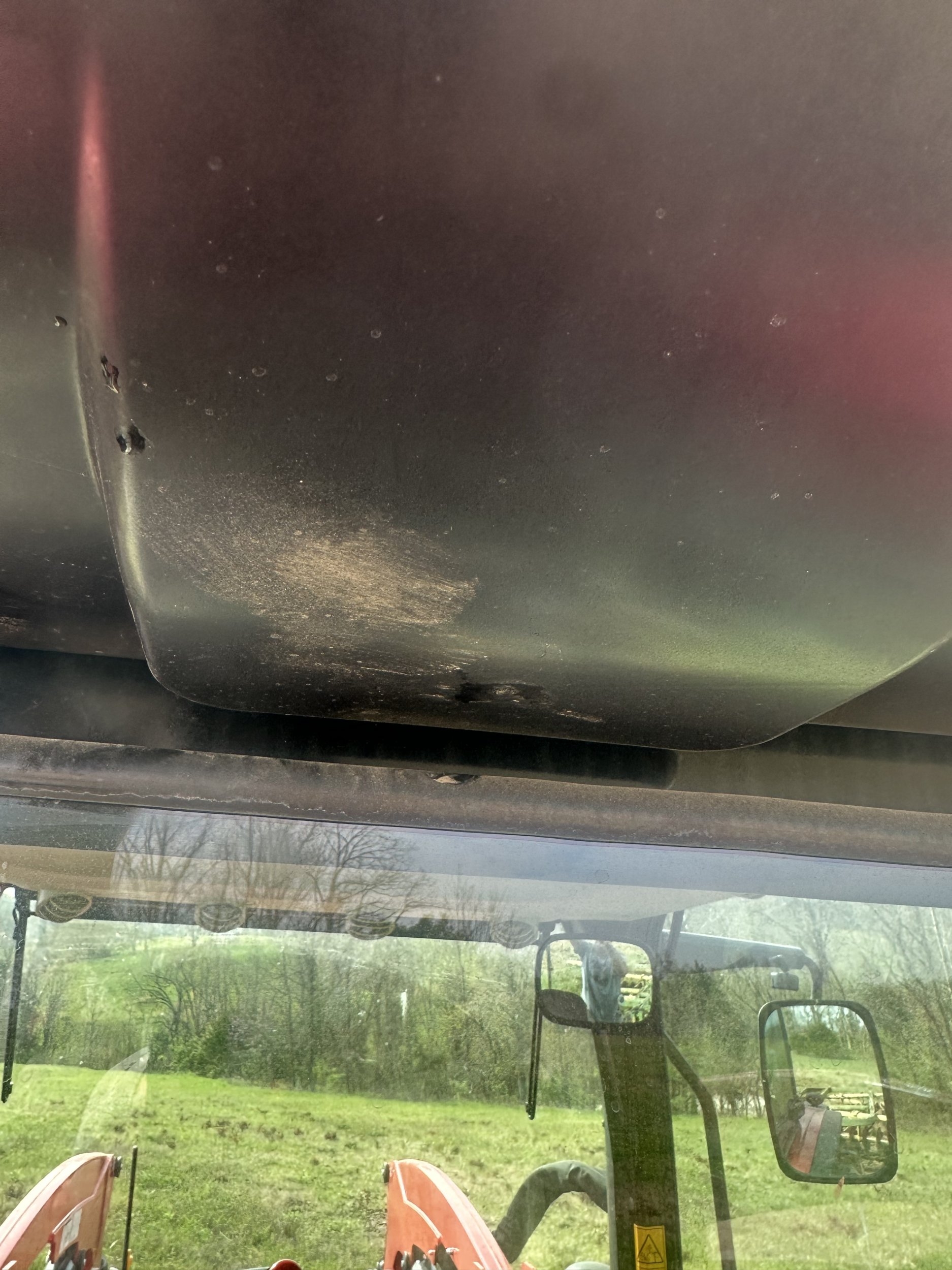

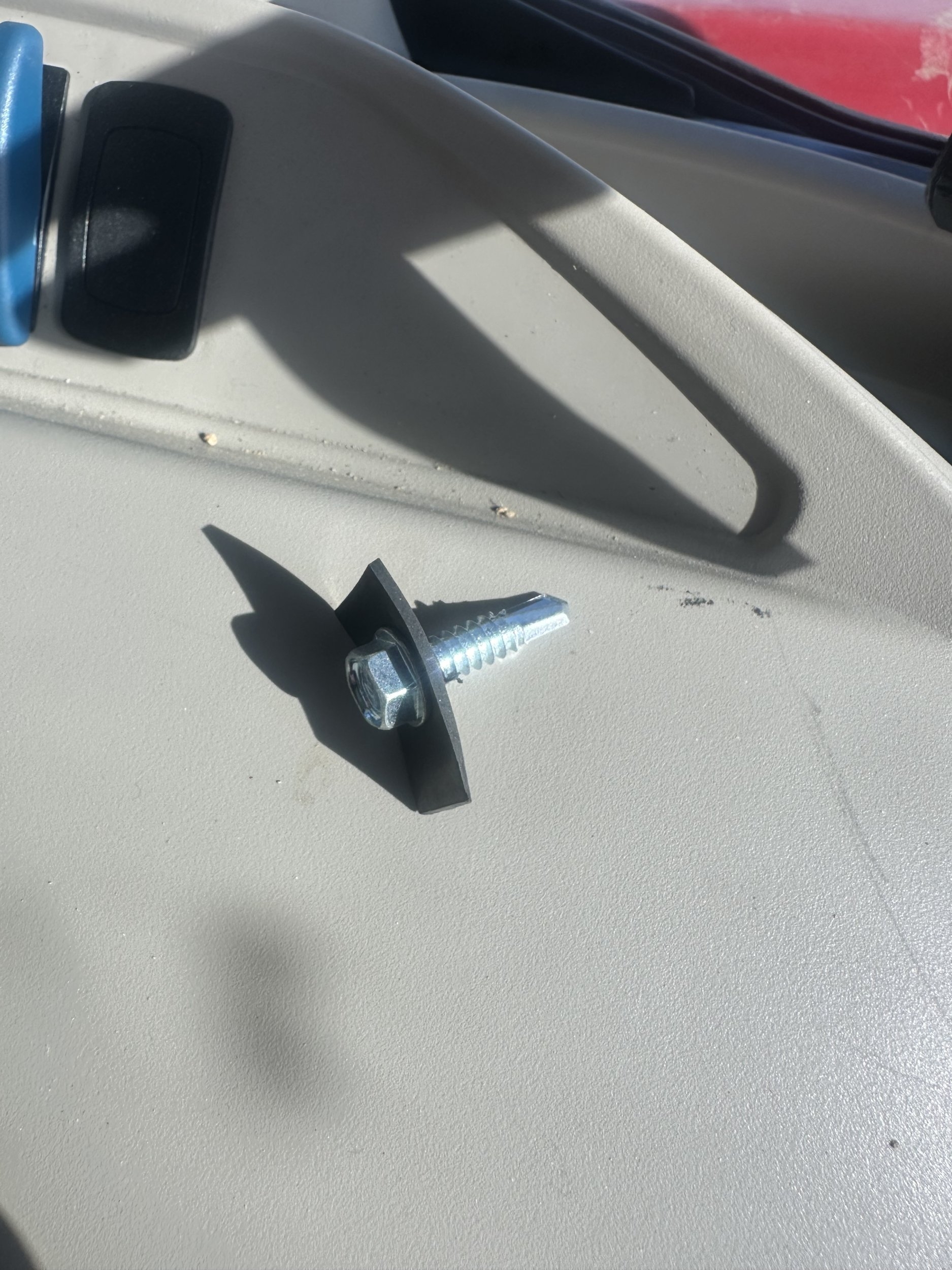

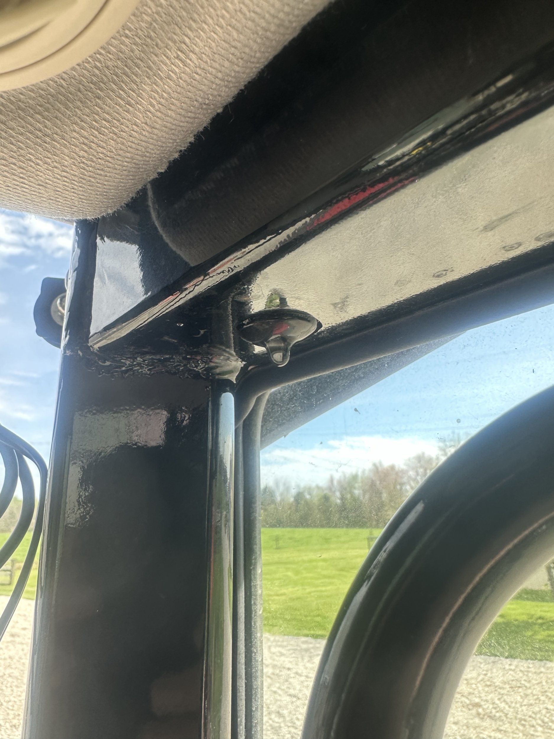

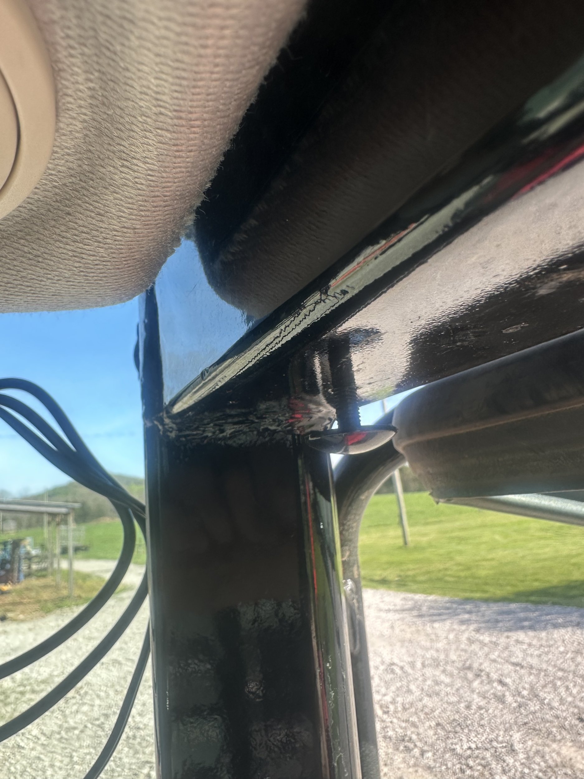

Eddie did they get the ac leak fixed? My 5711 is dripping too. I think it’s the ac lines condensation inside the frame. I’m going to temporarily fix it with screws and rubber washers. Don’t want to permanently fix it til I know how much water there is. There is also a hole in the bottom of ac pan outside above back window that drips on to window. I’m also going to re-run the fender drain so it doesn’t drip on my def pump and keep it a mess.
2022 is when Massey came out with the new AC system that solved all the issues from the earlier versions. From what I've read, the AC didn't work very good before then. Mine works great!!!
I have a tube that comes out the back of my roof that water runs out of when the AC is on. It's a lot of water, and it's pretty much, non stop.
I haven't experienced what you're dealing with. Have you joined the Facebook Group "Massey Ferguson 4700 Global Tractors"? There are several Dealers that follow it and give advice on how to fix things. Most of the time it's a Code that shows up on the screen, but other times, it's something pretty interesting.
I wasn’t a facebook member but joined to try and join that group. Ac does work good and pretty sure we have the same unit. Yesterday at about 84f I was reading mid to low 30’s with the occasional 25f which is probably right before compressor is kicked off. This is with a Milwaukee ir temp gun. This is why I’m rerouting the main ac drain, when working dirt it keeps mud caked on the axle and def pump.
Eddie, thankfully my earlier 4707 had zero a/c problems and in hot sticky NC summers only had to go to second fan position.
you sure don't want water leaks where you can't see them. That isn't going to end well.
often issue is just chaff/dirt/bugs clogging up a drain hole, happens in rv's too.
I bet the a/c systems work fine in a perfectly clean world.
