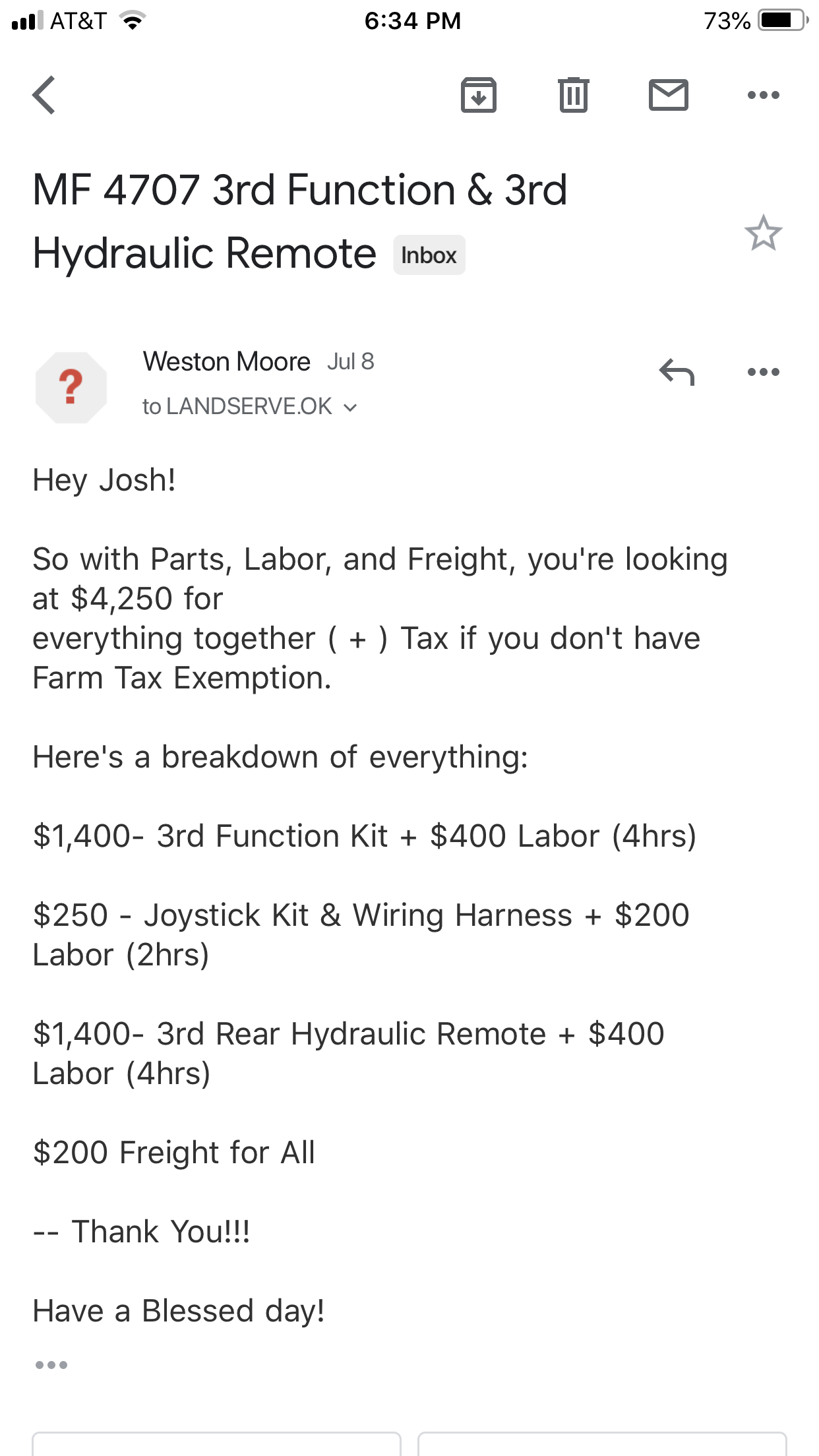

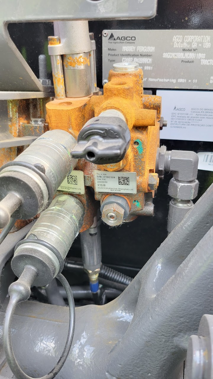

Anyone know whats going on with this 3rd remote? It looks like they took it off another tractor used rather than install a new one. The handle inside also looks like its from a different model
View attachment 749065View attachment 749066
Whilst I don't have one on my tractor, I poked around on Tractorhouse for a few ones listed with 3rd valves and they don't look that bad or have those Husco hydraulics stickers on them. If it were me, I'd definitely bring it up with the dealer. Wondering if they are having trouble sourcing original parts from the factory and are using alternatives perhaps?
Either way, for the cost of these tractors, I would bring it up.
Here is one I found on Tractorhouse - doesn't look anywhere close to yours in terms of the rust or stickers:
Husco is the brand of the valves that Massey Ferguson uses on these tractors. They also use that brand on the 2600H series as well. That picture is a tractor that most likely had a factory installed 3rd remote so it was painted at the factory.
Ahh that makes sense! I wonder why Husco doesn't at least have a basic protective layer of paint on them from their factory?
That is a good question. If memory serves the few valves and valve components I've purchased from them have been painted black in years past.
