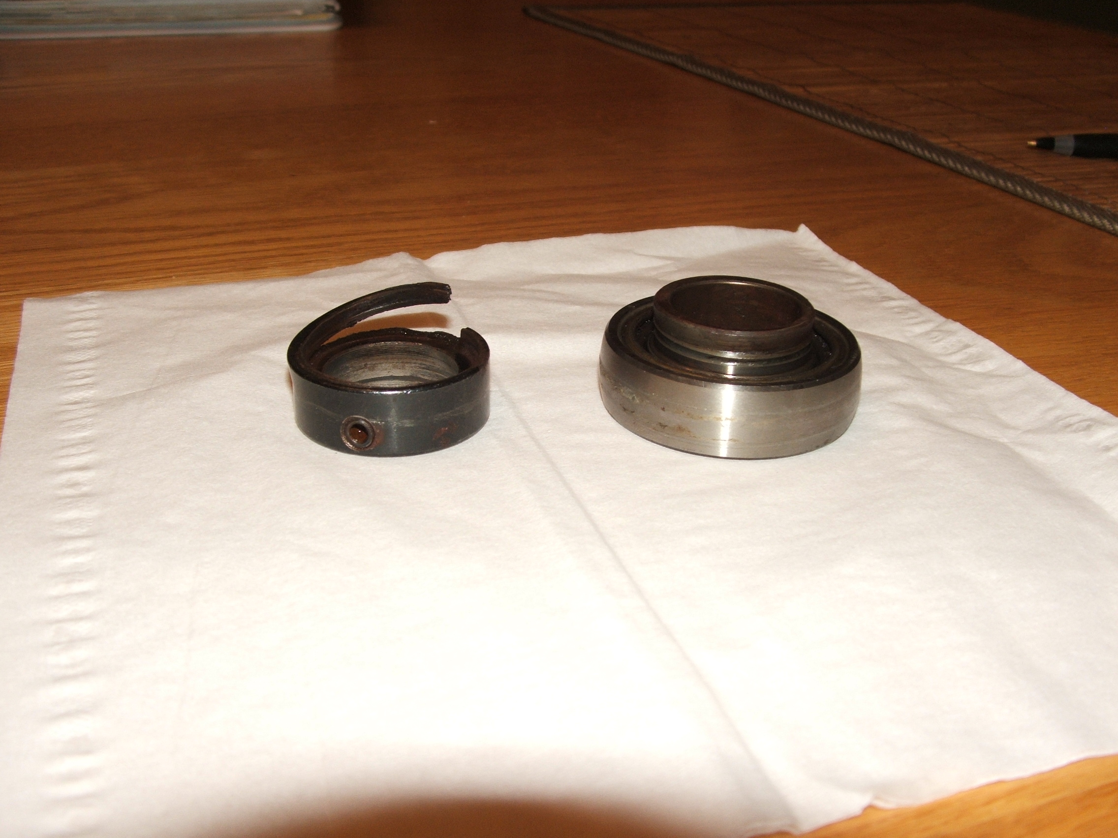

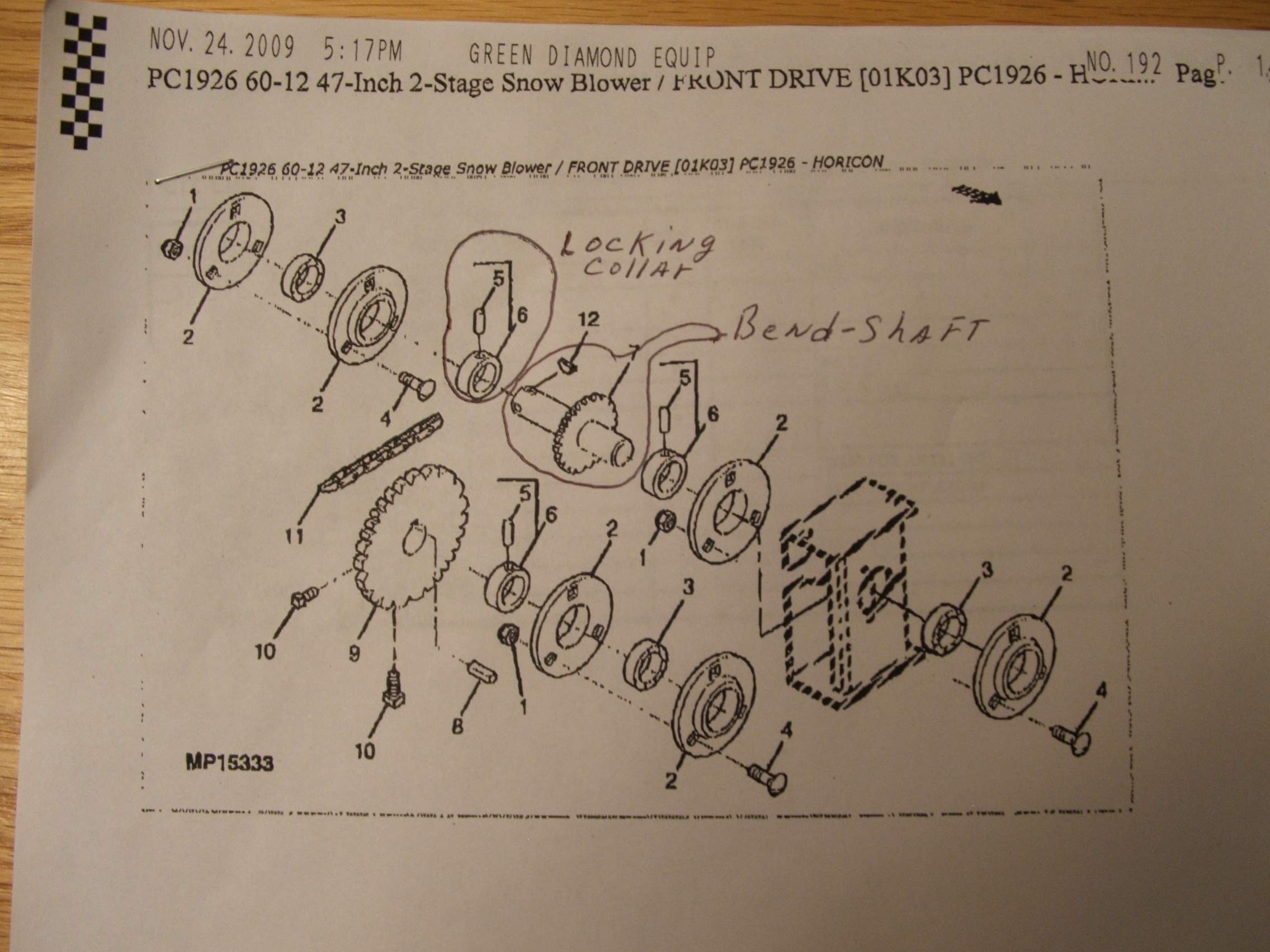

Well, I'm back from the dealer with good news and bad news. The good news is, the broken collar was not cause by a flaws in the design of the blower, ''which I am not surprise since these blowers have been around for a while''. The bad news is ''not that you would really care'' I'm back home without my snowblower.:( The culprit for the broken collar is a bend shaft, the one for the small sprocket. Had to be a defect from the mf cause it is almost impossible to bend it without doing serious damage to the blower. So now I have to wait for the shaft to arrive next week. Hopefully, the retrofit for the pto drive-shaft will have arrived also. It is due for next Friday. I will put pictures as soon as I receive it. Also a quick explanation on how to install the locking collar for peoples like myself that never had to deal with those before:eek: as it was explained to me. The collar actually twist ''screw'' on the bearing. If it is loose, you have to twist it as tight as possible on the end of the bearing, and then using locktite,tight the set screw to lock it in place. Simple, but like I said, I never had to deal with one before. If I missed anything, please, fill in the blanks.:)
More good news... Sounds like a warrenty issue.
