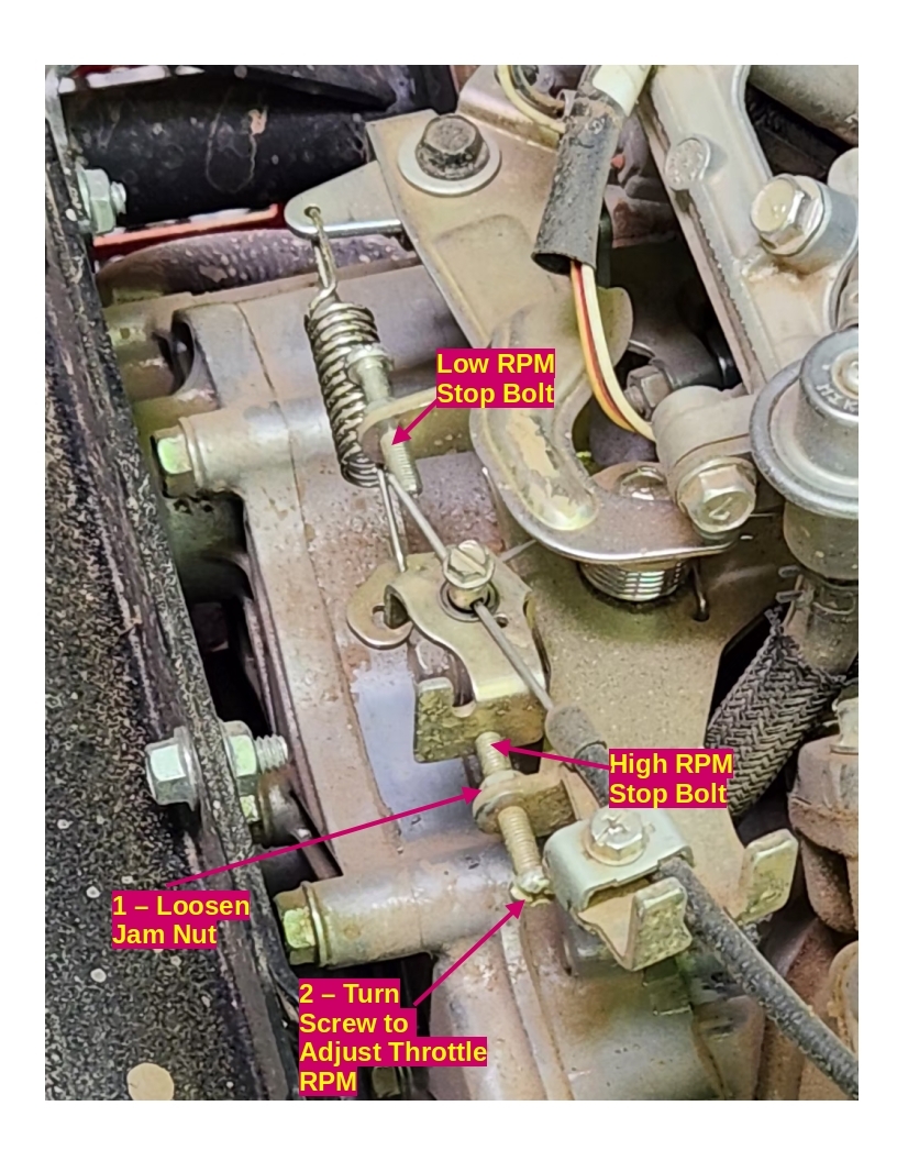

I’m new here so forgive me with 8 hours on my machine. Ventrac states that the low and high speeds are 5/10 mph. With ideal conditions, meaning no attachments, full throttle, going down hill I “might” be able to get 4 and 8 mph on low and high. My dealer says that’s normal.
What do you guys think? Maybe I’m having buyers remorse and not shelling out for the N, just feels slow as hell going 3 mph mowing in low range on flat ground. Are my expectations too high?

What RPM do you get at wide open throttle?
Mine is about 3400 with red line on the gauge at 3500.
/ 4520P Slower than advertised?
Full throttle is only 3000 rpm
/ 4520P Slower than advertised? #7
Yes that is too slow.
Your manual states on page 75 that operation range (RPM) should be 1,550 - 3,650.
A simple throttle adjustment is all that is needed.

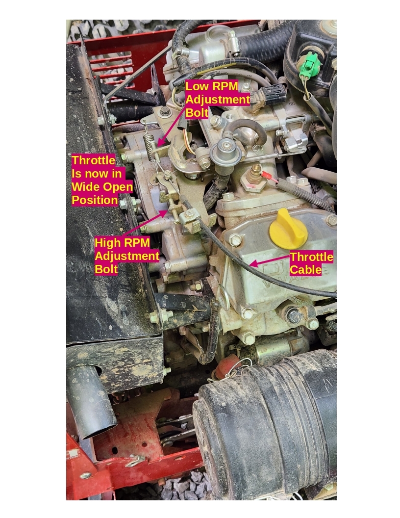

This about sums it up.
Keep an eye on the RPM gauge and don't red line it. Personally, I'd limit it to 3,500 to give myself a safety factor.
Snug up the jam nut when you are done.

Thank you for sharing! I dropped this off Saturday with my dealer before you posted Sunday. Works as advertised now! Little miffed I had to pay my dealer a $60 diagnostic fee on a $30k brand new machine but hey works great now
